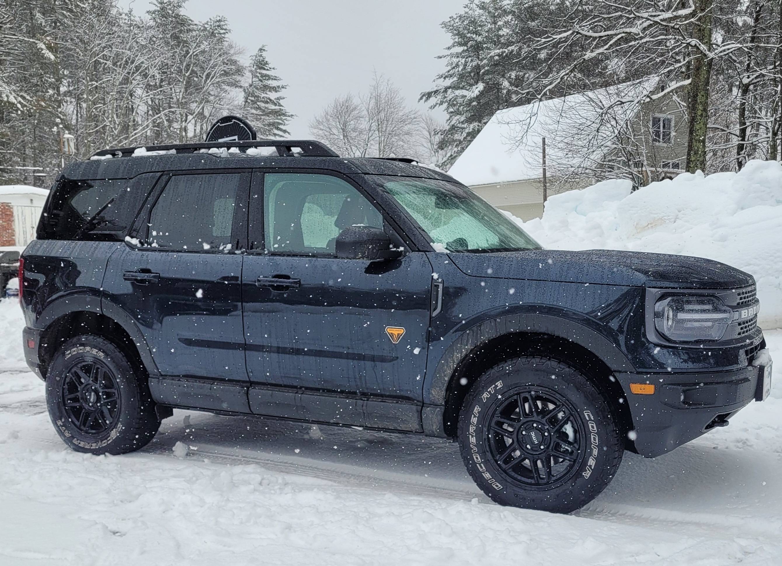

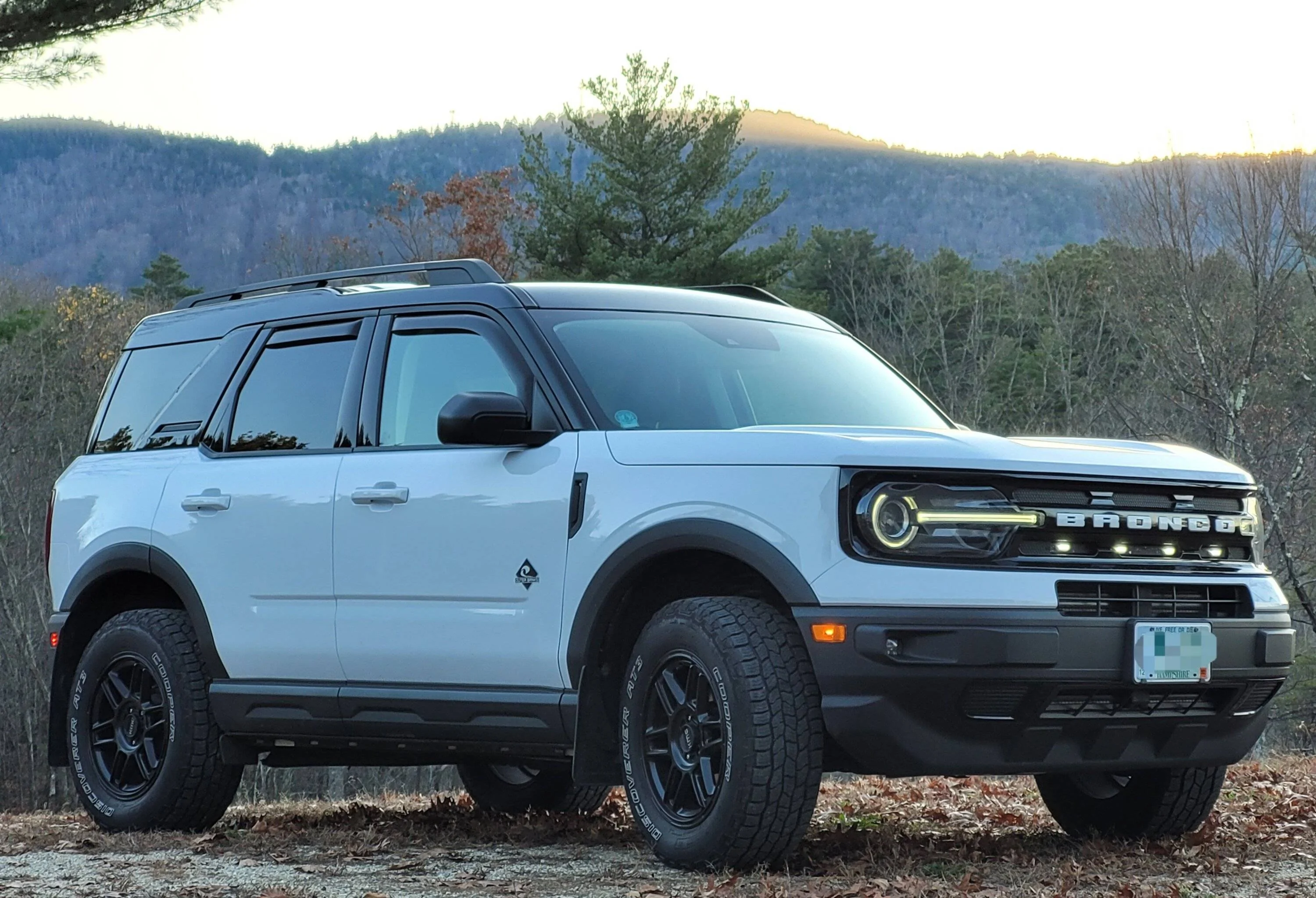

A lift doesn't affect what tire size you can run. It's all about the width of the wheel well.
You can run 245/65 or 235/70's with no rubbing at full lock. After that you would need to trim or deal with the rubbing.
There are some running 255/75's by trimming the pinch weld on the fire wall.
This is my old OB with a 1.5 " lift and Cooper 245/65's

This is my BL with the same wheels.

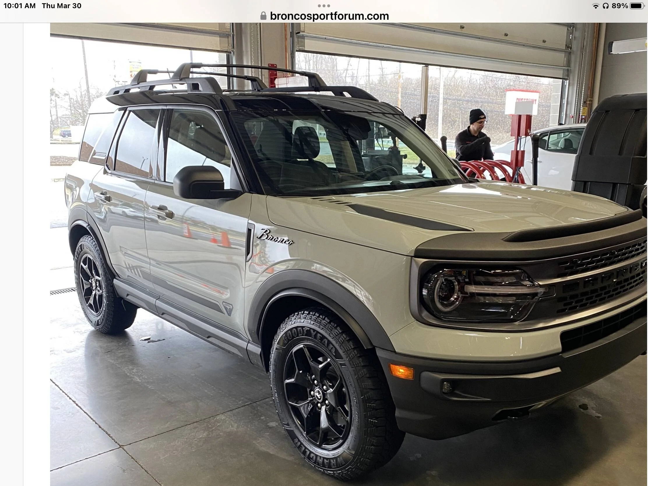

Exactly on the money .Mine are 235/70/17 in a badlands first edition . Perfect
