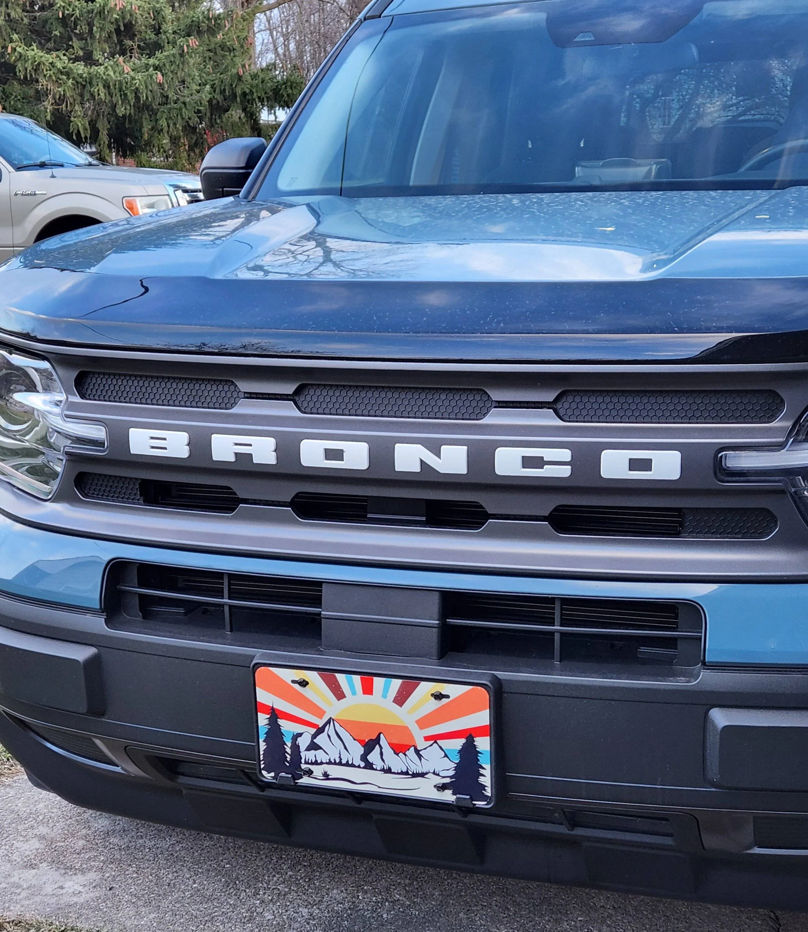

Thanks so much for your post! Ordered the bracket off eBay, showed your post to my husband, and...
Ta-da! Looks great!
