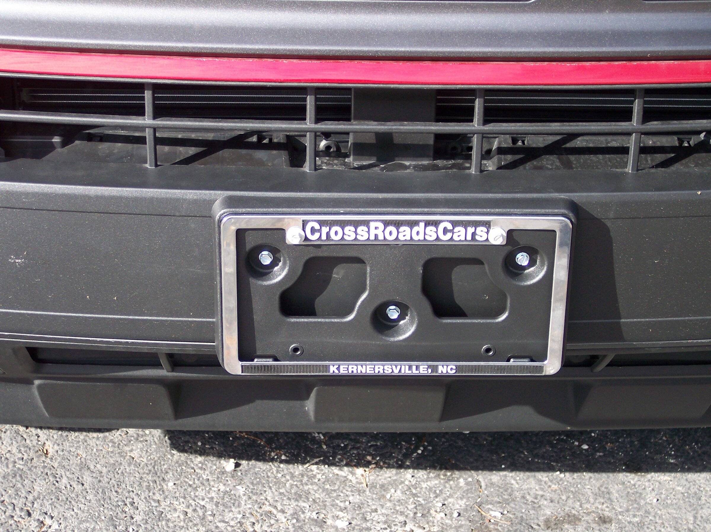

Our BS/BB did not come with one, & it is not listed on the window sticker. I got one from a nearby dealer & installed in a couple minutes using screws.
