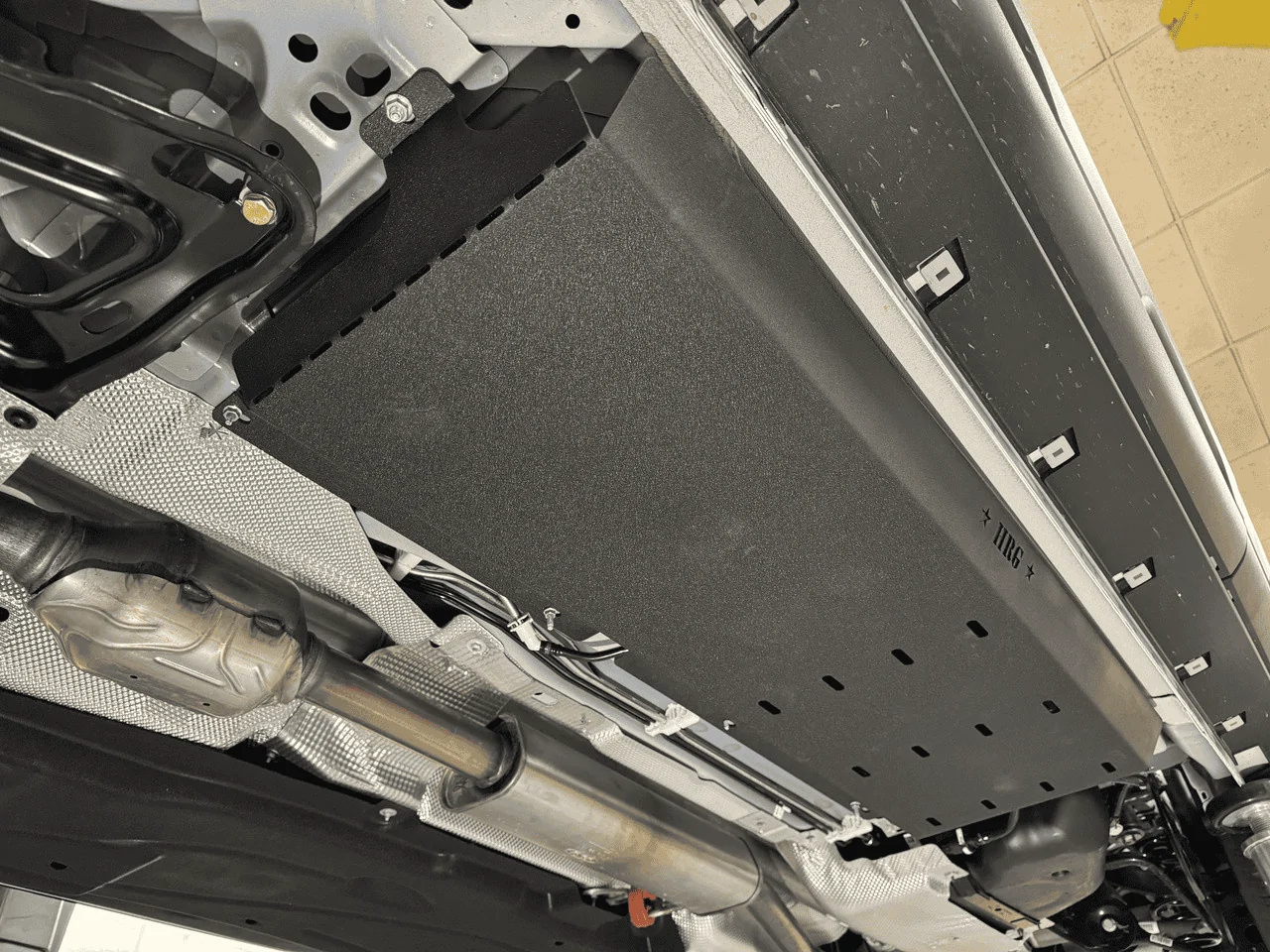

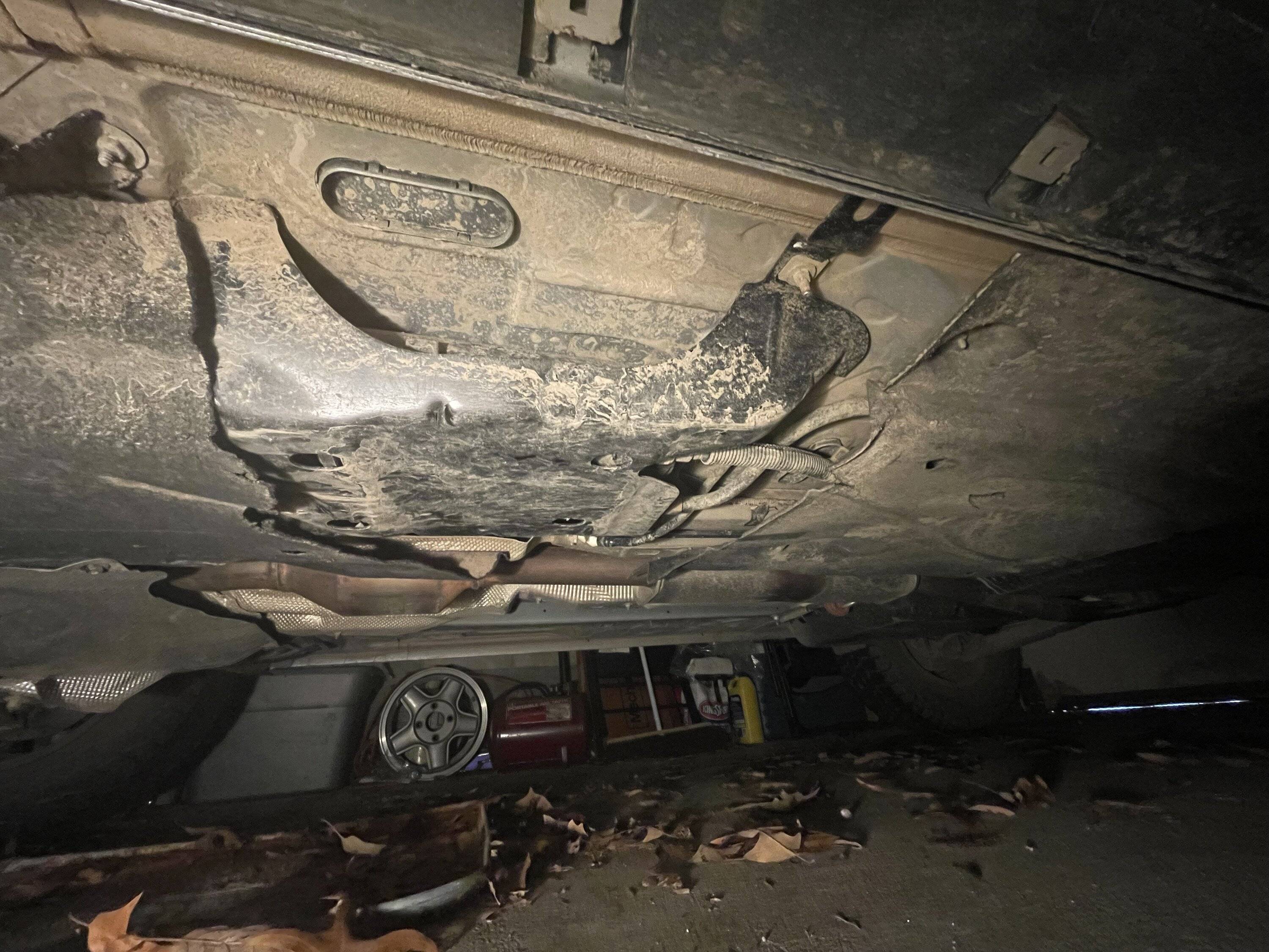

Well it finally happened, I ripped off most of the factory Felt mid skid plate, on my last off road adventure, to the New River Gorge National Park area, last weekend. It took about a a year and a half, of once a month, off road trips and I had previously ripped a palm sized hole in it but a combination off wet snow and a large rock, I didn't see, pulled the middle 1/3 of it down and I had to cut it off mid trail. Luckily for me (?) I had seen a Facebook post, from HRG the previous week that he had just installed a mid Skid of his own design. But, at $549, I had to take a look at the JCR version again, it being ~$100 less. Based on pics and price there are certainly some things I like about the JCR better but based on all the installation difficulties, of the JCR, as others, like @NMhunter have documented, I went with the HRG, which they claim is a straight, bolt on. We shall see!,
I'll post a follow up when it's on, Hopefully in about 2 weeks.

It looks like that rock hit me in the best possible place!

I also tore off my felt in Moab. Good thing the badlands has that steel plate over the canister itself at least. I love HRG so I'm excited to see what the install and build quality on these are like. I'm also excited to see them coming out with new products for the BS. Hopefully they're working on rock sliders too.
