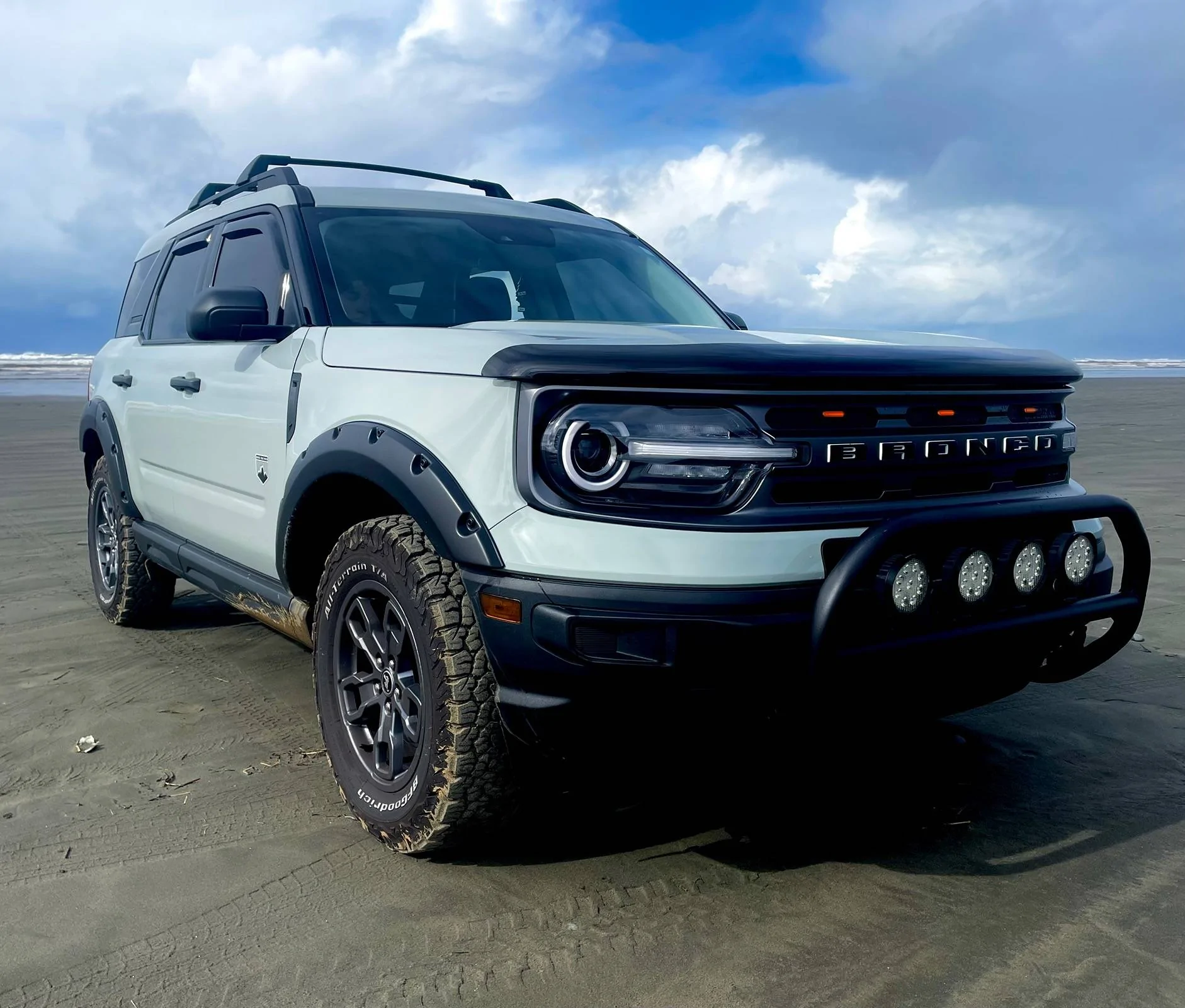

Ford Bronco Sport HRG 2.5” vs Ford Ranger Lifts 1.75” IMG_3766
I actually wouldn’t mind going this route, but I’ve got the Badlands. The compatible part lifts the front 1” and the rear .7”. The benefits don’t seem worth the coin.

Forgive me if I missed it, but have you posted a review? I'm mostly interested in how the upgrade affected your ride quality and fuel economy.
Oh your good I actually never put together a review mainly because my point of reference is very limited haha. This is my first suv and the first lift I’ve ever had installed on anything and I know almost nothing about vehicles so it just felt weird being vocal about my overall review of them.
Road noise definitely more noticeable, on the freeway it’s pretty loud in the cab but how much of that is the lift or the k02’s or a combination, I’m not sure.
I did read a lot how these springs would make small potholes way more noticeable and create a rougher ride which honestly hasn’t been my experience at all. I’d almost be willing to say there’s been no noticeable difference in how it feels while driving compared to oem springs. I drive like a grandpa though and only “off-roading” is dirt roads and the beach one time so far. All that to say, I’d definitely recommend these to anyone that’s debating.
Also mpg sits at 26 and I drive 5 miles one way to work, city driving, so really no complaints.
Dang it I’m so bad at knowing the differences between trim levels when it comes to that. That’s definitely something I’d consider not worth it. I’m excited to see which route you end up going!

Nice looking ride. Did it actually raise it the amounts advertised? Any ride difference?
I haven’t taken a tape measure to it so I can’t say it did with absolute confidence but the first few times getting in it after install I 100% could tell a difference. And tbh I feel it drives the same way it did before install. I don’t notice any roughness that people warned about and my mpg haven’t really changed. Maybe 1-2 mpg less? I’m not sure haha. It was pricey to have them installed but was a modification that I didn’t feel was worth risking my safety or destroying anything just to save money and try to do on my own with zero experience. So far zero complaints and would definitely recommend.
