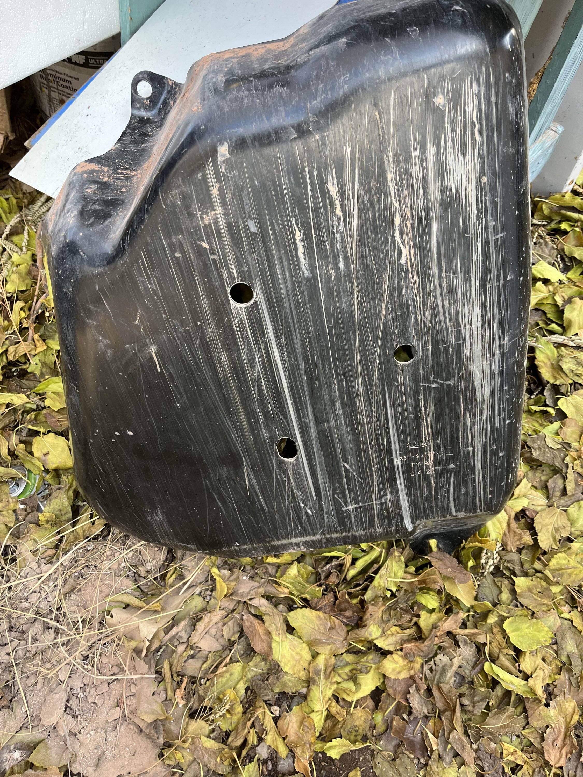

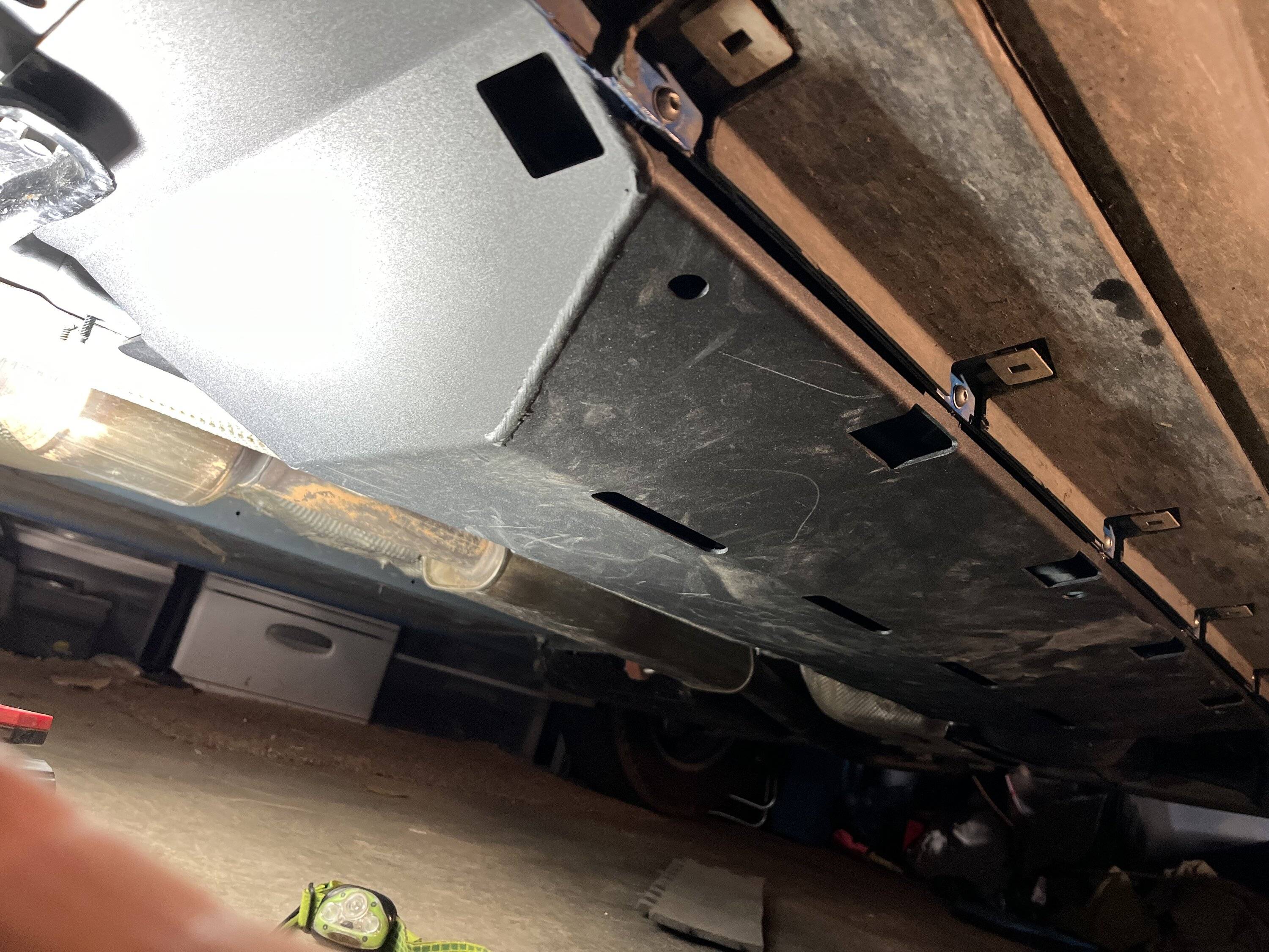

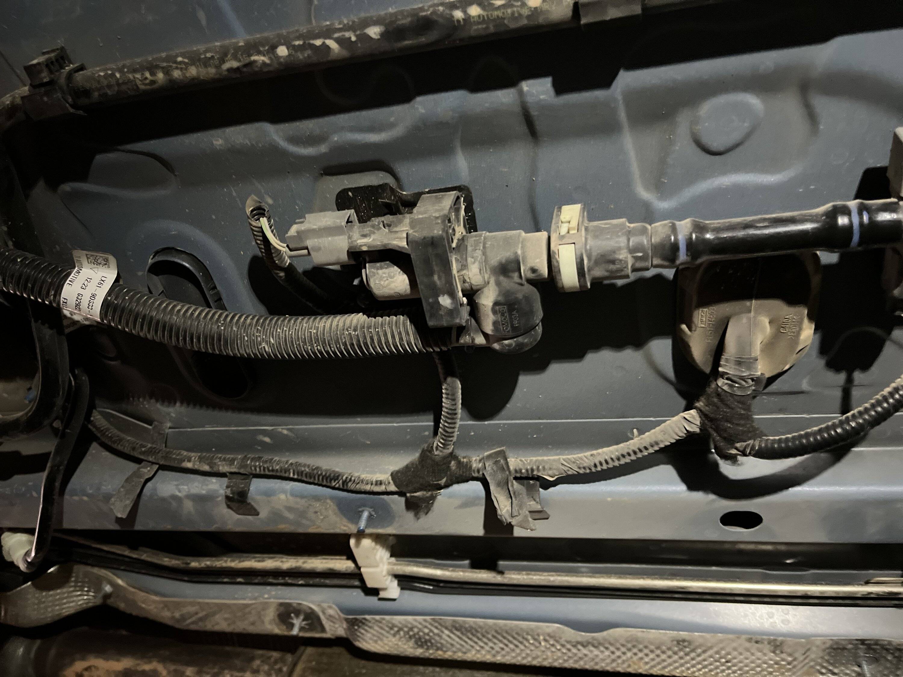

First photo is a before, second is gas tank skid, third is JCR skid in place.
Ford Bronco Sport Installed JCR Offroad Evap Skid on Badlands. IMG_1628
Ford Bronco Sport Installed JCR Offroad Evap Skid on Badlands. IMG_1627
Ford Bronco Sport Installed JCR Offroad Evap Skid on Badlands. IMG_1710

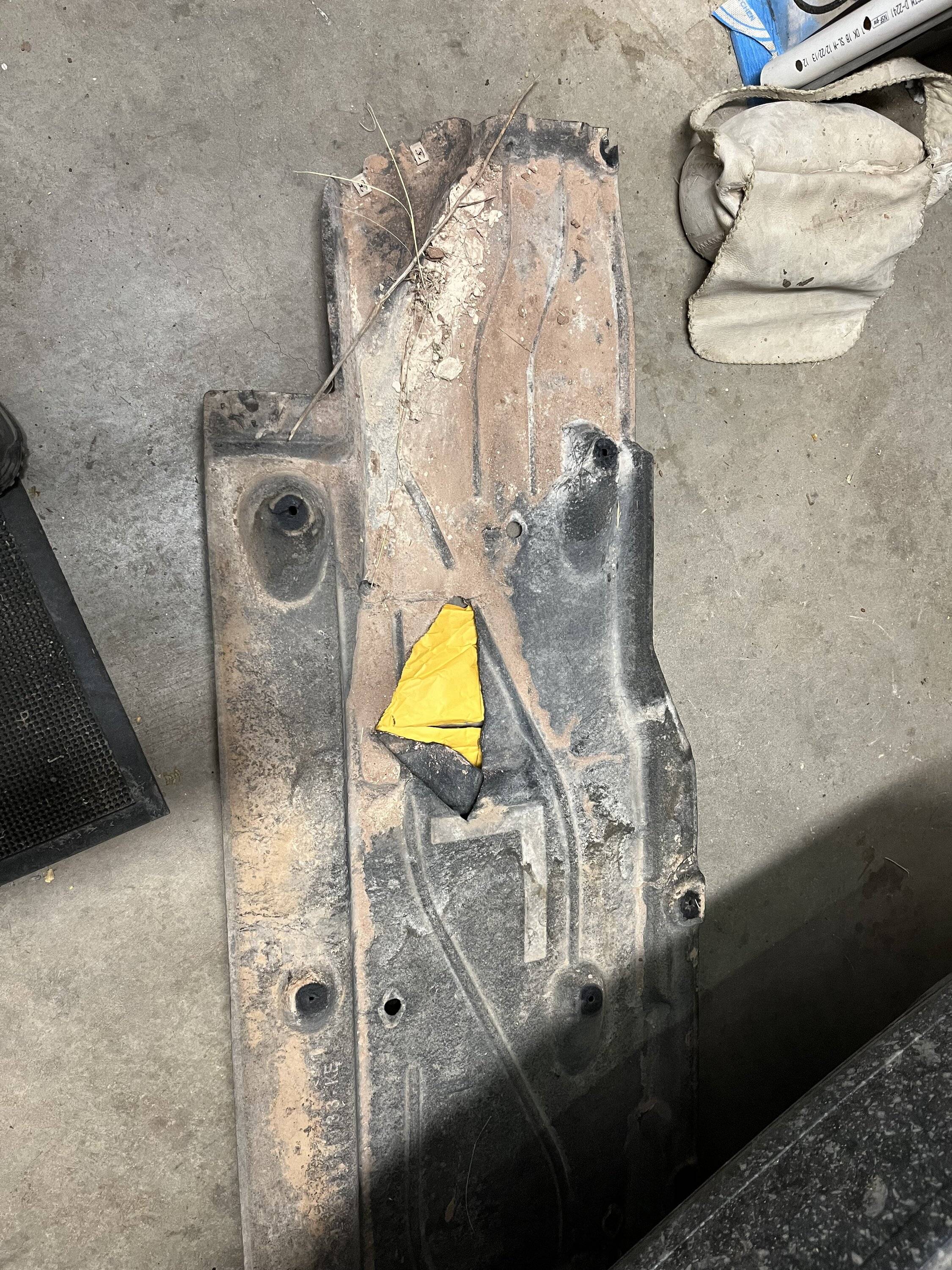

I haven't worked on the gas tank skid plate yet, but you can see from the photo that I need it. I put yellow paper under the carpet skid plate so you could see the rip.
Ford Bronco Sport Installed JCR Offroad Evap Skid on Badlands. IMG_1623

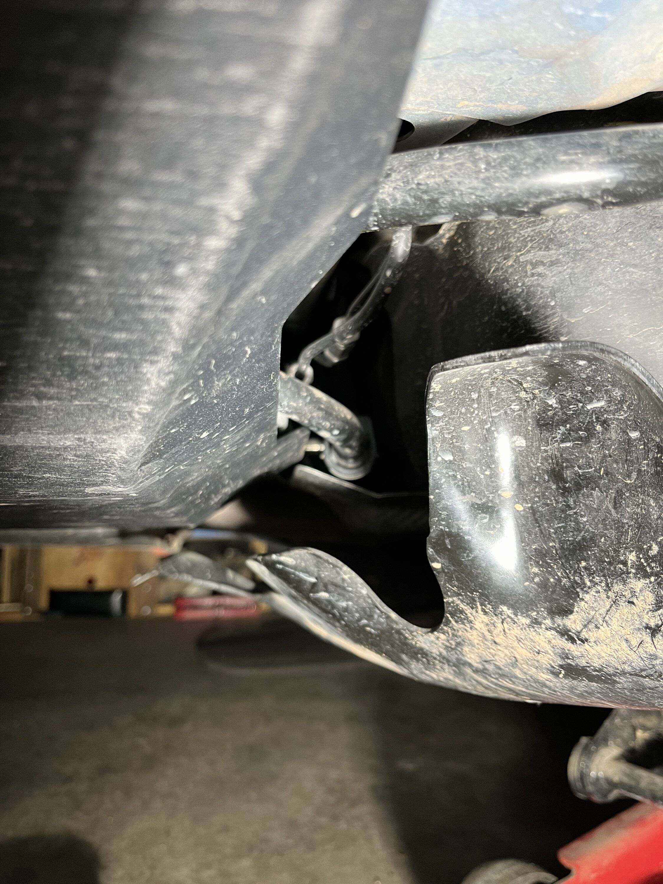

I got the gas tank skid trimmed today. It wasn't too bad. I though I could thread the bolt I cut off, but it was too short. I did a work around to make it work by cutting it off and connecting a short piece of angle iron with a bolt through it. I had to trim a 1-1/2" x 4-1/2" piece off the front. I only cut 1" off the first time, and it wasn't enough. Using an angle grinder made it pretty easy. Now I just have to find some replacement bolts.
It is an easier job with either a floor jack or a buddy to help you hold things up while you install the bolts.
If you have to do it, buy yourself a mini torch to burn the Loctite off of the button head torx bolts. Also buy a set of cobalt drill bits. With those, this should be a fairly easy project.

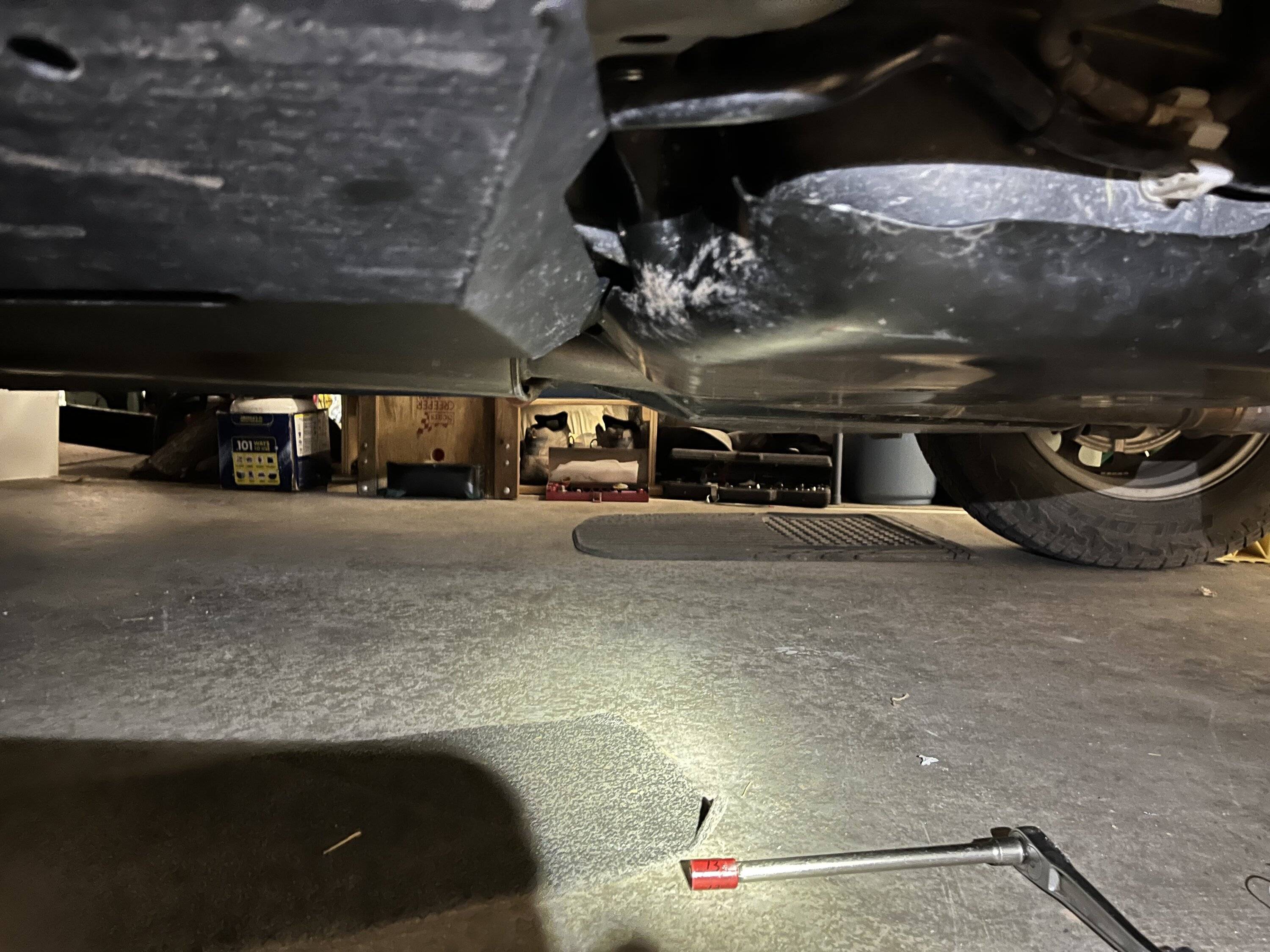

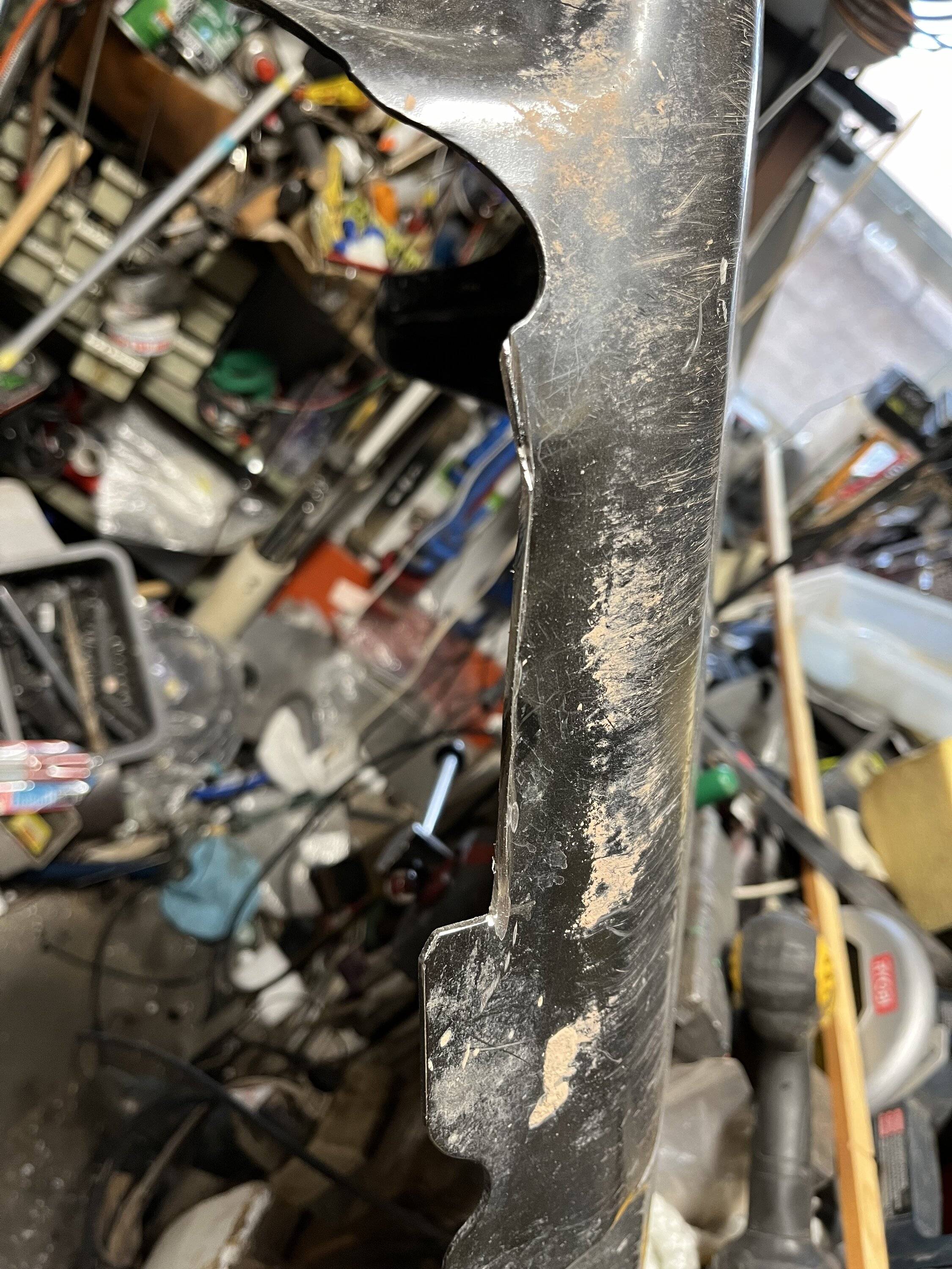

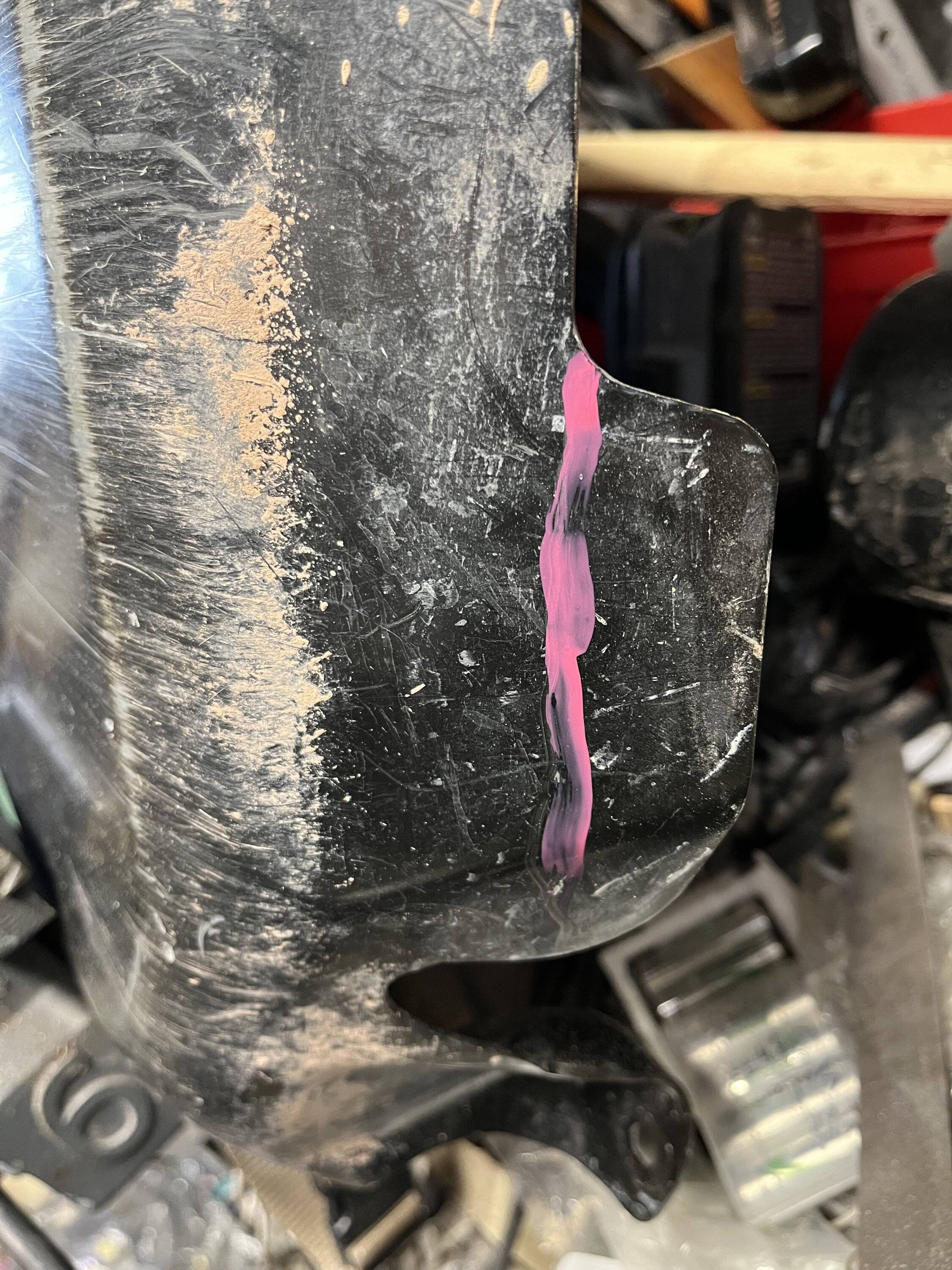

The first photo shows how it needs to be trimmed. The pink line was where I made the first cut. It wasn't enough. The next photo shows the final cut. The last photo shows the final fit. It isn't clear in the photo, but the gas skid fits up nicely behind the evap skid, so it won't catch on anything you slide over. If I had burned off the Loctite first, and started with cobalt bits, this job would have been relatively easy.
