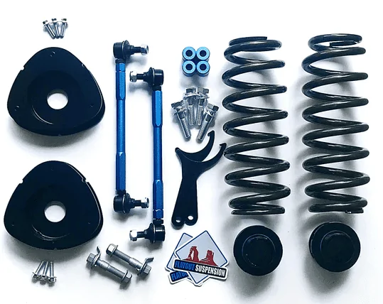

Hello,
Looking at the 1.5" Flatout and HRG kits.. any further details on the difference in included parts would be appreciated. What makes one kit's components better than the other?
https://flatoutsuspension.net/products/bronco15level?_pos=2&_sid=ca5862e73&_ss=r
https://www.hrgoffroad.com/1.5-inch-38mm-lift-kit-for-2021-2023-ford-bronco-sport/
Are Flatout's included springs necessary/helpful vs kits that do not include new springs?
For a 1.5" lift, would the shock extenders and rear subframe spacers from Flatout still be beneficial to install?
https://flatoutsuspension.net/collections/2level/products/shock-extender
https://flatoutsuspension.net/products/ford15spacer?_pos=8&_sid=ca5862e73&_ss=r&variant=43148736757995
Lastly, how easy is the install for a DIY in a driveway or is a professional install highly recommended? I've contacted a local shop and they estimated about $700 CAD ($525 USD) to do an install (5hrs work + alignment, less $ if goes faster), does that seem reasonable?

I got the 2 inch lift from Flatout. It looks great. One guy at my shop did it in less than 3 hours. Then another 30 min or so for alignment. Flatout kit is highly recommended by me. Great quality and their customer service was great as well.

Decided to order the Flatout Suspension 2" spacer lift kit along with their subframe spacers and shock extenders. Really think their kits are the most well designed and thought out to implement a small lift with minimal affect on factory geometry and components.

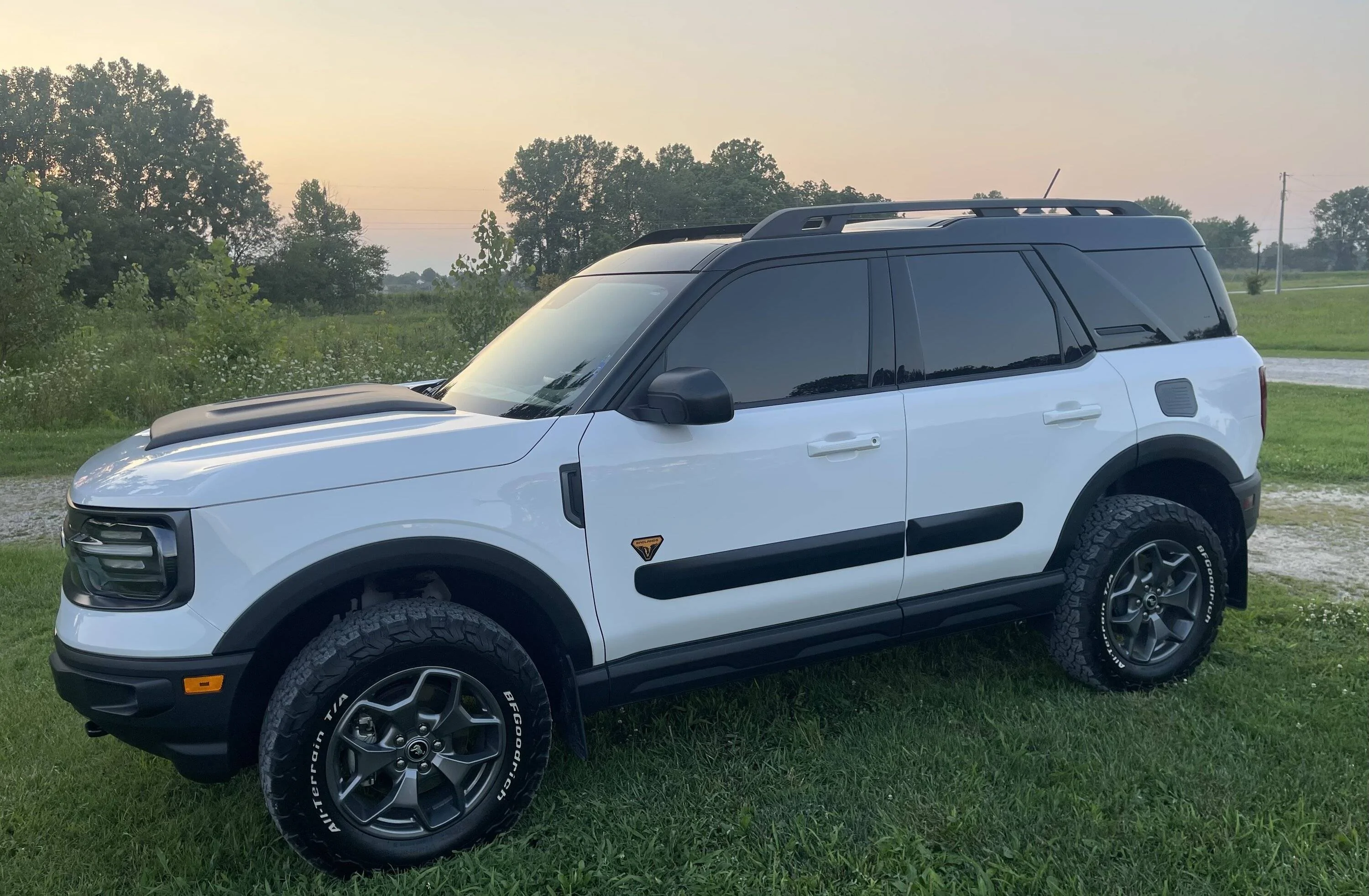

do you have pics you can share?
