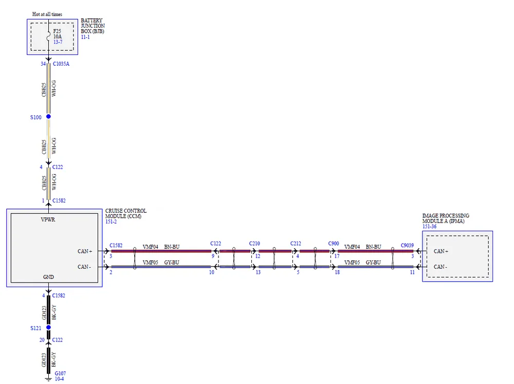

First I acquired the system diagram for the Image Processing Module A (IPMA) The Millimeter-wave sensor directly communicates with the IPMA on CANbus. In the original factory harness for vehicles with ACC, the harness will have the MM wave sensor wires built-in, you can still buy the wire from Ford, but that need you to replace a lot of wire harness in the car, and basically, you need to take part the whole front end of the car.
Ford Bronco Sport How to Retrofit ACC (Adaptive Cruise Control) to Bronco Sport -- Modification / Install Guide (DIY Writeup & Video)) Wiring+1
According to the diagram, I need to establish a connection between the sensor and the IPMA.

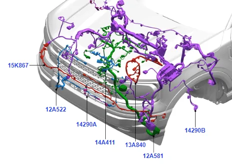

Below is an electrical wiring diagram of the engine compartment.
Ford Bronco Sport How to Retrofit ACC (Adaptive Cruise Control) to Bronco Sport -- Modification / Install Guide (DIY Writeup & Video)) Engine+Compartment+Wiring
Upon inspection, the wire that connects the millimeter wave radar sensor to the harness assembly is 14290A. However, with my visual inspection, my vehicle does not have the connector for 14290A on 12A522.
With some further wire tracing, in order to change Harness 12A522, I also need to take apart the front radiator to fully remove the harness. Since I don’t have the equipment to take apart the radiator assembly. I chose to make my own harness for the MM wave sensor.

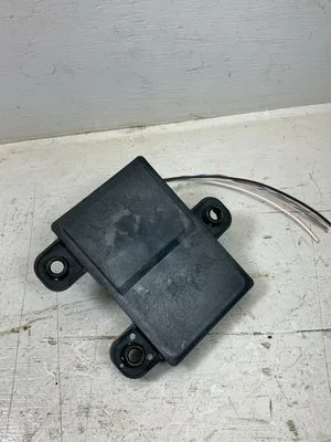

I acquired a MM wave sensor from a wrecked Ford Explorer, the same MM wave sensor used on my vehicle. I also acquired a new sensor bracket and sensor cover. A new bracket will ensure a correct fit, which is essential for the sensor calibration later. Make sure to ask whoever you buy the sensor from if they will include the plug.
There are several different configurations of the sensor, but they can all be programmed
I purchased 20 AWG automotive wires, 22 AWG CANbus wires, automotive cloth tape, electrical tape, and protective wire tubes for making the harness.

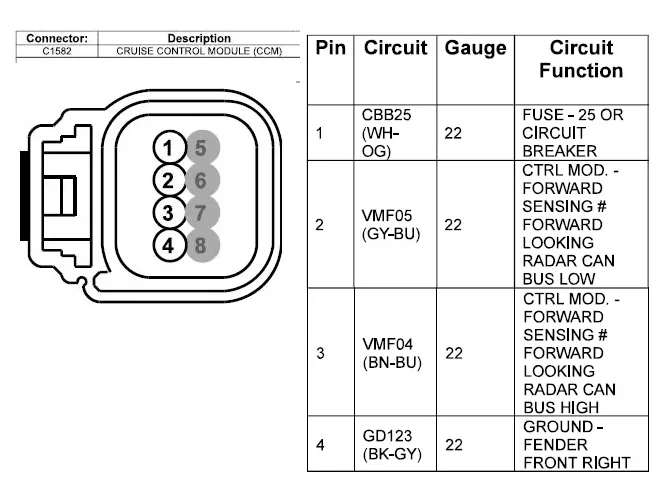

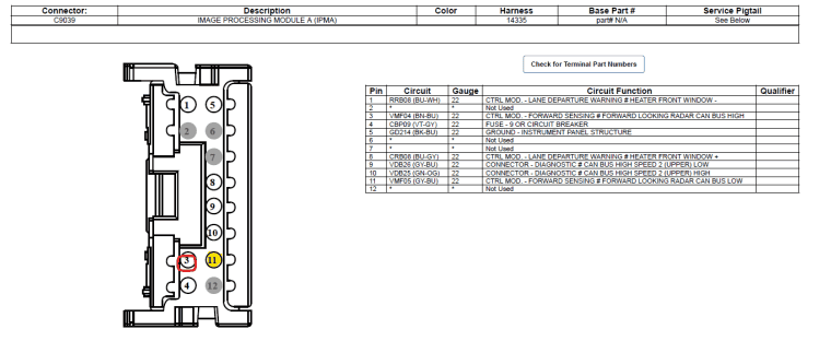

According to this MM wave sensor pigtail diagram
Ford Bronco Sport How to Retrofit ACC (Adaptive Cruise Control) to Bronco Sport -- Modification / Install Guide (DIY Writeup & Video)) Pigtail+1
I used CANbus Wire to connect #3 CAN High and #2 CAN low. Then I used a 20AWG wire to connect power on #1 and #4.

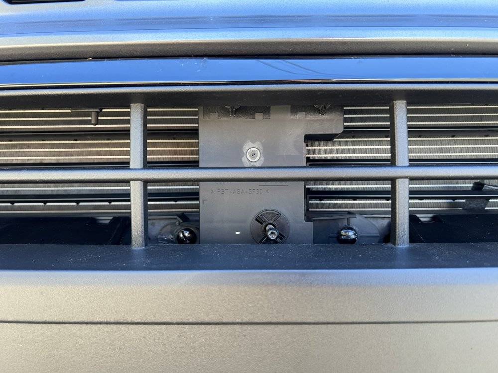

I cut out the front facia of the radiator bracket and exposed the mounting points for the sensor bracket. You need a shear to cut out the slots, but there are ridges on the original bumper, just follow the lines. The best way is to use a utility knife to mark the cutting and then use a shear to cut it. It will make sure your cuts are clean and avoid cracking the bracket.

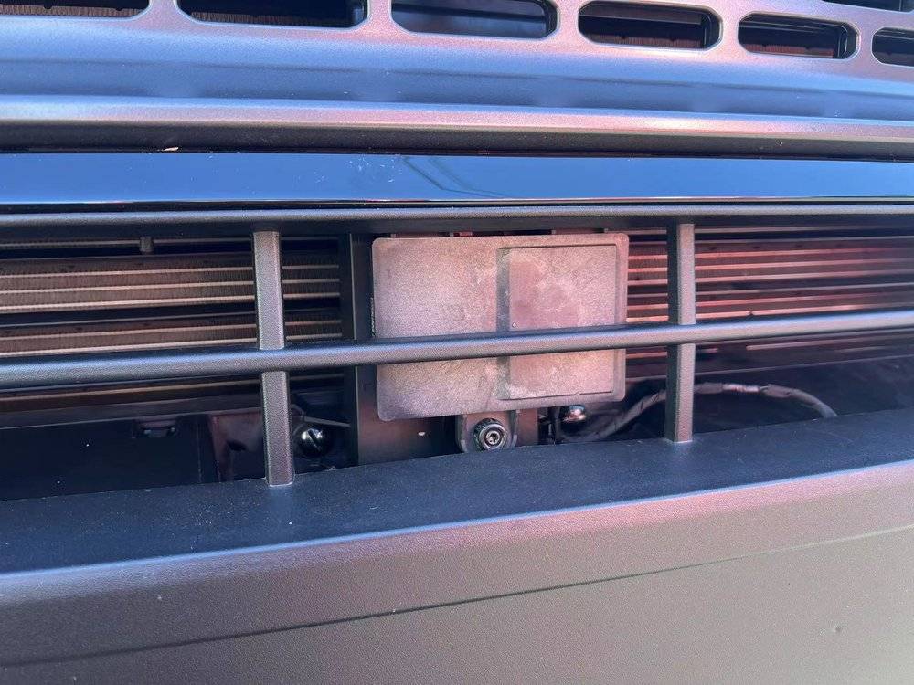

Then I installed the MM wave sensor on the bracket and used a spirit level to calibrate the angle of the MM wave sensor.

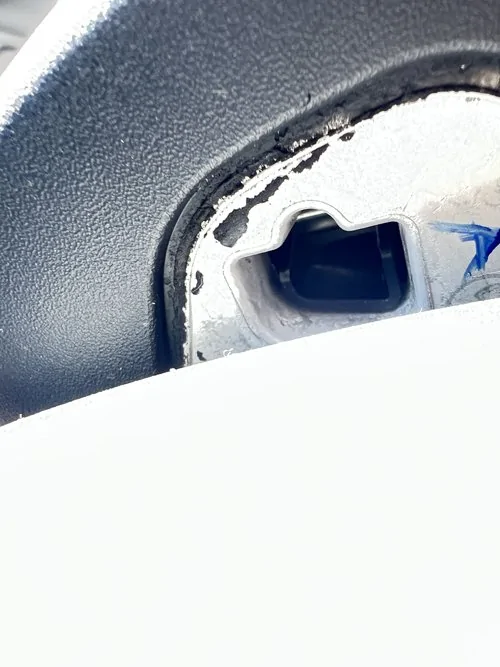

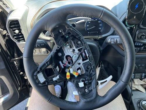

I disconnected the battery again because, in order to change the steering wheel control switch, I need to take off the airbag. When the vehicle has power, there might be a risk to trigger the airbag to deploy.
Ford Bronco Sport How to Retrofit ACC (Adaptive Cruise Control) to Bronco Sport -- Modification / Install Guide (DIY Writeup & Video)) 112
Use a long small flat head screwdriver to release the pins. Again disconnect the battery when you do it, otherwise, you may have the risk of triggering the airbag.
Ford Bronco Sport How to Retrofit ACC (Adaptive Cruise Control) to Bronco Sport -- Modification / Install Guide (DIY Writeup & Video)) 113

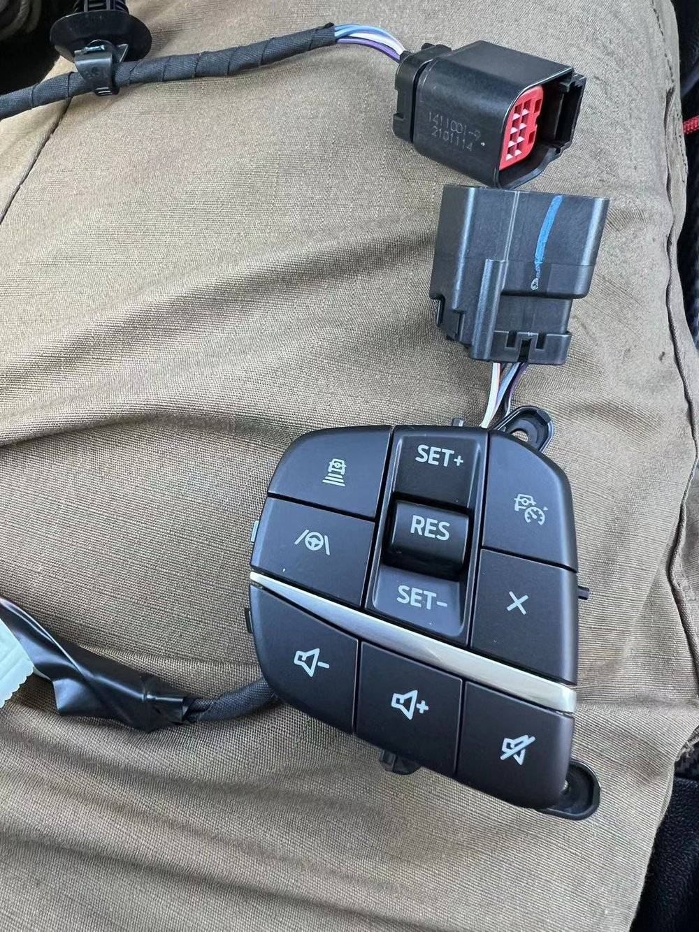

I switched out the regular cruise control switch to the adaptive cruise control switch.
Ford Bronco Sport How to Retrofit ACC (Adaptive Cruise Control) to Bronco Sport -- Modification / Install Guide (DIY Writeup & Video)) Switch
Upon putting back the steering wheel assembly, connect the battery. I checked if the vehicle can be turned on and closed up all the panels. After this step, all the physical modification of this project is done.

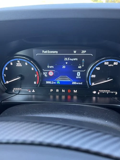

Starting with IPC, The visualization of the adaptive cruise control is shown on the instrument cluster, So I enabled the traffic sign recognition and adaptive cruise control panel on the Cluster Screen.
Then I need to program the CCM. Since the MM wave sensor comes from a Ford Explorer, I need to change the vehicle VIN and Vehicle model to the CCM.
The VIN number on the vehicle is in ASCII but CANbus recognize hexadecimal codes. I converted my VIN number to hexadecimal. This will establish a correct connection with IPMA, IPC and ABS since all of these modules use VIN to cross-check the integrity of the system.
In IPMA, I reprogrammed the cruise control function, traffic sign recognition, lane centering, distance alert, and pre-collision mitigation.

Since I changed the steering wheel switch, the programming of SCCM needs to be altered in order to recognize the new switch. I wrote the new program to the SCCM to establish a connection with the new switch. The one you need to use must match the back sticker of the switch. But overall it should be something the same as your original part number but end with D rather than A.

The last step is to calibrate the front sensor.
The calibration will let the MM wave sensor and Camera collect data to establish its angle and sensitivity. There is a function in the forscan for calibration.
First, park your car on a flat surface, double check that! Then level the MM wave sensor to make it parallel to the ground. The adjustment is done by the screw at the bottom of the bracket. Do it slowly and triple-check it is correct.
I did the calibration early in the morning on a straight road where there is no excessive traffic.
The calibration will require the vehicle to move at a constant speed above 30 mph. And there will be minimum metal objects like metal billboards on the side of the road.
I finished the calibration in 15 minutes with both the sensor and camera calibrated.

After the calibration, the Adaptive Cruise Control is now in working condition.
