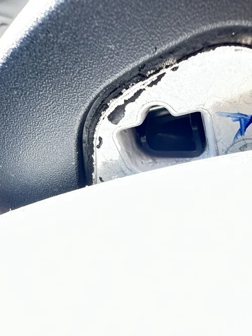

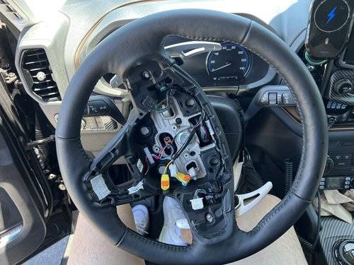

I disconnected the battery again because, in order to change the steering wheel control switch, I need to take off the airbag. When the vehicle has power, there might be a risk to trigger the airbag to deploy.
Ford Bronco Sport How to Retrofit ACC (Adaptive Cruise Control) to Bronco Sport -- Modification / Install Guide (DIY Writeup & Video)) 112
Use a long small flat head screwdriver to release the pins. Again disconnect the battery when you do it, otherwise, you may have the risk of triggering the airbag.
Ford Bronco Sport How to Retrofit ACC (Adaptive Cruise Control) to Bronco Sport -- Modification / Install Guide (DIY Writeup & Video)) 113
I switched out the regular cruise control switch to the adaptive cruise control switch.

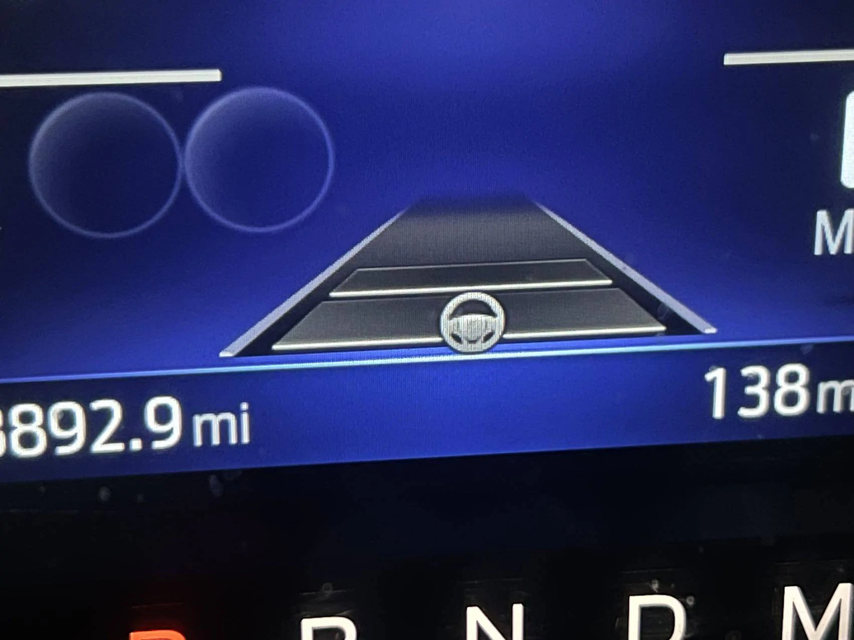

Upon putting back the steering wheel assembly, connect the battery. I checked if the vehicle can be turned on and closed up all the panels. After this step, all the physical modification of this project is done.

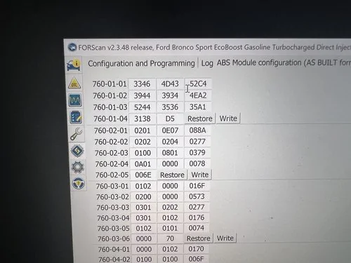

ABS program detail
Ford Bronco Sport How to Retrofit ACC (Adaptive Cruise Control) to Bronco Sport -- Modification / Install Guide (DIY Writeup & Video)) 17
My vehicle does not come with Adaptive cruise control, so the ABS pump is a regular vacuum-boosted pump rather than an electric-boosted pump. The electric booster pump will initiate smoother braking when the vehicle is on adaptive cruise control in the city.
While the vacuum-boosted pump will have stepped braking applied at each stop. But it will only be noticeable when using Adaptive Cruise Control in Stop & Go traffic. Both pumps are able to function with the adaptive cruise control without any safety concerns.

After the calibration, the Adaptive Cruise Control is now in working condition.

Since I changed the steering wheel switch, the programming of SCCM needs to be altered in order to recognize the new switch. I wrote the new program to the SCCM to establish a connection with the new switch. The one you need to use must match the back sticker of the switch. But overall it should be something the same as your original part number but end with D rather than A.
ABS program detail

Hi all, quick update.
I believe that Lane Centering is not that easy to enable, the roadblock is Traffic Jam Assist. Whenever Traffic Jam Assist in IMPA got enabled, the whole ACC will become not available.
I can get the Lane Centering Steering Wheel Icon to display on the cluster, but it never turns green when engaged. Nor does it center the vehicle in the lane. I tested multiple times in the past couple of weeks. No Luck.
Ford Bronco Sport How to Retrofit ACC (Adaptive Cruise Control) to Bronco Sport -- Modification / Install Guide (DIY Writeup & Video)) LCA
I'm planning to change my APIM to a Navigation-enabled one, but that will happen probably later in June. Also changing the ABS booster may take much more time because my BS is my daily driver and at the moment I only have one vehicle. The ABS booster change is not a weekend job, unfortunately.
With that said, I will keep digging and updating here.
