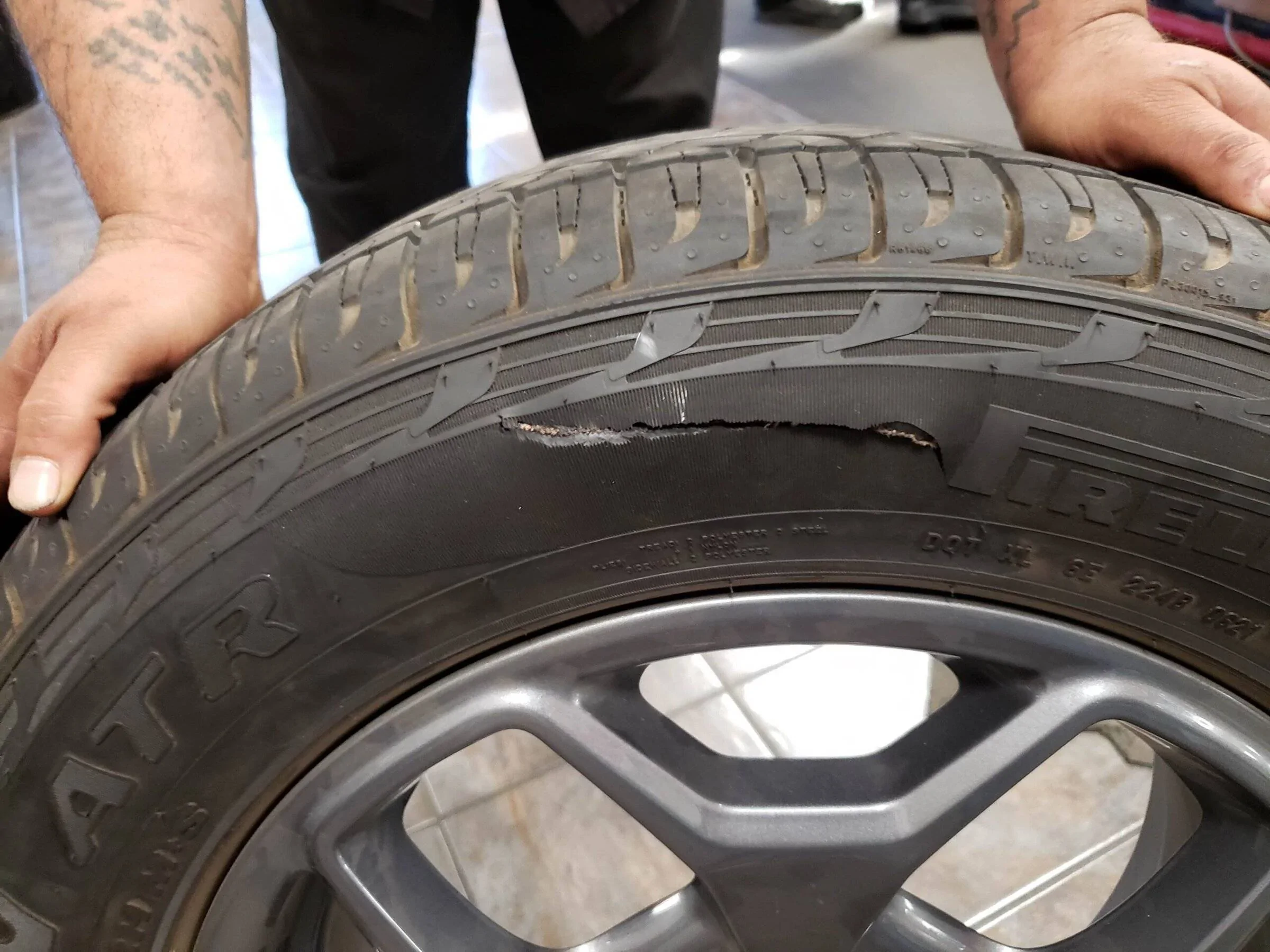

Are these the OE Pirelli ATR?
Here is there number. Reach out to them and see if they are able to help.
800-747-3554
I can't tell if something cut the sidewall as it almost has a zipper like appearance to the split & not the common "slash" to a road hazard.
800-747-3554
Sorry, didn't want to hijack your thread, it's all but old news now. Yes, the stock tires, my wife got a flat tire and this happened when they tried to release the bead to do the replacement. No visible damage to the sidewall prior. It happened with only 700 miles on the tire.

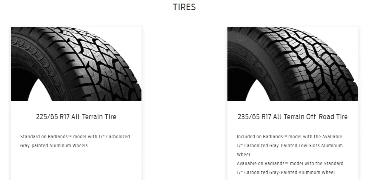

The Ford website is not a fount of knowledge concerning the available tire options that come on the Badlands trim. Are the optional "off-road" 235/65 R17 tires the Wildpeak A/T3W or the Wildpeak A/T Trail as pictured?
