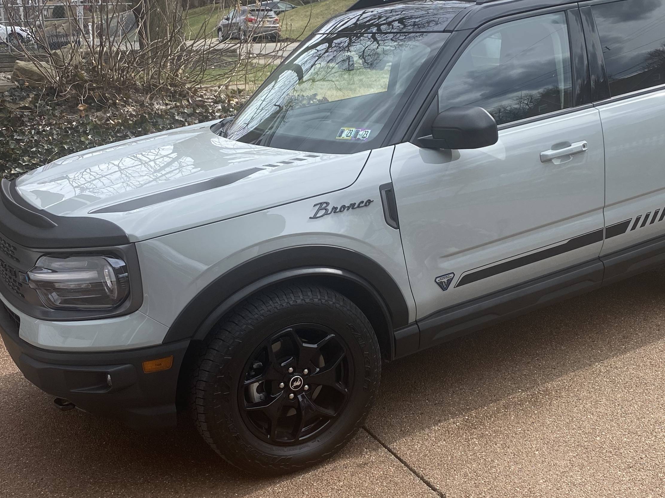

I have the bronco first edition sport and they came with 235 on , I am looking to go up to 245/70/17 falken
Within the Falken brand, they can be. For example, we have the OE Wildpeak AT3w (AT3wA) and the off the shelf Wildpeak AT3w. When comparing them side by side, the off shelf AT3w has a more aggressive tread design compared to a more conservative AT3wA/OE At3w. The OE versions typically have to be conservative as it has to meet certain noise, comfort, and performance levels for that vehicle manufacturer as the manufacturer is gearing the tire for the general public (not enthusiasts). This could explain why the Pirelli's aren't performing to an expected level. However, I'm sure if purchase a off the shelf Pirelli, performance would blow the OE version. I'm not defending Pirelli; I'm solely shedding light on the scenario.
I believe this is the 235/65 and 245/65 in 17's? Biggest difference is the the 235's are the OE tire for the sport. The 245s are the off-the-shelf wildpeak AT3w. Technical differences? 245s would be half an inch taller than the 235s but not much of a difference in terms of width. 245s weigh 8 lbs more, so this will affect MPG/performance of the vehicle. 245s has a higher load capacity due to this added, on the other hand. The 235s does have a softer compound, so it won't last as long as the 245s (being that it is a OE tire), however I haven't came across a case where a owner complained about a short life. Then again, they are probably utilizing the vehicle to it's full potential & understand tire life would be sacrificed.
Would like to try 245/70/17 on my first edition 2021 sport any thoughts ?
Ford Bronco Sport Hello from Falken Tires 58F2C31E-6126-44F0-A076-E320D1D3BD4F
My recommendation is don’t try that size! If you do make sure wherever you get them from will give you a full refund, when you find out they are rubbing the pinch weld or somewhere else in the front wheel well.
Thanks for the advice. Just a thought. I am going with the 245/65/17 falkens .
Ford Bronco Sport Hello from Falken Tires 8C539C91-1108-4395-9ABB-76EF12E75A21
245/65/17 should not be a problem on any BS, with the possible exception of, if they are on wheels with a very different offset, than the oem.

@Jrl a 245/70R17 is a very aggressive size to go. Modifying the vehicle, starting with a lift kit for clearance & additional wheel well room, along and going with less positive wheel offset to clear suspension components, would be just the beginning.
If the vehicle hasn't been modify with no intent to do so, 235s or 245s in a 60 or 65 series should be fine, which has been confirmed by fellow Bronco Sport owners. This is a safe plus size alternative that will provide good results without harsh consequences to MPG/performance/handling, etc.
