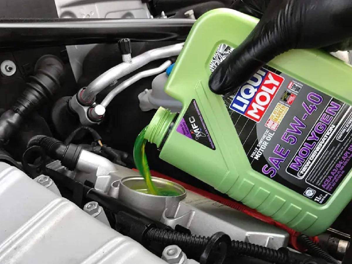

I have used an oil from Liqui Moly that was clearly green:
Ford Bronco Sport Green tint in drained motor oil 1679855553606
So, not all of this sort of oil is made with a dye that is only visible in the UV spectrum.
