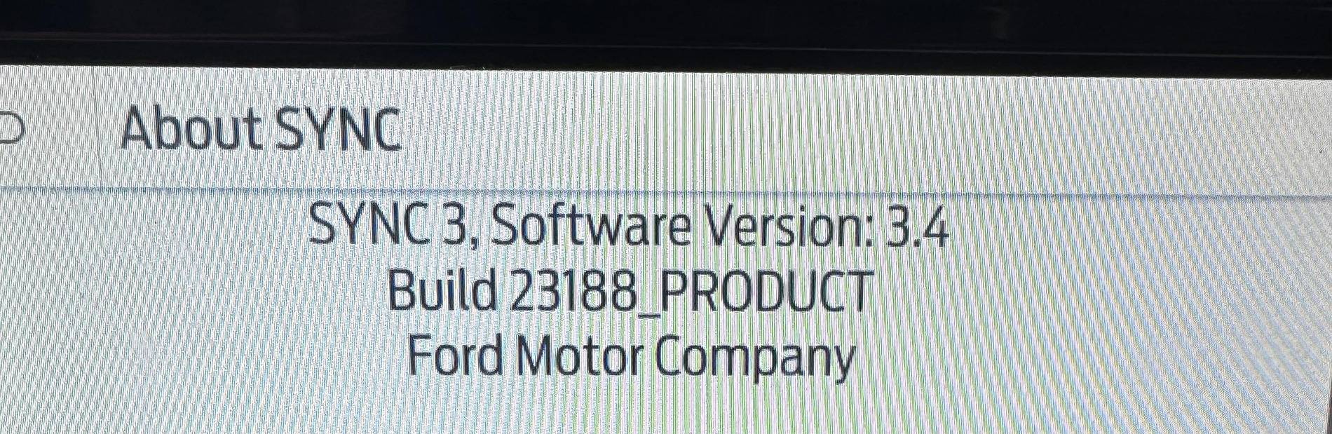

We ask questions to help you solve your issue. We still do not know what Build of SYNC 3.4 you currently have installed. How about taking a photo of the screen showing the Build and posting the photo.

Thank you again to everyone that's helping and offering suggestions! Here's are some updates. . . first. . . wait for it. . . the coveted screenshot of the version of Sync that I have. Behold! 23188 :)
-When I said that Google Maps crashes Bluetooth, it doesn't just crash Google Maps, my entire Bluetooth connection with my phone is lost and I have to turn off the car and start it again for it to connect again.
- IOS version 18.3.2
- Battery has been replaced and doesn't have the original anymore
- I just remembered I was wrong about Waze. . . although it doesn't crash my Bluetooth connection and never did, now that I think about it, it never played through phone calls. But Google Maps always did before
- I don't use CarPlay because I'd rather see my regular screen, not the Carplay screen.
- Not always, but sometimes my phone is connected to USB in the center console for charging
- Google Map app settings are set to what y'all mentioned
-Again, I didn't change anything, it just straight up started crashing when I use Google Maps after years of it working. I truly appreciate all of your help, but I think I might have to just give up
Ford Bronco Sport Google Maps Crashes Bluetooth Connection thumbnail (1)

3. Power on your iPhone and wait for it to boot, log onto the iPhone
4. Pair your iPhone with Sync
After doing the pairing procedure, how long does it take for Bluetooth to stop working while Google maps is running?
Here are some possible other causes - perhaps this will trigger ideas for you:
1. Physical obstacles (like metal objects) can interfere with the Bluetooth signal
Unlikely but possible the iPhone case is causing unstable Bluetooth connections.
2. Interference:
Other Bluetooth devices or wireless networks in your vehicle can potentially interfere with the connection. Try moving the phone or turning off other devices to see if it helps.
Maddy3
Madison
Jul 12, 2021
24
TN
Thank you so much again, Dude! I tried another iPhone and holy moly, it worked for the short distance I tried it. BUT it's an older iphone only running IOS 16.7.11. The phone that I usually use is on 18.3.2. My thought when this all started was that something w newer versions of IOS aren't compatible w Sync, but that wouldn't explain why I'm apparently the only one having the crashing issue. And I've ruled out the possibility of an unstable IOS update not downloading everything that it needed to because I've updated many times since 16.7.11
