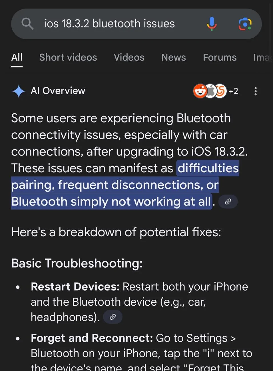

And what is even more odd, there have been no posts on this Forum with that specific issue
Many issues however don’t impact all iPhones running the same software version in the same way
My guess is if you could try a different iPhone 15 Pro with the same iOS 18.3.2 the problem would not occur - you are too far way for me to lend you mine to try
There is this AI Overview but typically this sort of AI overview is very inaccurate

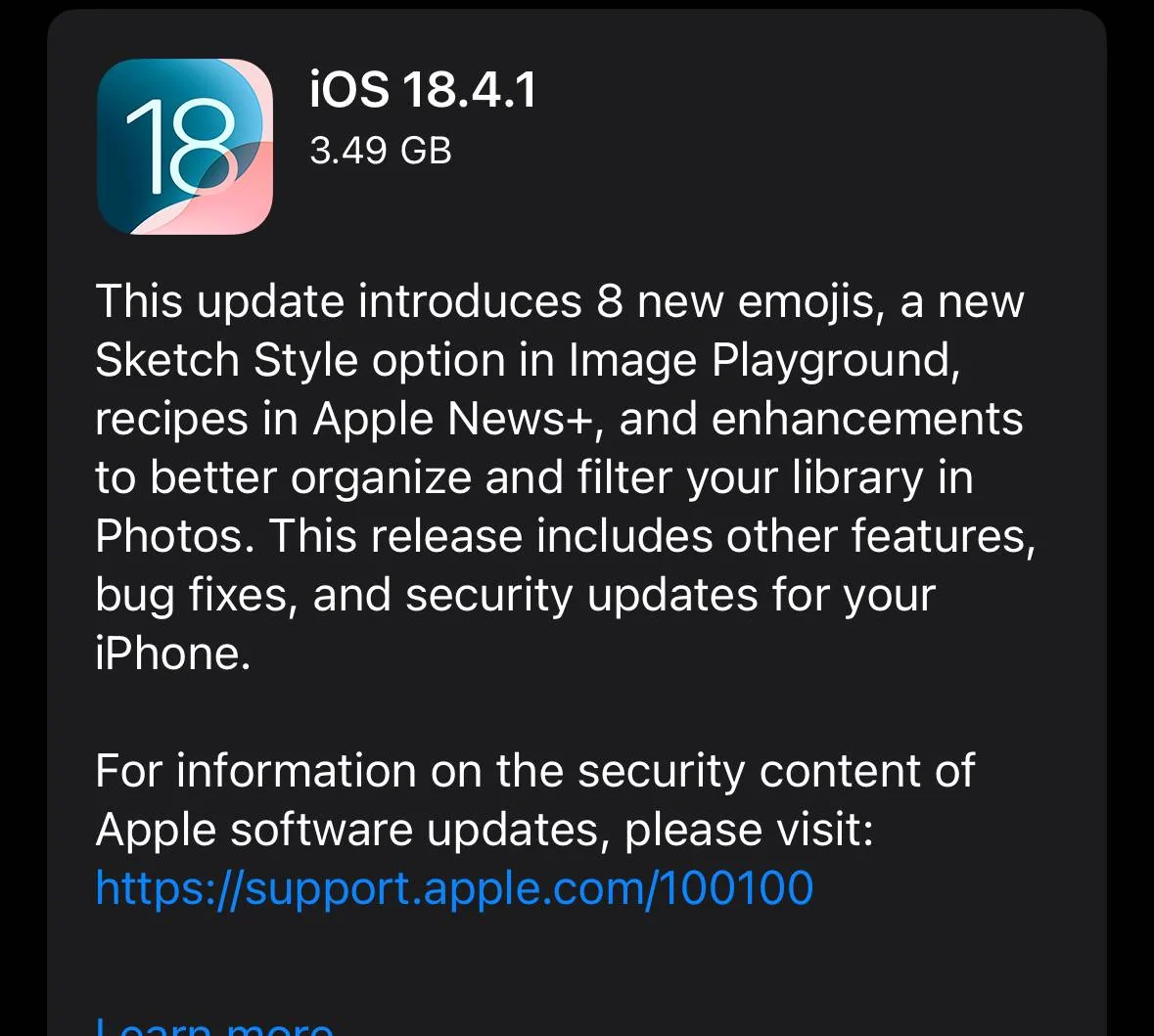

@Maddy3 iOS 18.4.1 is released … I know Apple said it would be “awhile” for a Bluetooth fix but why not upgrade your iPhone 15 Pro and see if your Bluetooth issues are resolved with that update … this release fixes a number of (wireless) CarPlay issues too
Ford Bronco Sport Google Maps Crashes Bluetooth Connection IMG_5144
Reactions: Me3
