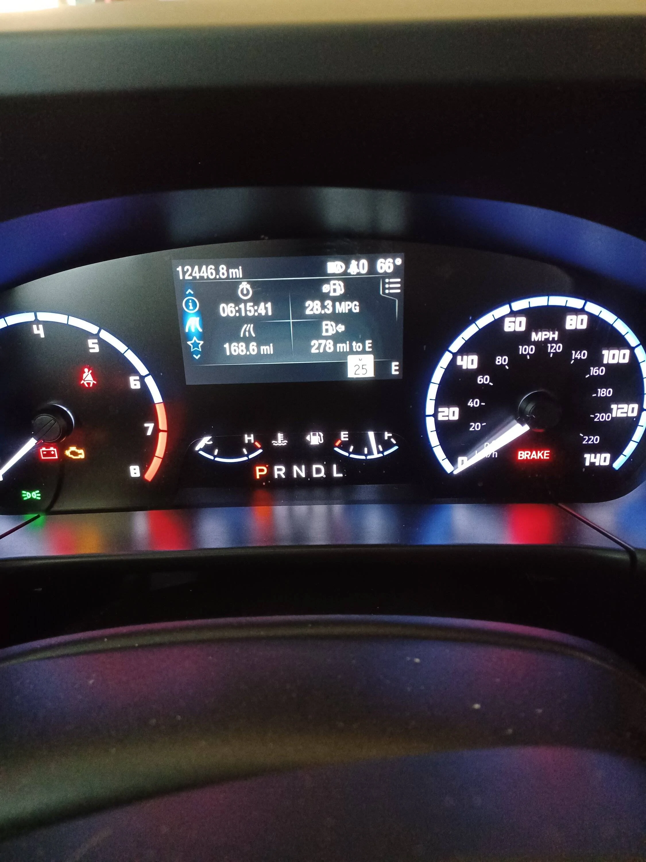

My 2022 Big Bend has averaged between 26-28 mpg since new. Here's a screen shot of the current reading.
Ford Bronco Sport Gas mileage? 20230413_104039
Mostly local driving on roads with speed limits between 35 and 55. Calculated mpg generally within a mile per gal, low side.
