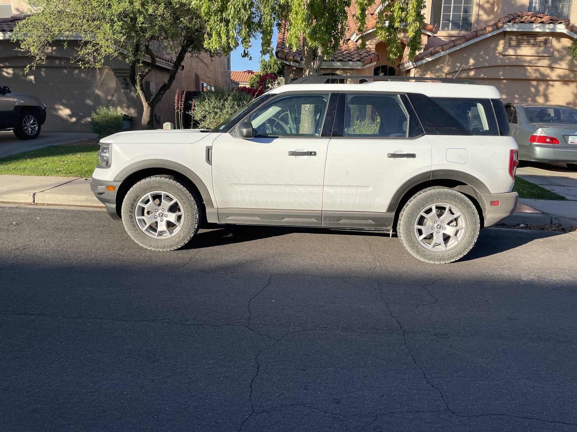

For anyone looking to go up size in tires here is the 1.5t gas mileage uphill. The trip down I got 29.7.
“Mini OJ” is sporting toyo open country at3 245/65r17 tires with no lift
Ford Bronco Sport 1.5t gas mileage with 245s 8BB814A2-D8DF-4CE6-B450-D91C83E2E3FC
Ford Bronco Sport 1.5t gas mileage with 245s 8CC25354-5B59-40FA-BA5C-3E4E2E2C5B57

Great info.
Any rubbing at full lock?
What are you doing with regards to the spare? 245 65 17 fit?

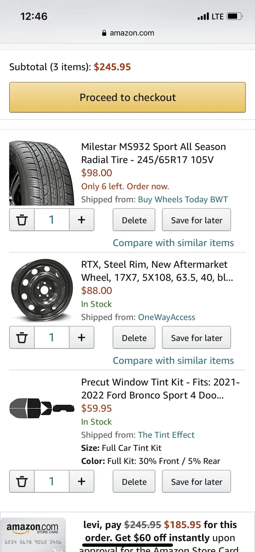

No rub whatsoever. Took her out to some trails and checked at different compressions turning to full lock. It’s close about an 1” but no run. I’m waiting on a steelie then gonna find the cheapest tire that’s 245 to mount. I’ll be making a indirect roof rack and probably mounting to that.

Rub* unistrut*

Scratch that. Found a rim steelie on eBay for 66$ and a used all terrain for 65 .

Even jeeps running the 4.0 v6 engine were not making this much power until about 2006. There’s no power issues with the 1.5. I haven’t noticed any issues with the bigger tires and gearing. I’ve taken this sport up steeper hills that my tundra couldn’t make it up in 4wd. My police unit, a Dodge Ram, also has a v8 and 4wd and can’t go up hills like this. The tires give me better confidence with not bottoming out or destroying the sidewall. I mean I’m not gonna rock crawl the thing. For reference, They are an inch taller than the stock badlands tire and 1.5” taller than stock base tire. My mpg ha barely been affected, my speedometer is barely affected.

how is the steering feel, acceleration, noise, on pavement? I am looking at going with the Toyos in the 245s

my BFG K02 are pretty noisy, but otherwise it handles as per usual.
