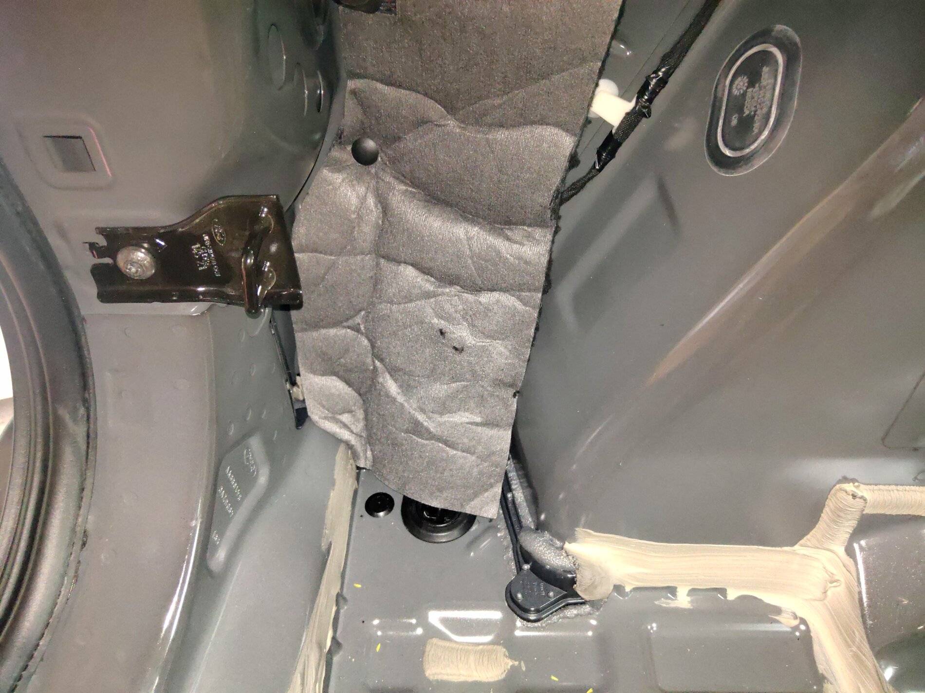

Thanks a lot everyone, I did found the actual flapping noise, I took the whole panel out it wasn't that hard but No need to take the entire panel out to do this, there is two quarter panel vents one located on driver side and other passenger side vents are hidden below I circled in red first picture, all I did is to move the foam inward pushing it in toward the vent yes I did cover the vent with this factory foam and for the passenger side foam sits too high up had to relocate it down, took it for a test drive and no more flapping noise.
Video shows vent flapping around but did not made any noise because I had the panel off only with panel back on it will make this noise again.
Quarter vent Location:
Ford Bronco Sport Flapping noise cargo area IMG_20210918_120241
Before
Ford Bronco Sport Flapping noise cargo area IMG_20210918_132238
After
Ford Bronco Sport Flapping noise cargo area IMG_20210918_132301

There no other quick way to do this those side panels grill are not removable the top can be removed it's too small to reach down there.
On post #27 I showed all the retaining clips that needs to removed and fold down the seats just enough room to get your hand in there, removing the entire panel out requires seat removal and some other plastic pieces to be removed. This post was posted over a year ago I'm sure there might be a bulletin out there that dealer uses to fix this issue Good luck.

Thanks for the reply. I was able to pull away the bottom of the panel and get my hand in there. I guess they install the foam in front of that wire that runs down so i pushed it behind the wire against the vent. Fixed the issue. Thanks again.
