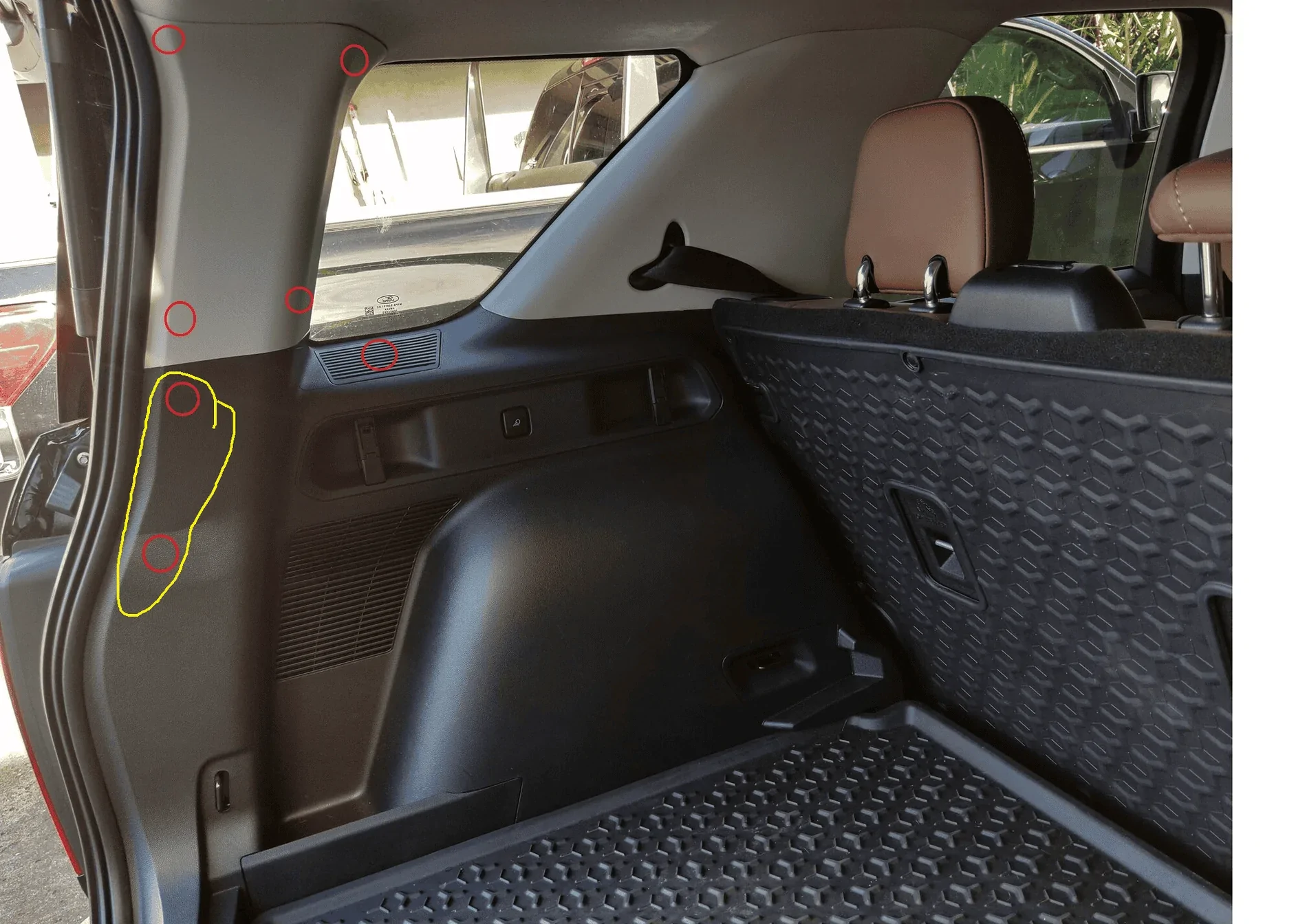

Thanks a lot everyone, I did found the actual flapping noise, I took the whole panel out it wasn't that hard but No need to take the whole panel out to do this, there is two quarter panel vents one located on driver side and other passenger side vents are hidden below I circled in red first picture, all I did is to move the foam inward pushing it in toward the vent yes I did cover the vent with this factory foam, took it for a test drive and no more flapping noise.

Quarter vent Location:
Ford Bronco Sport Flapping noise cargo area IMG_20210918_120241e
Before
Ford Bronco Sport Flapping noise cargo area IMG_20210918_132238
After
Ford Bronco Sport Flapping noise cargo area IMG_20210918_132301

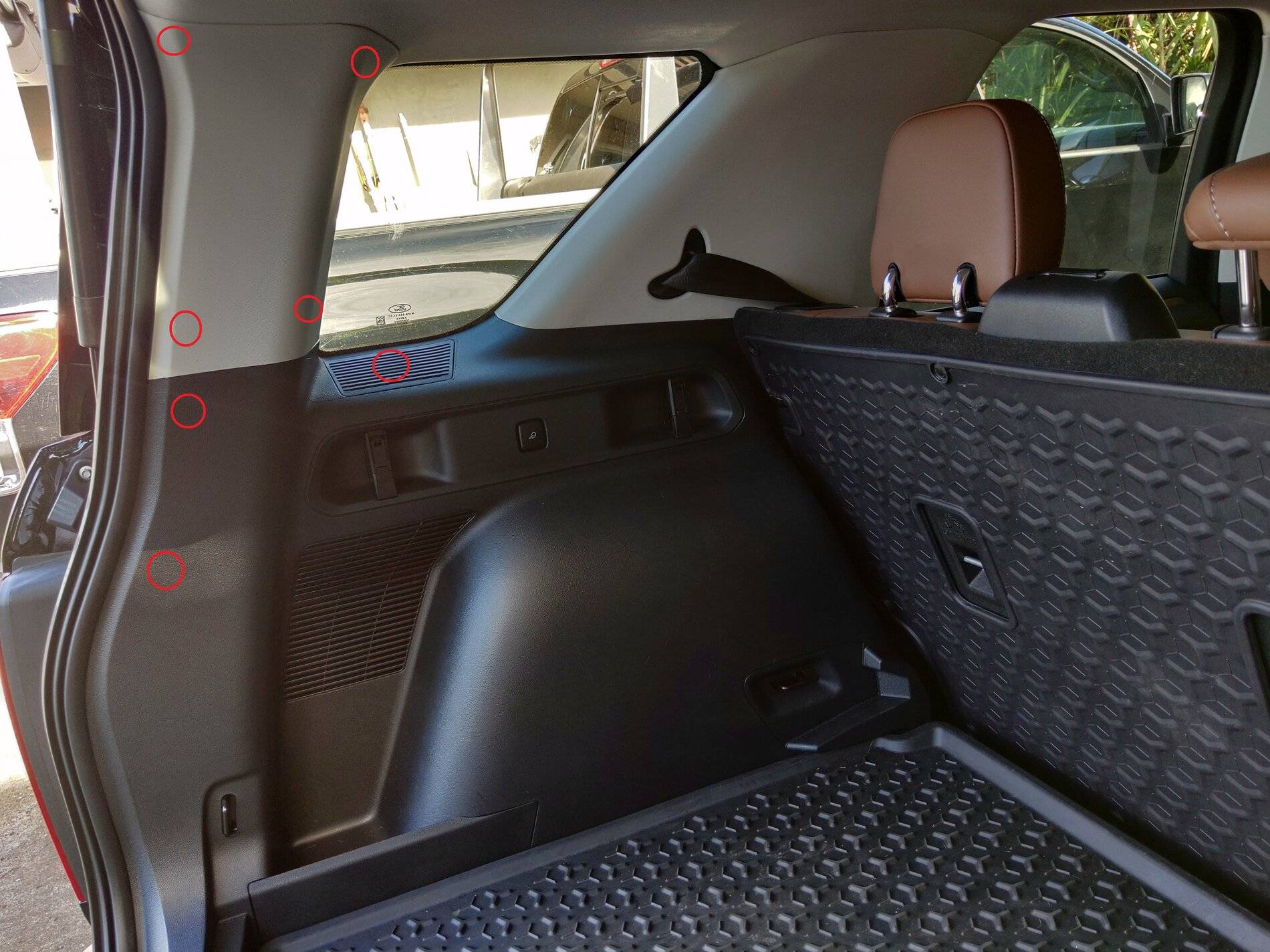

Hello everyone new here, got me a outer banks 2 weeks ago this was dealer order unfortunately had to pay dealer markup it wasn't that bad, so only 400 miles in already had to troubleshoot 2 bugs first was daylight staying on won't shut off after 10 mins and second was tailgate keyless won't unlock using the keyfob thankfully I was able to find these fixes from other members in this forum and now there is this weird flapping noise coming from the cargo area, it occurs while driving 40+mph highway roads, I jumped in the cargo I hear it in these vents on the other side too same noise see video and picture I circled in red, it does not sounds suspension issue. I did inspected underneath for loose plastic or shields didn't found anything loose. I'm thinking sending it to the dealer but anyone else have this familiar noise?
turn up volume a little bit
Ford Bronco Sport Flapping noise cargo area IMG_20210914_170713[1]

So the entire side panel needs to come off?
Not really, there are panel retainer clips and two bolts it will give you enough room to get in there, circled in red retainer clips locations
Ford Bronco Sport Flapping noise cargo area IMG_20210920_084754
2 bolts location
Ford Bronco Sport Flapping noise cargo area IMG_20210920_084815

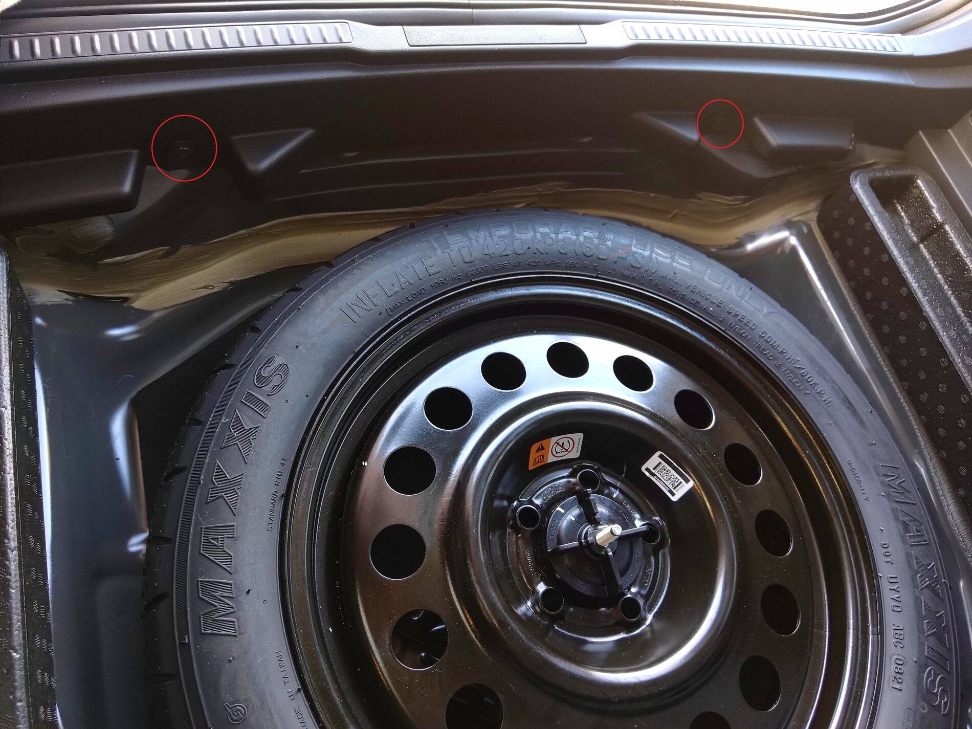

I was able to get in there with just the 2 i circled and the bolts on the bottom. However, the two I circled I'm not familar with as they don't want to snap back in. They are the yellow bolt that goes into the black catch. Any trick to those? I hate trim pieces that I can't just bang on to get back on.

Hmm I had no problems with those, make sure those two yellow clips are attached with the plastic panel and not inserted in the metal.
