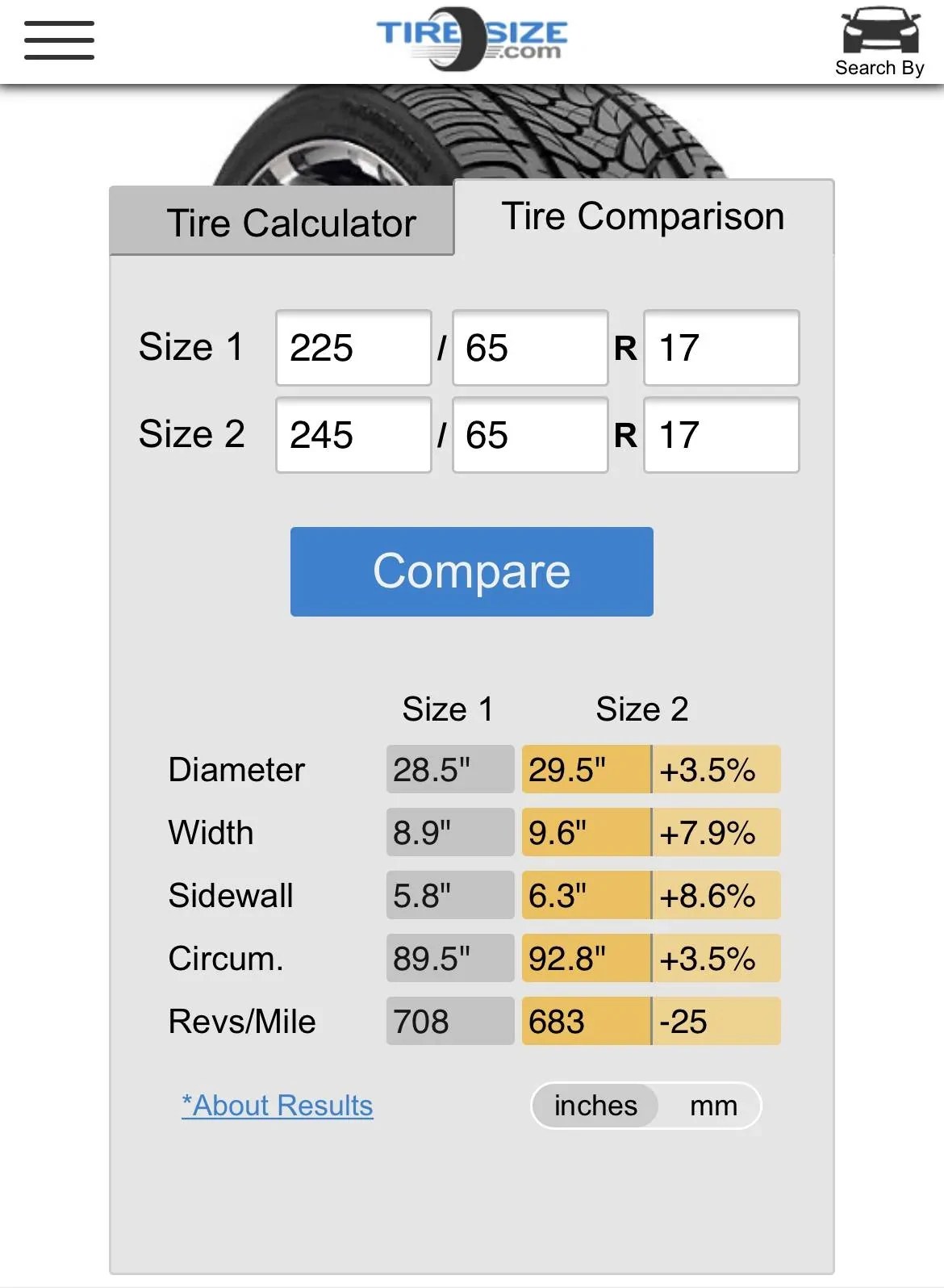

That chart is helpful. Using 0.035 increase in diameter, If you are running 80 on your speedo calculated speed is 82.8. From experience using my Hypertech, that sounds about right. Actual speed is two or three mph faster than speedo speed. Sound right? Not likely enough to get a ticket unless it puts you over the 10 mph cushion most highway cops give. Although a Texas trooper once gave me a ticket for doing 57 in a 55. Yes. There is more to that story. :sunglasses:

Incorrect it’s a mixture between the 3. Changes height and revolutions as well as width
Ford Bronco Sport Falken or bfg ko2’s 43AA1F82-D2F2-4C97-8070-DA905CD2FAB2
Interesting. Thanks for sharing that. Very useful site.

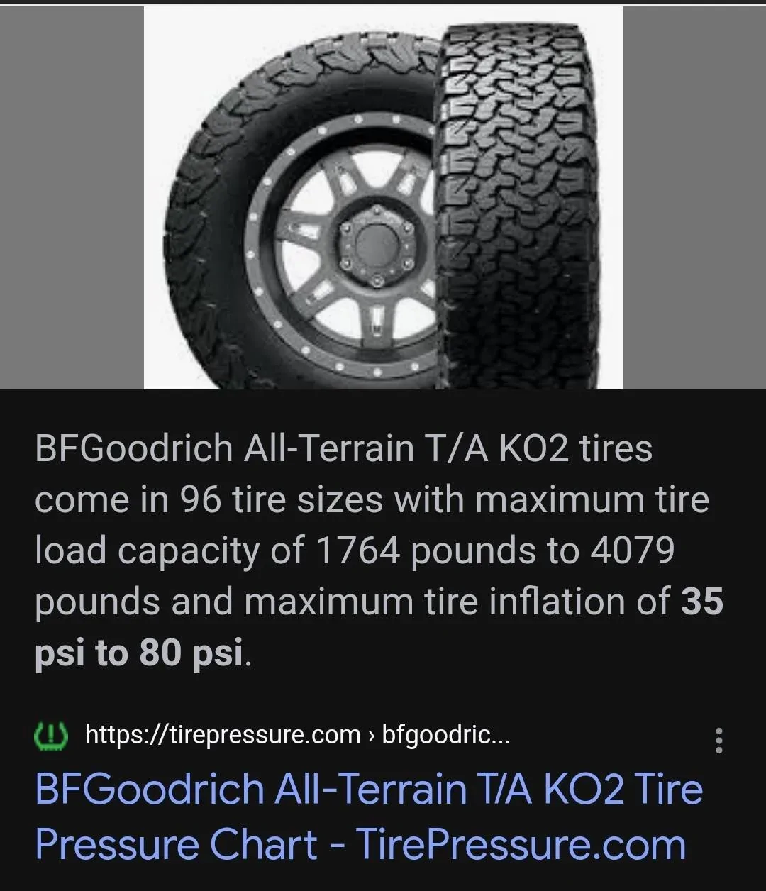

Ford Bronco Sport Falken or bfg ko2’s Screenshot_20211024-102937_Chrom
I saw someone asking about tire pressure for the K02. I found this. I have 3 family members running the K02. I do notice a slight tire sound when riding with them. But nothing super annoying just noticable with your radio off.

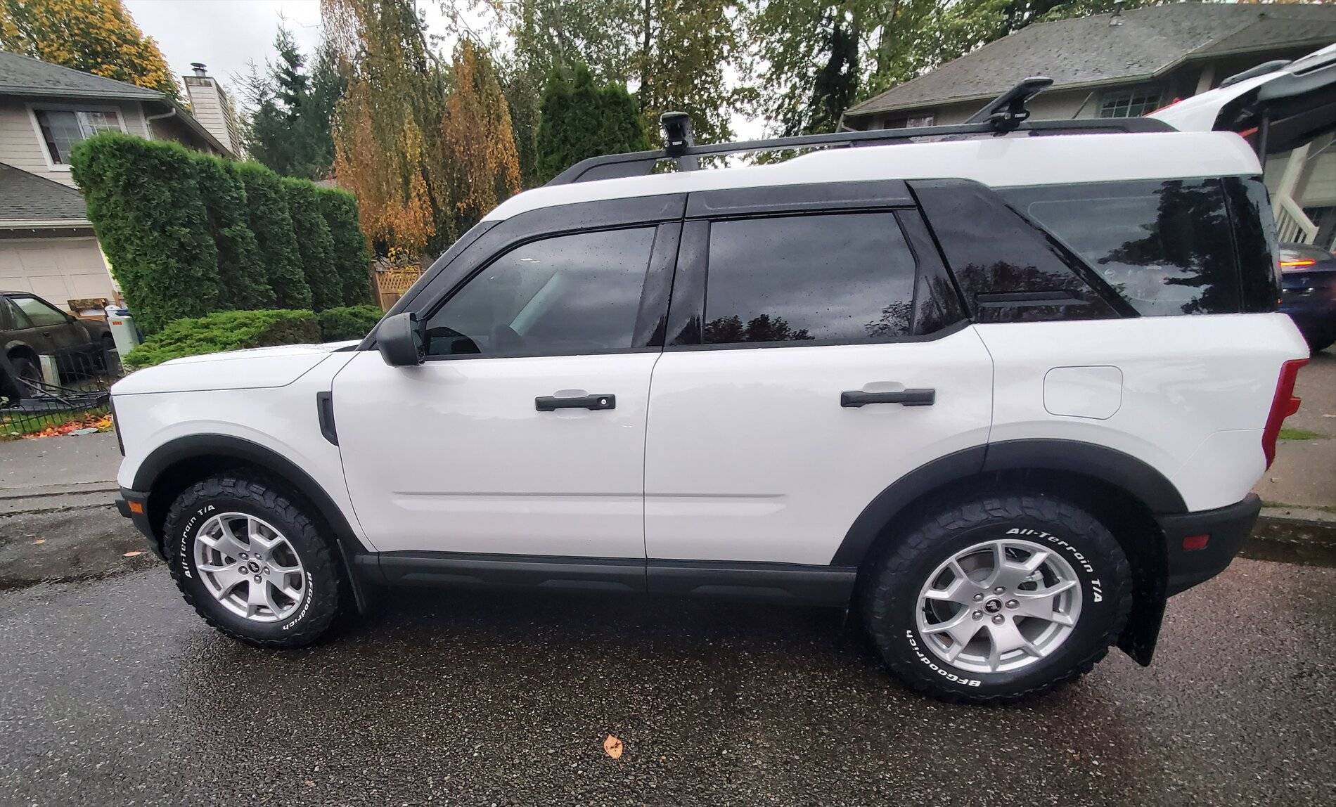

Il drop some pics when I get them.
Ford Bronco Sport Falken or bfg ko2’s 20211025_171630
