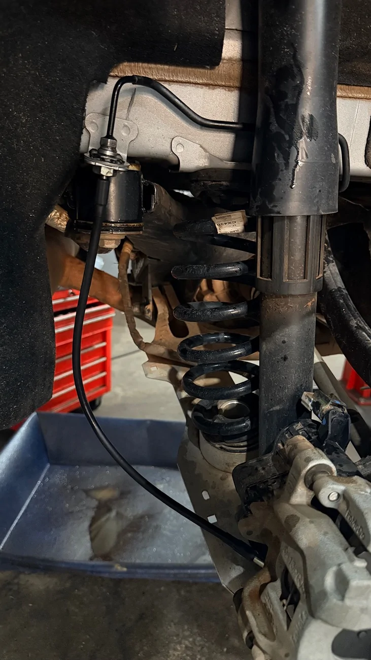

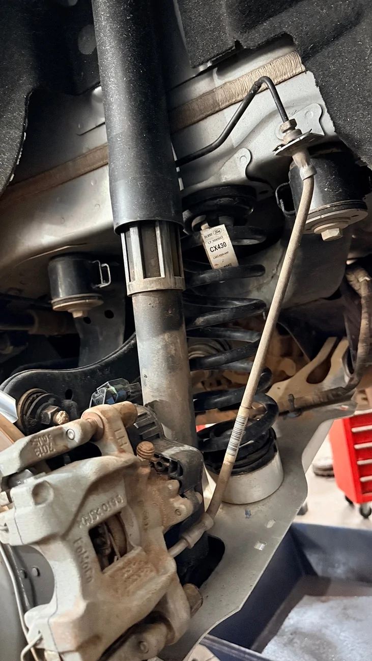

My BS 23 has 1.5” lift with 245/65/R17 Duratrac RT.
I started with the tires only. I liked them but I wanted more: 1.5” lift. No big issues; I just need to relearn to drive in the rain with those tires. No big deals.
The only change I made was replacing the “brake hose” with a longer “PTFE hose with steel mesh” in the rear to avoid the original brake hose reaching its limit when the wheel is in the air — whether doing maintenance or going on a trail with the BS.

@hefler nice where did you find those or how did you determine they would work for the sport?
It was custom made. It was required to go to the shop to see the original one to create this; checking the screws size, etc. Any shop/mechanic specializing in track day cars can make one (at least in Brazil). Since I live now near the Interlagos racetrack, it wasn't difficult to find a mechanic.

Do you notice any more firmness in braking?
