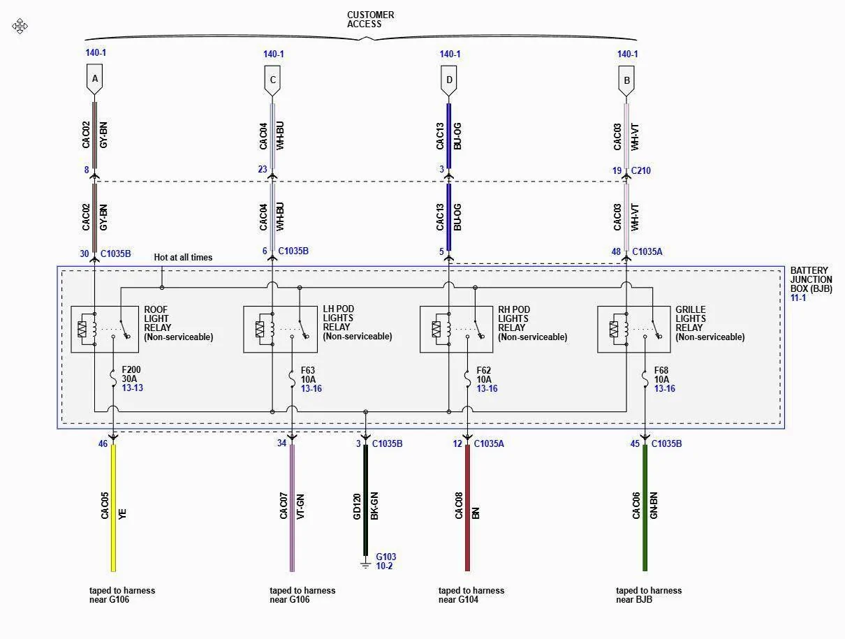

OP posted the schematic in post #14 of this thread. It shows correctly sized relays for each switch. Only switch to relay is 22AWG.

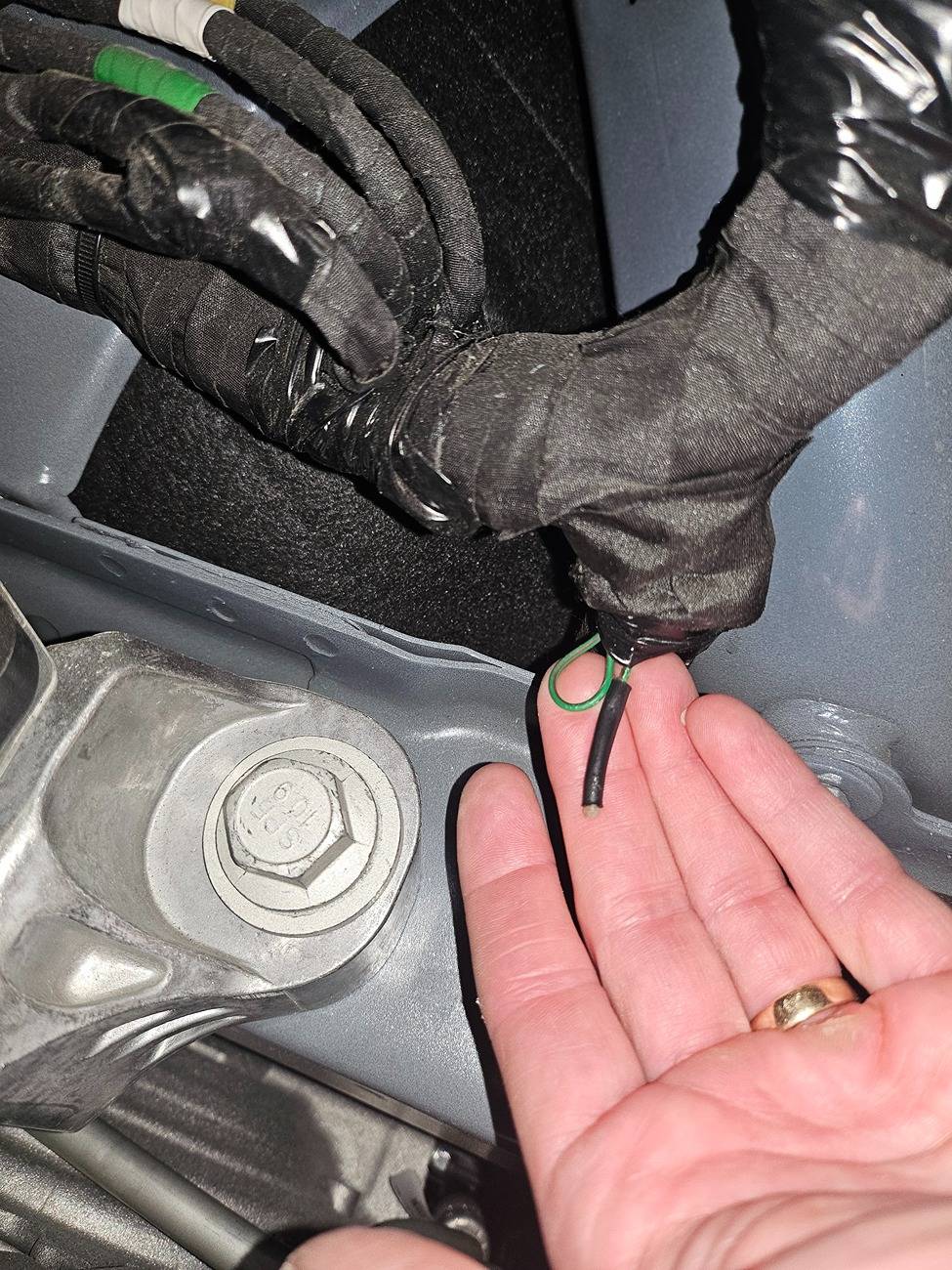

As I awaited the delivery of my Bronco, which is going to spend a bunch of time driving on back roads with an overpopulation of deer, I've been researching how the Aux switches work. So thanks everyone for their input on this thread.
Now that I have the vehicle I can see the accessory wire that is accessible by the BJB (which I think is actually switch B -- the errors in the Ford documentation don't help here!). See photo below. According to the last couple of posts, this is the "thick" wire coming out of the relay, and you should just be able to wire your 10 amp or less accessory directly to it. The problem is that it is not very thick (my hands are small for scale). Definitely 22 AWG. Most Ford products use a 16 AWG or larger wire for this application, which would handle the 10 amp (but not the 30). With 22 AWG I believe you would want to keep the draw well under 5 amps (more like 3 max really). I haven't checked the supposed 30 amp connection, but am not hopeful it is any better. It seems that if you really want to use the upfitter wires for anything more than novelty items or small pod lights, you are going to need to add a second relay and use the upfitter wire just as a signal wire (as Dude above suggested). So basically everyone that has commented recently is right, even when they seemed to be contradictory :)
In the Bronco Sport article (https://thebronconation.com/news/bronco-sport-sasquatch-auxiliary-switches-how-to-use-t.21841/) they mention that they used this strategy -- wired their novelty horn directly, but added relays for their lights. A little disappointing that Ford downgraded the Bronco Sport wiring from 16 AWG to 22 AWG and therefore made additional relays much more necessary than they should be with the in-built relays, but at least we don't have to mess around installing switches in the cabin.
At least that's how I've put this (and a bunch of other posts on the Big Bronco forum) all together. Would be delighted if I was wrong and the "thick" wire was something else. Next up I need to see if the revised fog light position (which has gone pretty much unmentioned) affects the installation of Baja Designs replacement pods. If anyone has experience there I would love to hear it before I open things up.

… Now that I have the vehicle I can see the accessory wire that is accessible by the BJB (which I think is actually switch B -- the errors in the Ford documentation don't help here!)
… The problem is that it is not very thick (my hands are small for scale). Definitely 22 AWG. … I haven't checked the supposed 30 amp connection, but am not hopeful it is any better.
The issue was the 2025 owners manual lists the wire size and the Aux circuit Amp ratings but fails to mention anything about relays (assuming relays actually are installed by the factory for specific 2025 Bronco Sports)
Owners Manual info posted by @ELCouz:
https://www.broncosportforum.com/forum/threads/bl-sasquatch-aux-switches-wiring-guide.13923/post-233178
Pic in post #14 posted by ElCouz showing relays and the rated fuses:
https://www.broncosportforum.com/forum/threads/bl-sasquatch-aux-switches-wiring-guide.13923/post-246139
Your pic in your post showing the wire gauge size being small would support what the owners manual states but then pic #14 seems inconsistent with that
You are right that the supplied documentation from Ford is inconsistent with posts in various online articles about actual installs using the Aux switches

They are all under relays with different fuses sizes.
I wired AUX1 and AUX2 so far. I am waiting for my ditch light brackets from @FordBroncoLifts ?
No need to install additional relay IF the load is within spec and the wire is very short.
I did for AUX2 because I installed reverse lights that was close to 100w ...too close from the little 10A rating and I had to run the wires until the back of the BS.
Ford Bronco Sport Does anyone have a tutorial video or photos for the aux switch wire locations for 2025 Bronco Sport 20250722_091306
AUX1 (30A) is 18AWG. I've measured. The one you are showing is close to 21AWG. I measured the diameter.
Ford can get away with it because of the short wiring and 105c rated wiring.
AUX1 can go 15-20A continuously if the wire is short, if you need a long run use thicker wire at least to prevent voltage drop. I would go minimum 14 awg.
For ditch light normally around 50-60w each it's fine. But don't go near 10A continuous load, more like 6-7A max!
