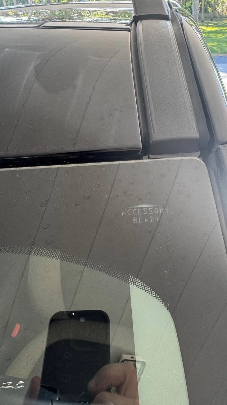

Keep in mind, I have only owned my bronco for a few days. Just saw this when you started talking about the attachment points. I am going to use this for a light bar. Thanks for pointing this out.

Right but I was not discussing that specific Accessary Ready on the A pillar
I referred to the Ford "Accessory Ready" points which are bolt locations making it easy to bolt up items
Located around the vehicle on some 2025 Bronco Sport models and packages so don’t know if these bolt locations are on yours
The pic I posted should show some of those bolt locations on the front bumper and more around the vehicle maybe if applicable to yours
Do you want to post a clear pic of your front bumper and rear bumper?

I see that, I checked mine out and there it is on both sides. I'm getting a rack on mine next week so not sure I can use those accessory ready spots. I wish Ford had the new accessories first, hope they don't drag them out.

There is a PDF posted on the forum which is for the accessory ready on the A pillar for ā€˜21-ā€˜24s (for running wiring down the channel), might be similar for the 2025s
I can locate that PDF link if you want. It’s quite involved to use it as the PDF shows

Actually, I just found it. IT IS CRAZY! You have to disassemble half the car to get to it. That is NUTS. I do not consider that "Accessory ready"!
Perhaps easier on 2025s !! ??
