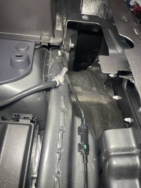

Thanks, I've read all these. I can see directly behind the wheel well liner from the engine bay. I even used a mirror to look under the supports. I see nothing. I might still take the wheel well liner off just to make sure. It would be crazy that they would bury them in a place you can't even see!

The post I linked to did say to remove both front tires and fold back the liners:
…we were able to remove a couple of the securing clips and by carefully folding it back to expose the wires, we did not have to completely remove the liner but we did have to remove both front tires. (Use jack stands and extreme caution when working in this area!

I finally got a video of accessing the wires. I’ll post it as soon as I get permission from the awesome member who took the time to video it.

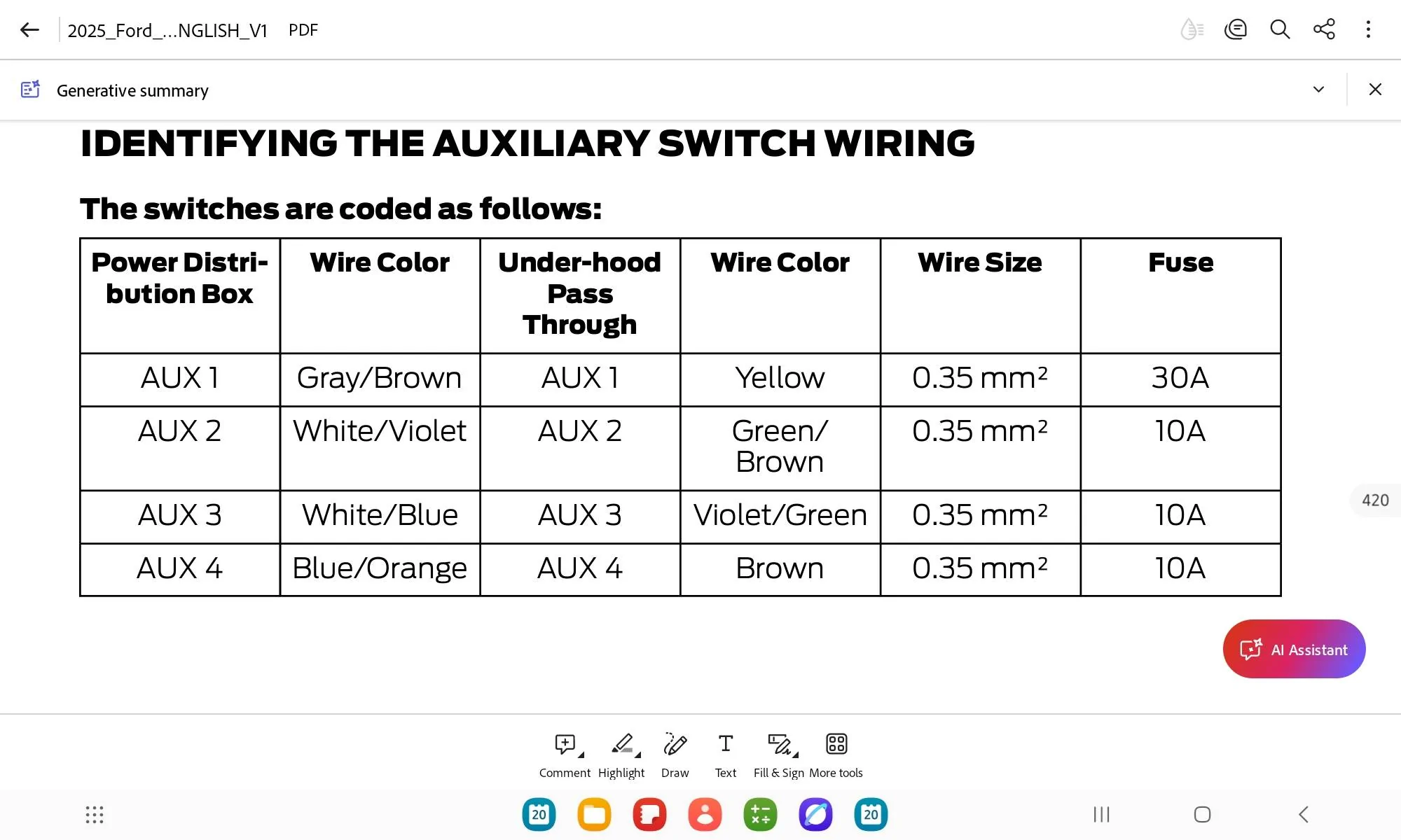

Looking to add some light options to the aux switches. It looks like from the link to bronco nation (https://thebronconation.com/news/bronco-sport-sasquatch-auxiliary-switches-how-to-use-t.21841/) they are pretty hard to locate/get at. I was hoping that someone has done it already and can give some advice, photos, or videos. Thanks!
Ford Bronco Sport Does anyone have a tutorial video or photos for the aux switch wire locations for 2025 Bronco Sport full?fromcc=1

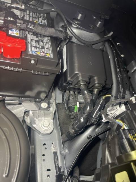

The easiest to access is the one noted as 'D' in the picture from the manual. Just unwrap the electrical tape in that location, and there's the wire. The wire at that location on mine was green/brown, which is Aux 2. The other locations require removal of wheels and are behind the inner fender liners, from what i understand.
Also, the full-size Bronco and the trucks have a relay box for the auxiliary circuits, but it looks like the Bronco sport is just fused, with no relays installed?

Thanks for the info. Yeah. I found all of them eventually. No need for relay when you are dealing with low power items like LED lights. Switch and fuse work just fine.

Switch 1 is 30A and 2-4 are 10A each, so yeah, most modern lights should be fine. If one wanted to exceed that, then adding a relay in line on that circuit isn’t a big deal.
I agree on the 10A circuits, but on Aux 1 (30A), I wouldn't want 30A running through the switch and 22AWG wire... 22 Guage wire is rated at 7A in open air, and 5A enclosed (in a harness).
Ford Bronco Sport Does anyone have a tutorial video or photos for the aux switch wire locations for 2025 Bronco Sport Screenshot_20250720_063040_Adobe Acrobat
So, based on the rating of the wire used for this 'upfitter' switch system, I would use relays for all switches, and consider them as 5A switches. They are not 10A switches or 30A switches, they are 5 Amp. Ford has done all of us a disservice, and possibly caused melted wiring. Not cool.
