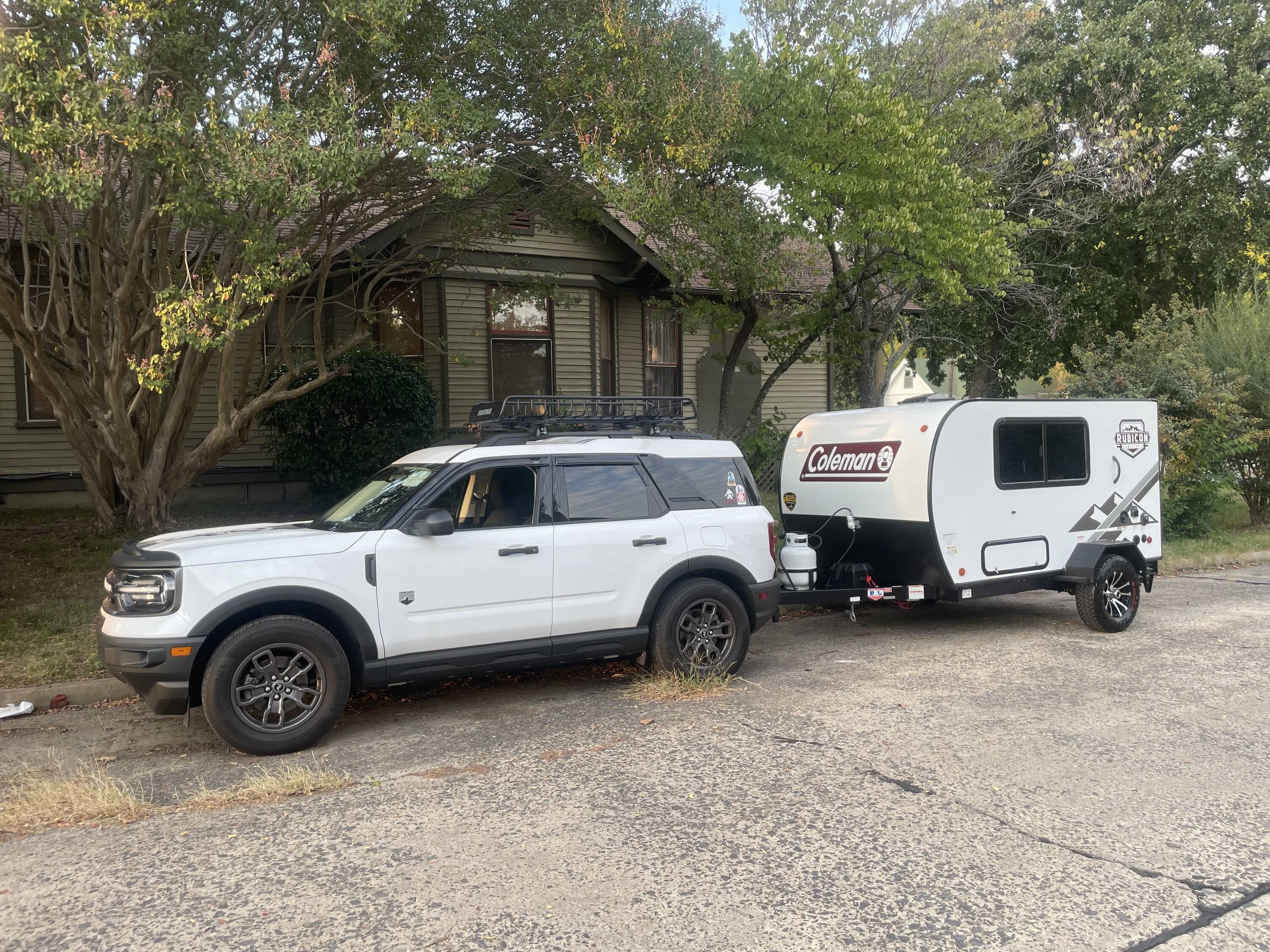

I've used my Badlands to tow my small 18' Airstream, and it tows just fine. The weight is right at the towing limit. The trailer has electric brakes, and I have a brake controller. Manufacturers are always conservative with their ratings, so I wouldn't worry as long as you don't go much over it.
For some reason, the BL with the 2.0 liter engine has the same tow rating as the smaller-engine models, even though the Maverick with essentially the same drive train is rated to tow up to 4,000 lbs. It must be the short wheelbase rather than any drive train limitations.
The Maverick has a 4 k tow rating only if you have the 4K tow package with the 2.0 l engine. The package includes bigger transmission and oil cooler and has a different gear ratio. The 4k package is not available on the Bronco Sport as it has the 4 wheel drive upgrade.

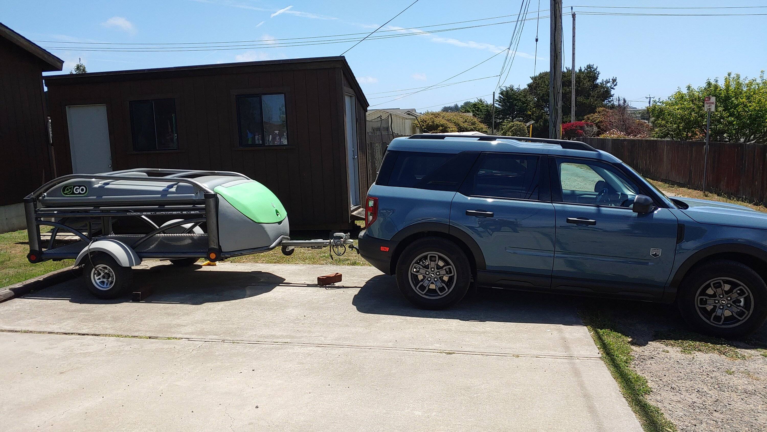

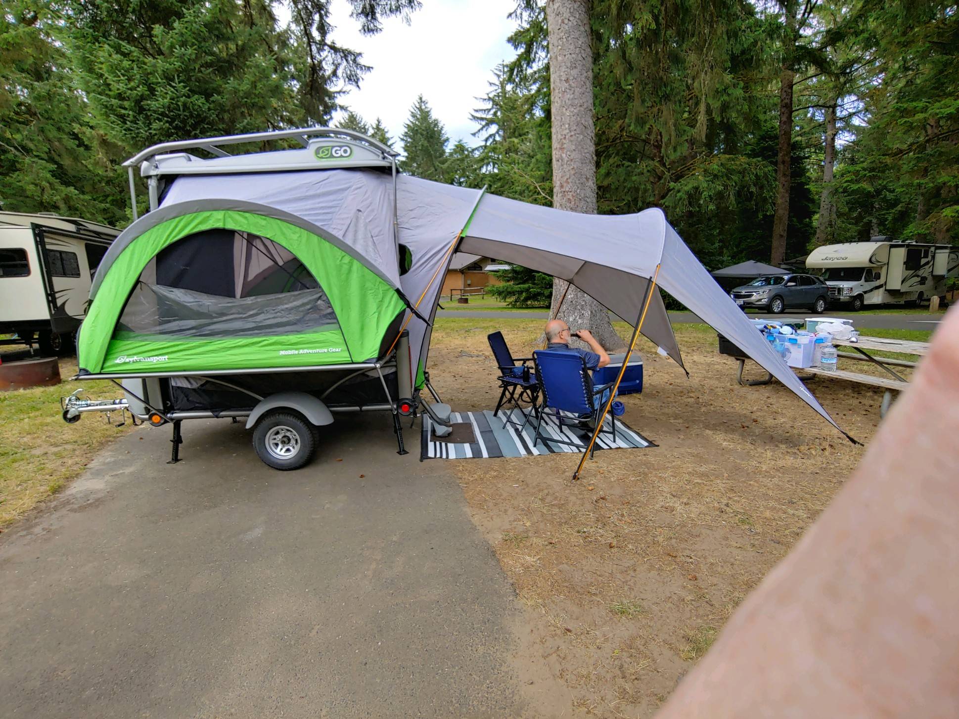

Sylvansport Go utility trailer & tent camper. 860 lbs. top (tent) can be removed or raised to use as utility, bed is 4x7, tilts to load quad or motor cycles.

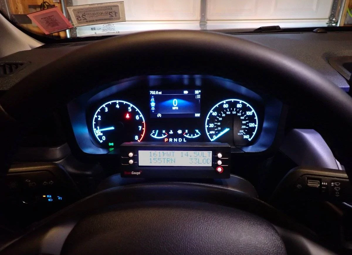

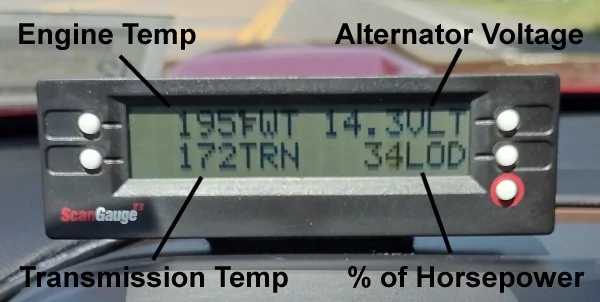

My Sport with the tow package towed my 2K camper... just. The transmission heated up too much on long grades. I put in a gauge to watch it. Switched to the Maverick with 4K towing, beefier suspension, lower gearing, larger tranny cooler, radiator, and fans. Measuring at the wheel well, my Sport squatted 2+" with 200 lbs. on the hitch and the back loaded with gear. The maverick barely squats .5" with 245 lbs. on the hitch and loaded with the same gear. The temp gauge hardly moves on the hills. There's no way I'd tow 2k+ in the mountains with a Sport.

Very, very cool. If I did not already have an RV, I'd have this!
