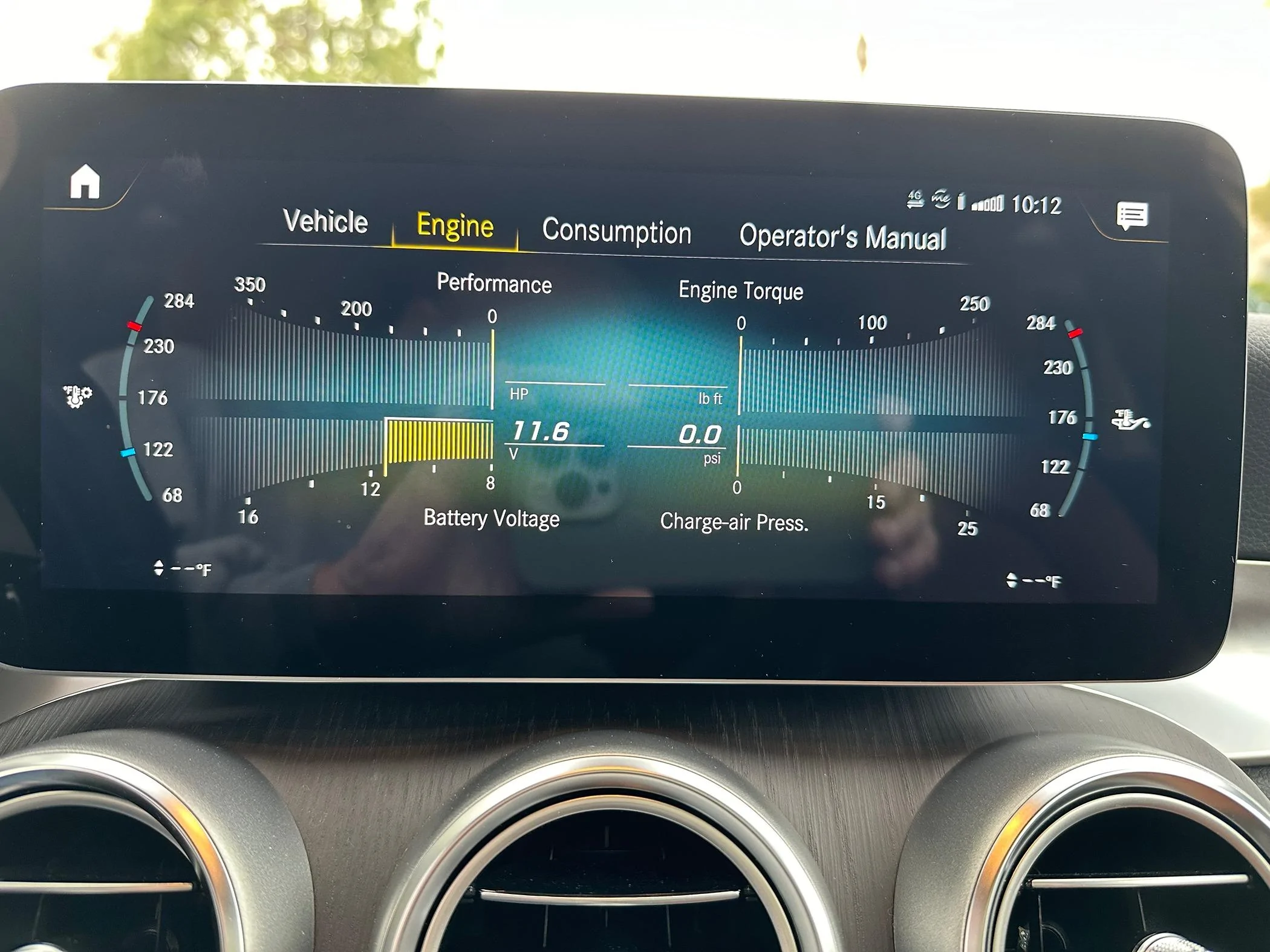

Instead of baffling us with BS and electronic gimmickry, why not simply include a volt meter so we can see what’s going on with the battery at speed and at idle. Seemed like a decent and useful feature in vehicles for 8 or 9 decades prior to this…. No?
And while I’m at it…. We shouldn’t have to buy battery tenders and/or plug in volt meters, to maintain and monitor battery health; especially for new vehicles that are driven regularly, unless operating way outside of normal driving parameters.
but…. That’s just my 2 cents
Engine parameters available on the center screen of my wife's car.

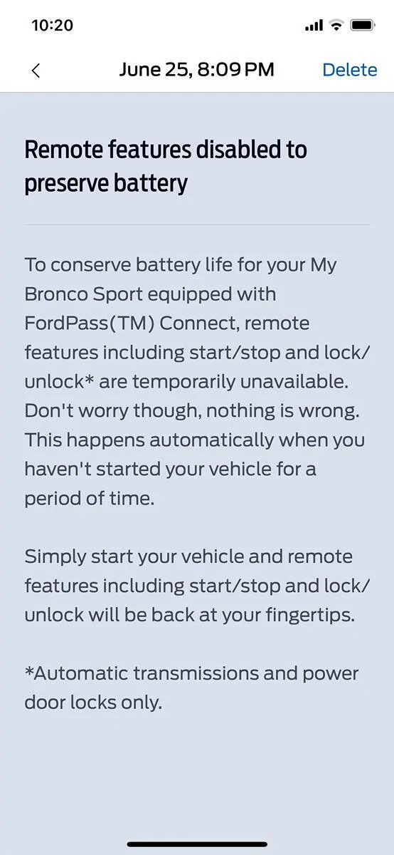

recall done 1 wk ago, driven about 400 miles and parked this past Monday. Two days later (yesterday) I get this message from Ford:
Ford Bronco Sport Defective Battery, Recall 24S24 and other topics IMG_3330
Restarted with no problem. Not sure what to think of this. Is the gizmo too sensitive now or is this an early warning or what?
That's the message your car send out via the FordPass app when it determines battery power may be compromised. Your car is over 3 yrs old, and you live in Hotlanta, so it's entirely possible your battery is reaching the end of its life. I recommend, however, before you buy a new battery that you contact your servicing dealership and ask them what you should do.
