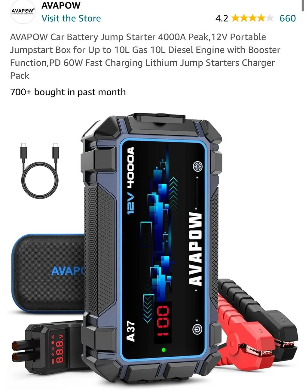

That’s a decent jump starter with a good working temp range (Work Temperature: -20 ā„ƒ ~+60 ā„ƒ / -4℉ ~+140℉).
where I’m at, the vehicles inside temp can exceed 150°F so I’m looking for a product that is spec’d to ~160°F storage temp.

When discussing these lithium jump starters in the past, I've wondered if there are any potential storage spots that are cooler?
Glove box; trunk (N/A for BS of course); under a seat?
I've never measured interior heat at various locations, but I imagine that under a seat is at least a little cooler.
Here's some info (FWIW):
https://www.researchgate.net/publication/259577084_Temperature_variations_inside_a_parked_car_in_hot_and_dry_climates
I couldn't find anything that looks at temperature in various locations inside the vehicle -- other than the above study that mentions:
"Four thermometers are used to measure the temperature at front dash board, rear board, front seat, and rear seat."
Anyway, what I'm getting at is that maybe 140*F is adequate, if stored (say) under a seat.

Last time I checked into the vehicle inside temp, the variance was no more than a few degrees F.

Bummer.
I was hoping there would be some stratification.

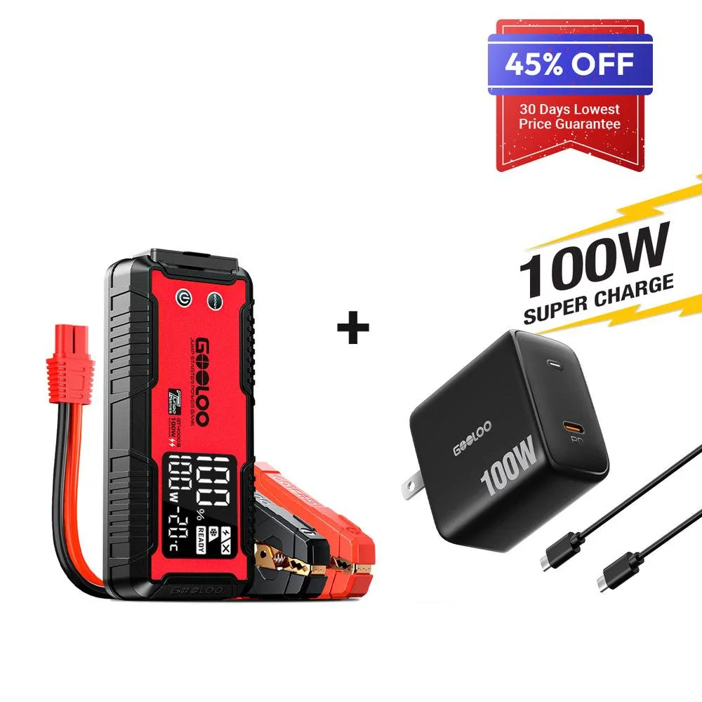

Since y'all are talking about jump starters, I'll throw this one in, I keep it in my F350 Platinum 6.7 diesel:
Ford Bronco Sport Defective Battery, Recall 24S24 and other topics 1000013273
https://www.amazon.com/GOOLOO-GT4000S-Fast-Charging-Portable-SuperSafe/dp/B09M9HQG73
It's rated to start a 10L diesel as well, 100 watt LiPo. Again it's -4 to 140°, but it can warm itself up in extreme cold. It has large clips on the wire. Charges insanely fast at 100w. I keep it in a case in my truck, learned the hard way when both of my truck batteries died in a fueling bay coming back from vacation towing my RV. I had to be pulled out of the bay into the parking lot and spent the night there (thanks to the RV generator) until I could get the truck towed for service. I haven't had to use it since but it's very highly rated.
