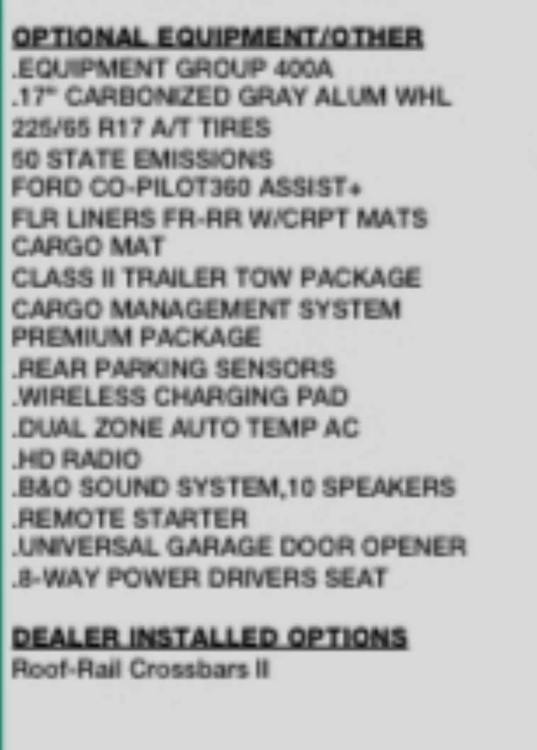

Just curious… do you have a 22 Badlands without the Premium Package? Or you have the Premium Package and just no CO-PILOT360 ASSIST+?
Here’s a portion of my window sticker:
Ford Bronco Sport Defective Battery, Recall 24S24 and other topics IMG_0777
From post #126 (my reply to you):
"Does your BL have any optional packages? The reason I ask is that I see the "35 MPH"" speed limit sign in Engineering Test Mode, which, IIRC, is part of an optional package. Ours only has the tow package and roof cross bars, otherwise it's a base BL."
We drove the salesman crazy. He tried desperately to get us to have the Badlands gold-plated, but we insisted that the cactus grey paint was fine. :cool:
Seriously, neither of us were very interested in any of the features in the packages, but he kept pushing them. "Only chumps and losers do not order everything I recommend!" For us anyway, they seemed way overpriced. For buyers who really want most/all of what's included it's probably worth it but not in our situation.
The Badlands replaced my wife's '97 RAV4, so it was primarily up to her. She and I both thought the tow package and the cross bars would be useful, so we got those. She wanted the fender flares, but in another case of attempted stealership fraud, we were told that the price did NOT include installation, although Ford's website clearly said it did. Installation cost was said to be a huge mystery! The body shop had supposedly never worked with the fender flares before, so we would have been on the hook for whatever they wanted to charge. Needless to say, we deleted them. That elicited a very concerned/puzzled look from the salesman -- as if we were making some huge mistake.
Anyway, maybe our lowly base Badlands does not have ETM? :frown:
"Ours (2022 Badlands) only has the tow package and roof cross bars, otherwise it's a base BL”
I don’t know why your 2022 Badlands does not have the ETM feature while my 2022 Badlands does.
The apparent differences between mine and yours .. is mine has:
CO-PILOT360 ASSIST+
The 2022 variant of the Premium Package.
Maybe @Mark S. has an idea why ETM does not work on your 2022 Badlands?
