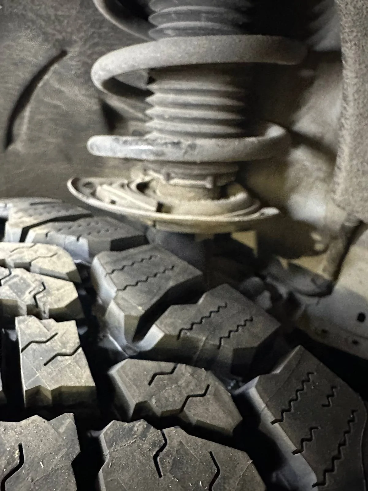

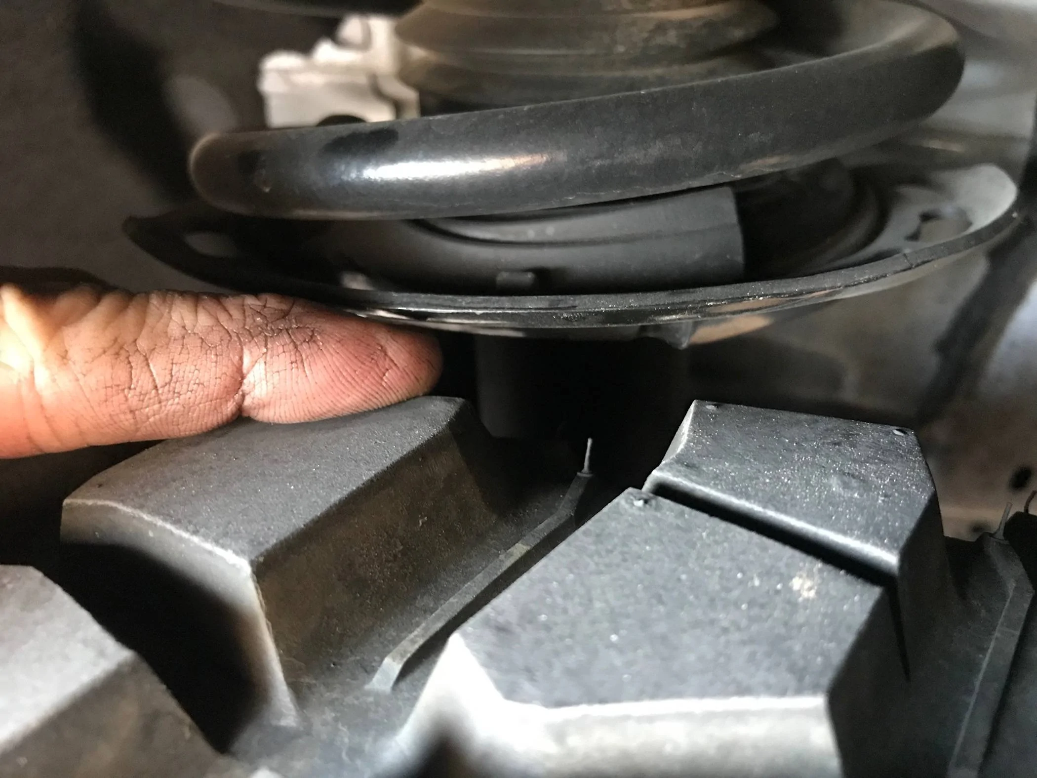

you will need spacers 2” so it will not rubbing with the spring seat , but it will be nice to see some pictures

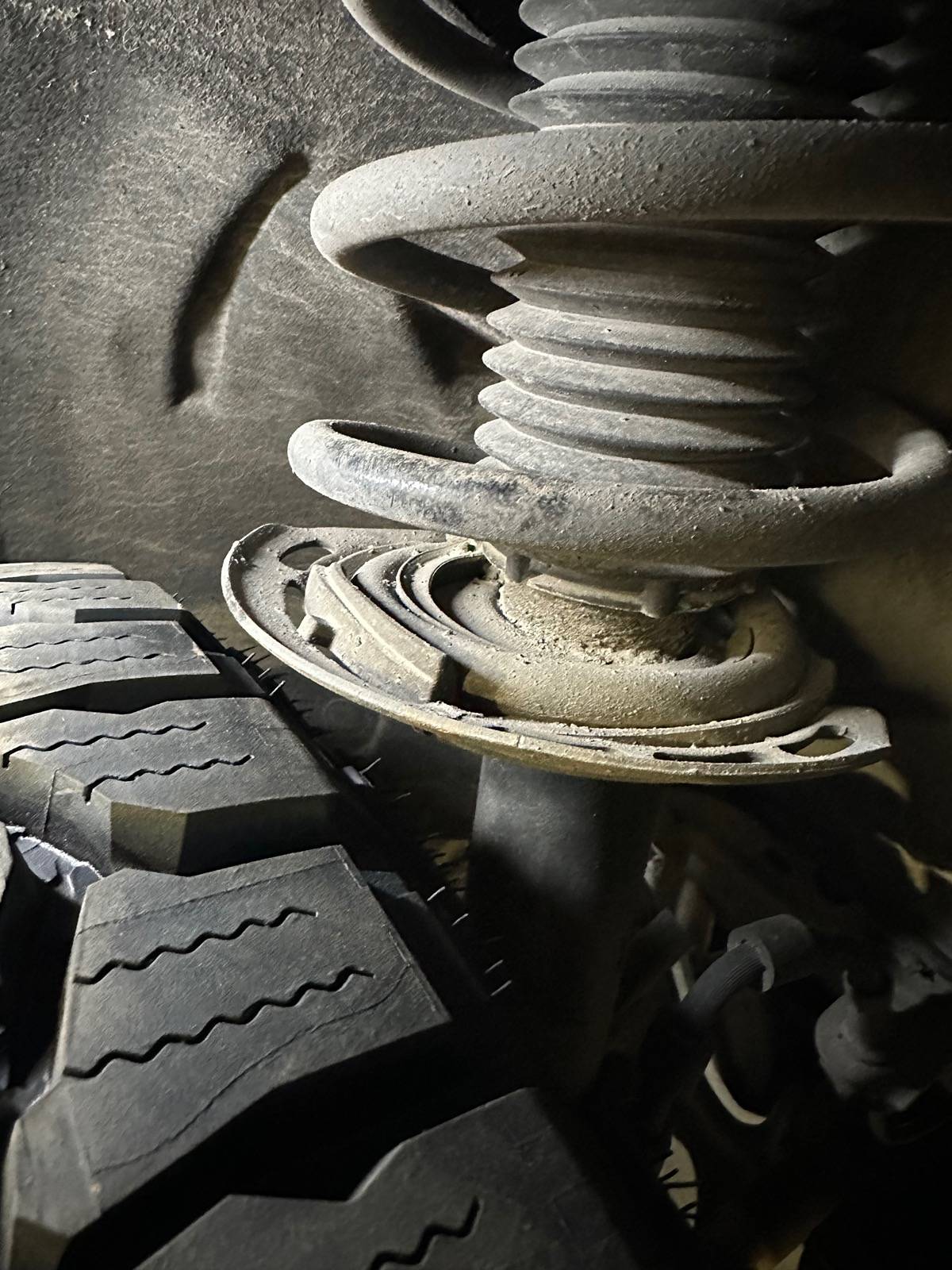

The 255’s will likely rub at full lock, with or without a lift. There is a pinch weld at the back of the front wheel wells that limits the tire size. Some have gone to the extreme of cutting that flange but that is a questionable decision on a uni-body vehicle. You just don’t know what kind of structural changes you are making by cutting that flange.

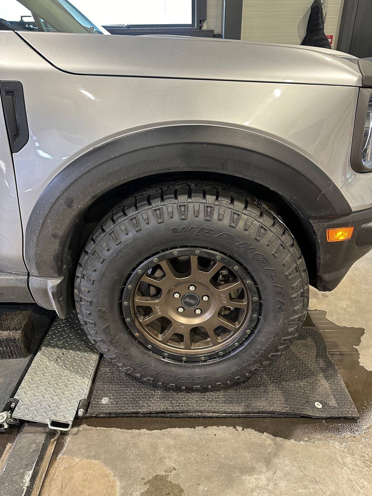

255/75/17 is a 32” tire. How did you get past the 29.5-30” max tire size restriction?
Rhel
Rögnvaldur
May 18, 2023
114
289
Iceland
www.facebook.com

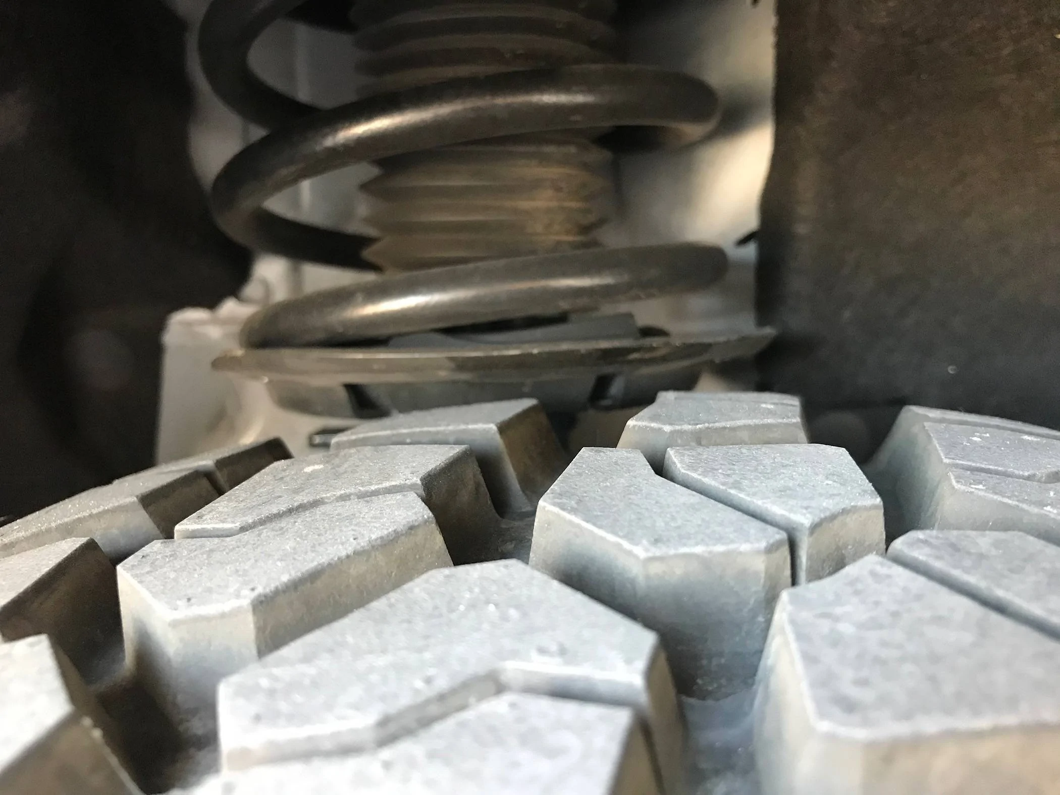

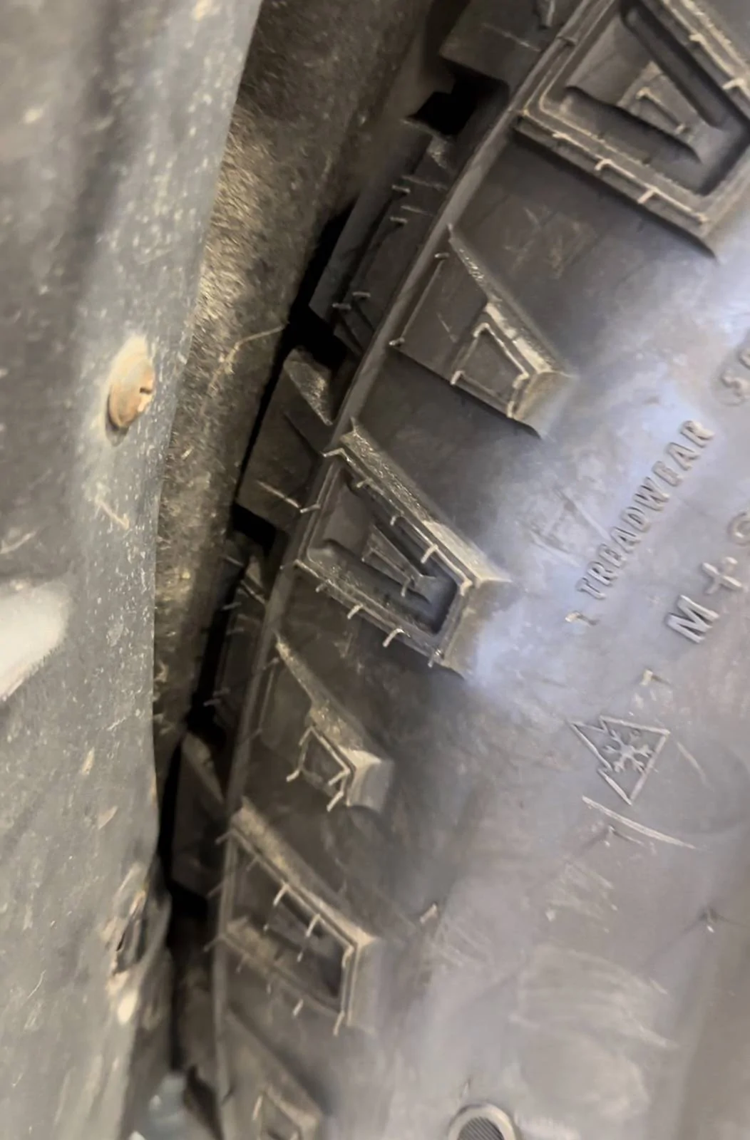

Yes you are correct , it’s very tight fit, they are rubbing lightly in the covers
I think I will go for 255/7017 instead so it will not filling the space in winter time

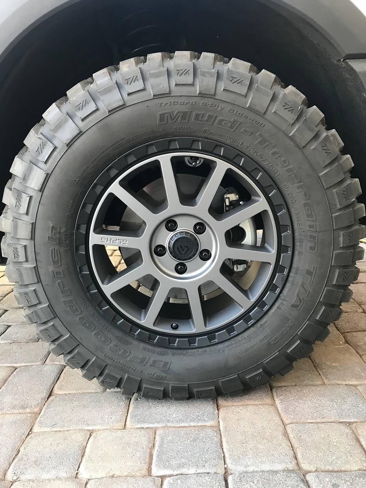

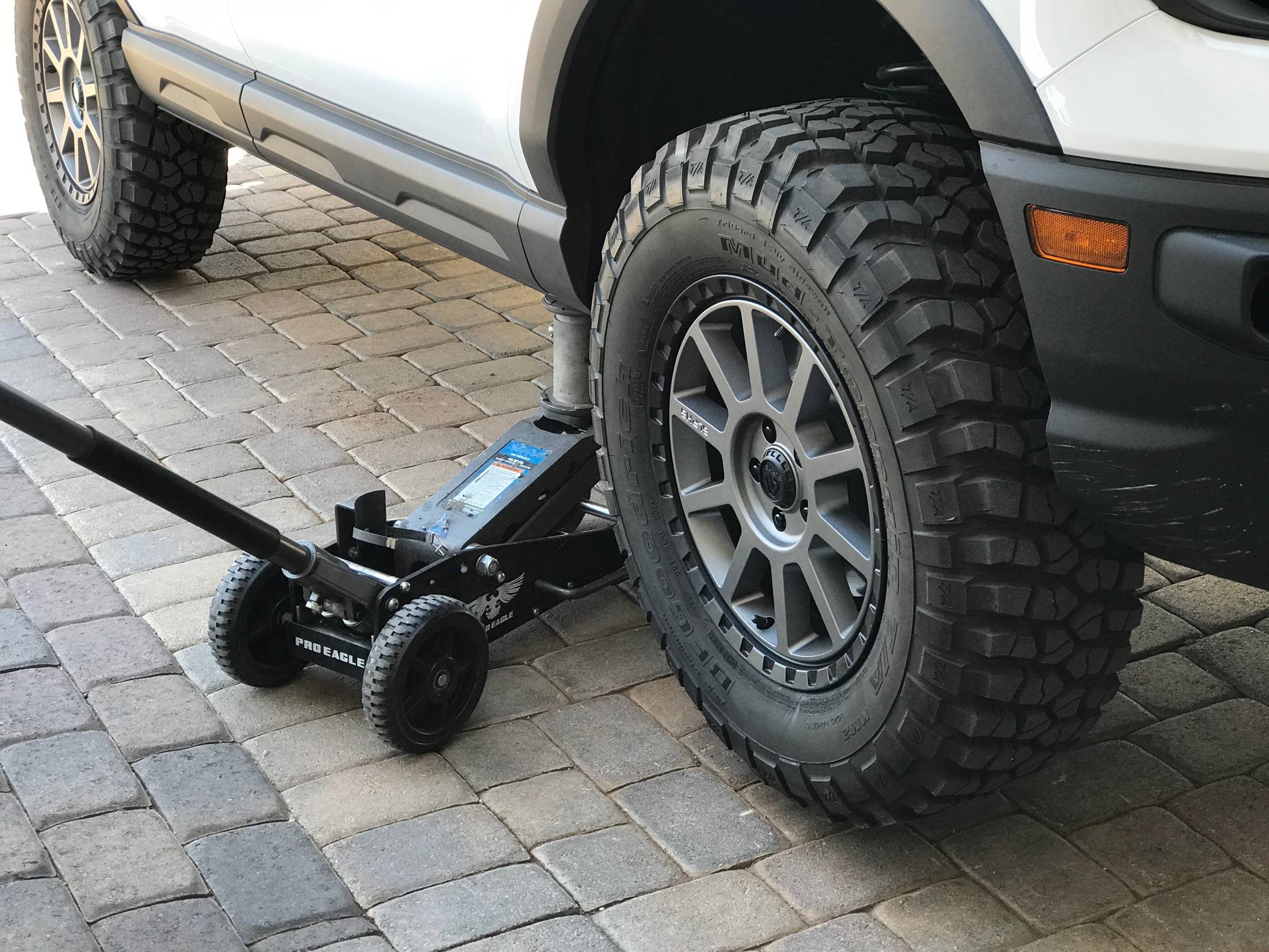

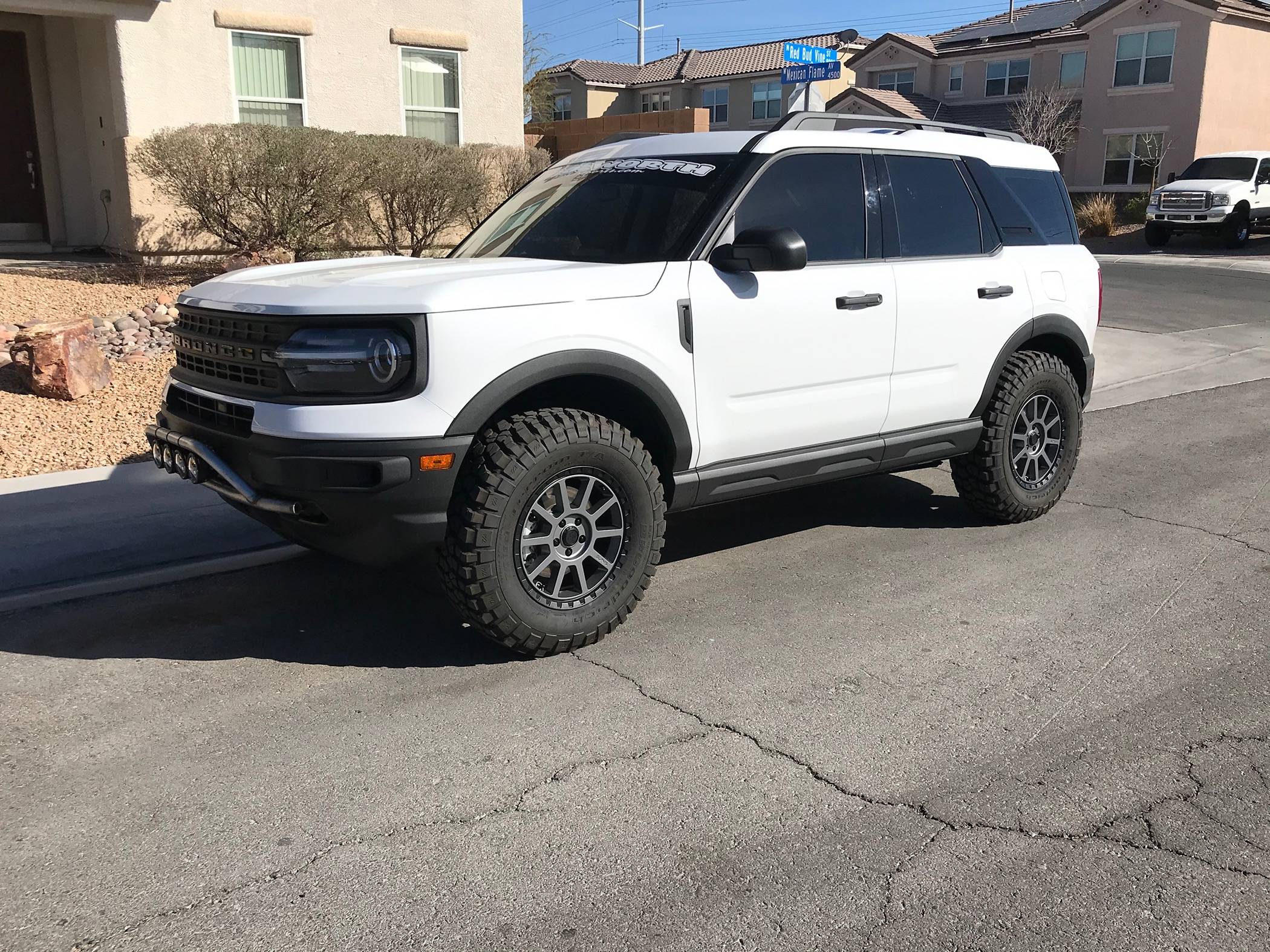

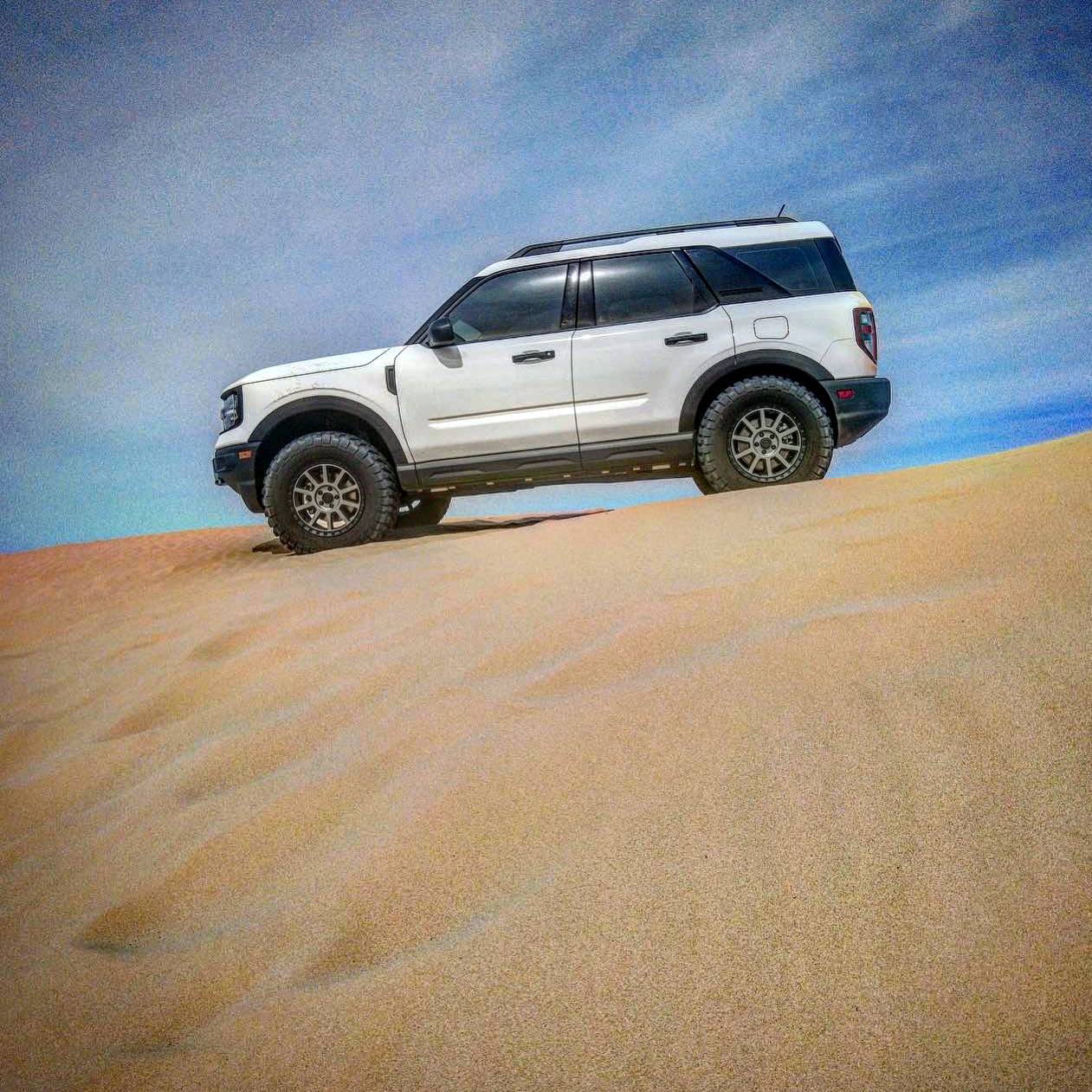

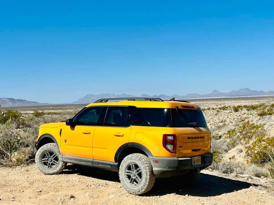

Yes. The pinch weld mod needs to be done with any tire over 30.5” with or without a lift. The design of the wheel well won’t allow. Best handling and best looking was the 255/75/17 in my opinion.
