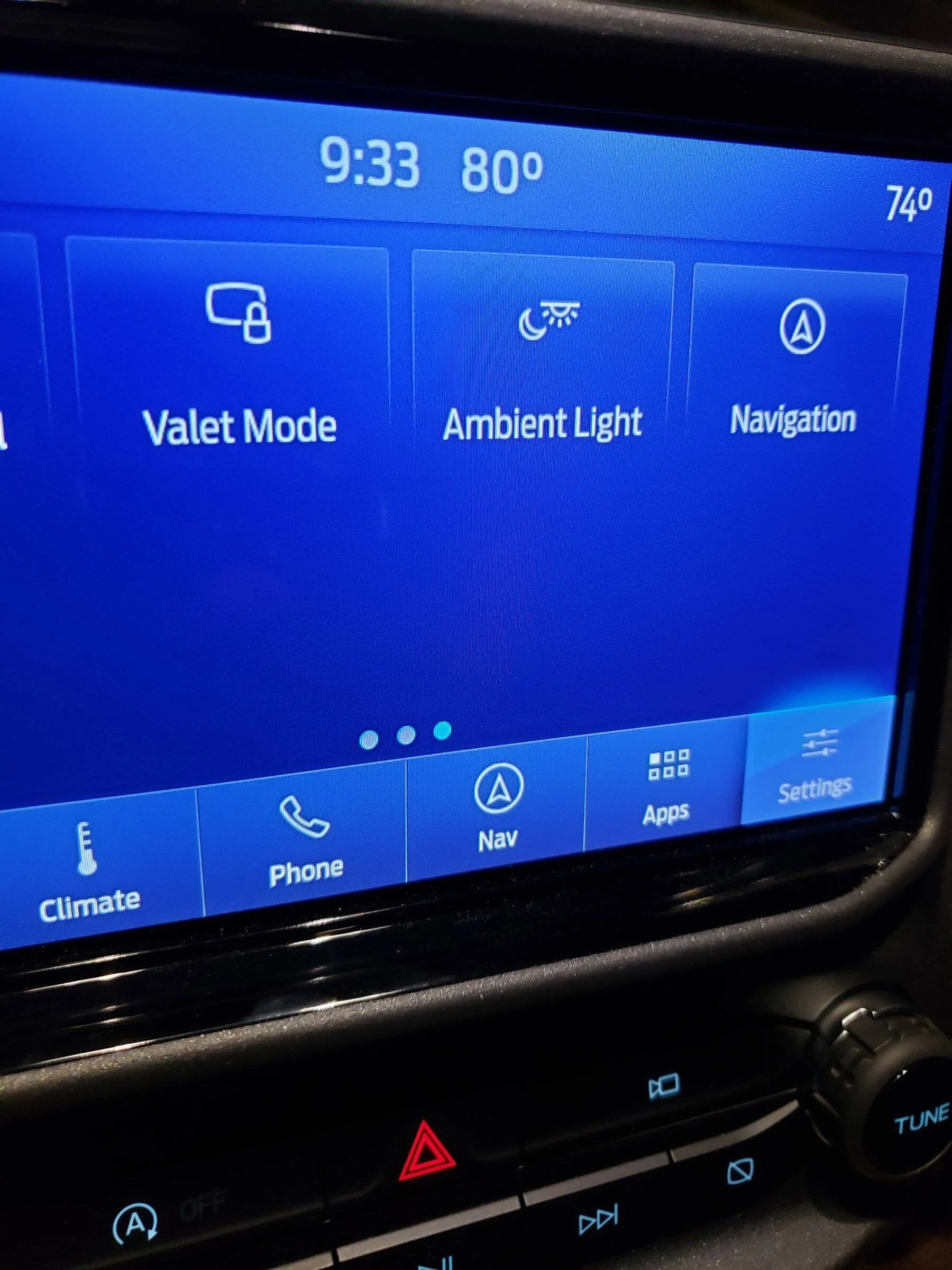

I've checked. Module supports ambient lighting (I even have the color buttons enabled on screen), and looks like the various led mounting points are in place...
Can you be more clear? Which module do you mean?

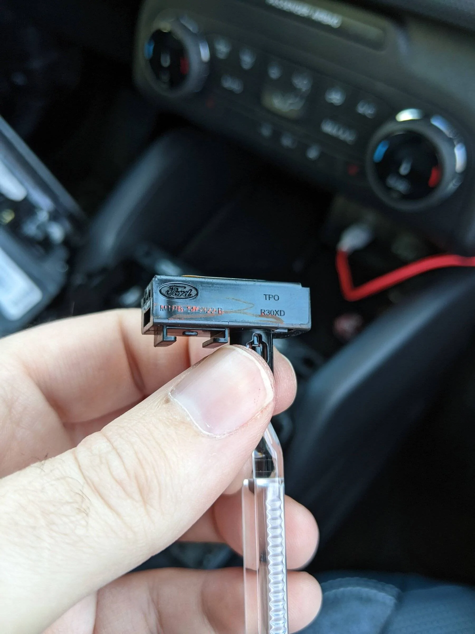

I'm after the footwell lighting (and maybe the cupholder)
It's a start...

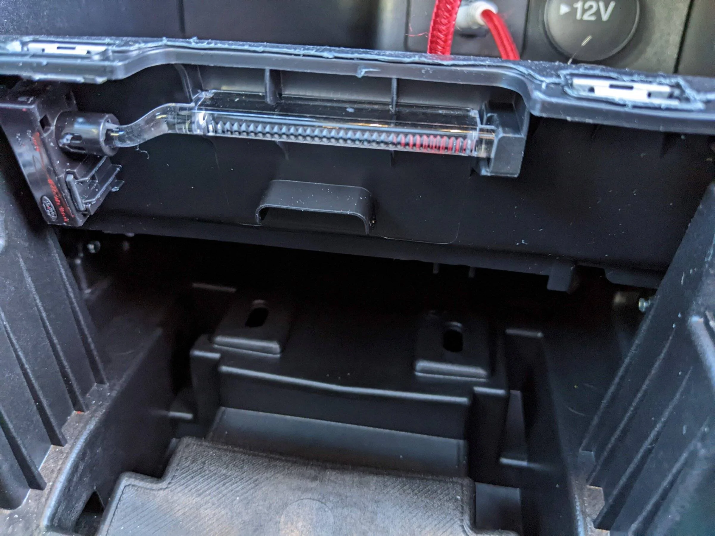

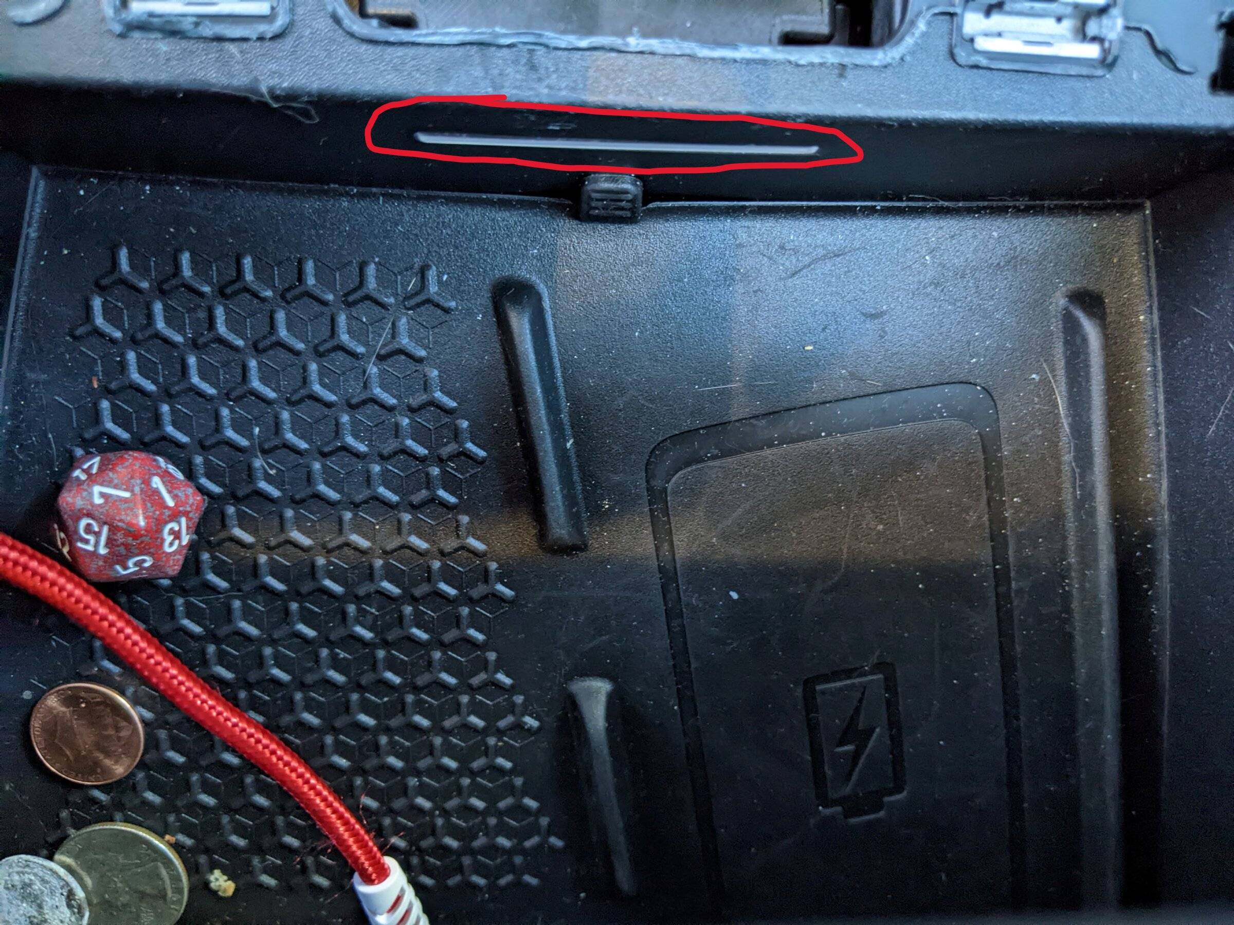

Anyone notice that when you remove the console cover, there is another spot at the front for ambient lighting in the phone tray? There's even a dummy light diffuser for it!
