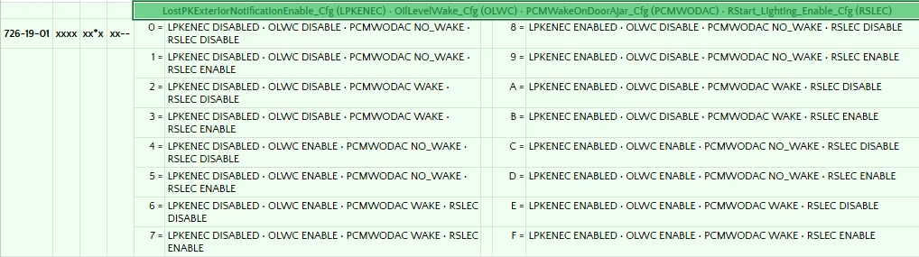

It is disabled in your BS in th BCM. Pulled the config from two other 2025 BS and it is also disabled. For sure it is enabled on my 2023, so maybe Ford changed it for the Sync 4 Bronco Sports. Good, because it is annoying af. If you do have a 21-24 that does it, you can easily turn it off in the BCM by disabling LPKENEC:

Good to know - didn’t think I was losing my mind. Hahah.
I hear that on other vehicles and it’s like wtf were they thinking.
