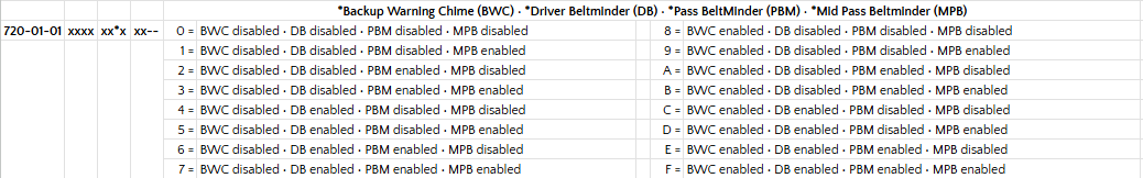

Went to disable the seatbelt pop up in the IPC, but my module only goes to 720-11-02, well 720-13-01 through 720-14-02 needs modified. I am using a Vgate vLinker. I just did other modules with it yesterday such as high beam fade on, climate to sync screen, bambi mode. Anyone else have this issue?
IPC does not go past 720-11-02 on these vehicles.
Edit: For 2021-2024 vehciles. 2025+ are different.

Well thats good and bad I suppose. Is there a module I can modify to get rid of the dash warning of what seatbelt isn't buckled ? That popup is annoying. Thabks
I'll dig around to see what I can find. I used the spreadsheet for the Maverick and the Explorer for these trucks as they seem to be the closest thing out there to them.

Try this from the 2023 Explorer spreadsheet:
Ford Bronco Sport Bronco ForScan Thread 1765206635005-66
My 2023 shows this:
Ford Bronco Sport Bronco ForScan Thread 1765206529300-5a
e,
Assuming yours also has a 6 there, I would change it from 6 to a 0 to disable everything in that location and then reboot the IPC from the wrench icon menu.

I will try that this evening, thank you. I have a feeling its just for the chimes and not the seating diagram that pops up in the cluster showing which occupied seat is buckled or unbuckled, but maybe it will be progress and a future entry for a Bronco Sport spreadsheet.
