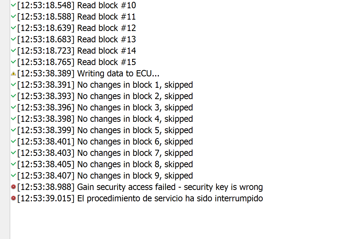

Has anyone been able to save the IPC configuration in BS 2025? Forscan won't let me and shows an error.
Thanks!
Thanks!
What's the error it's giving you?
You can pull the entire ab file from the motorcraft website that will include your IPC config and just use the write all option for the IPC. You just select the file you got from Ford and FORScan will do the rest.
I can save to any module except the IPC. When I try to save to the IPC, I get the error "Gain security access failed".

I wonder if it has anything to do with TRON? I don't remember if the IPC is part of the TRON network or not. Have other 2025 owners been able to access the IPC or you don't know? Are you able to access the IPMA? I know that module is TRON encrypted on the newer Fords.
Disregard; it's not TRON. I would message FORScan support with your VIN and issue. It may be a database issue on their side.
Thanks!
Ford Bronco Sport Bronco ForScan Thread image_2025-11-05_12-54-17
I had this problem with my 2025. I contacted forscan support and they sent me a test version of the next release that works.
I already sent them a message but they didn't reply :crying:. Do you remember which version of Forscan they sent you? Thanks
