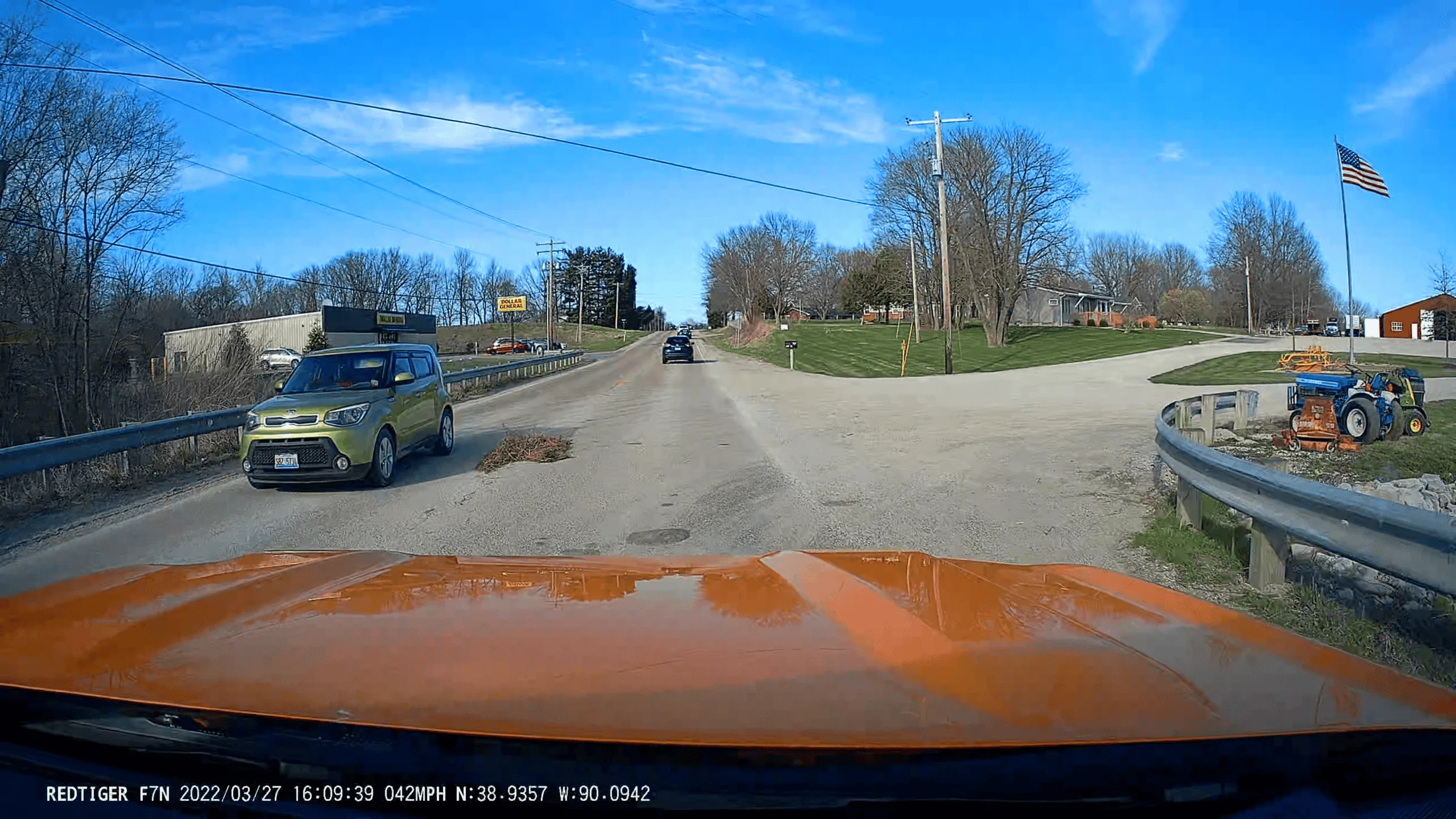

Here's a capture of a car going the opposite direction on a two-lane road. You can see my speed is 40+ mph. Assuming the other car is traveling the same speed, that's an 80 mph differential.
I agree some dashcams provide very low-quality video. You just have to be careful about which one you buy.

That is surprisingly good. If their plate wasn't bent you could actually read the whole thing.
It's too bad your dash cam is so big. I go back to not wanting a screen. It's amazing that the one listed way up this thread that is $500 is kind of small and doesn't have a screen with 4k resolution. It seems that everything I have seen in the sub $200 range with 4k has a huge screen.

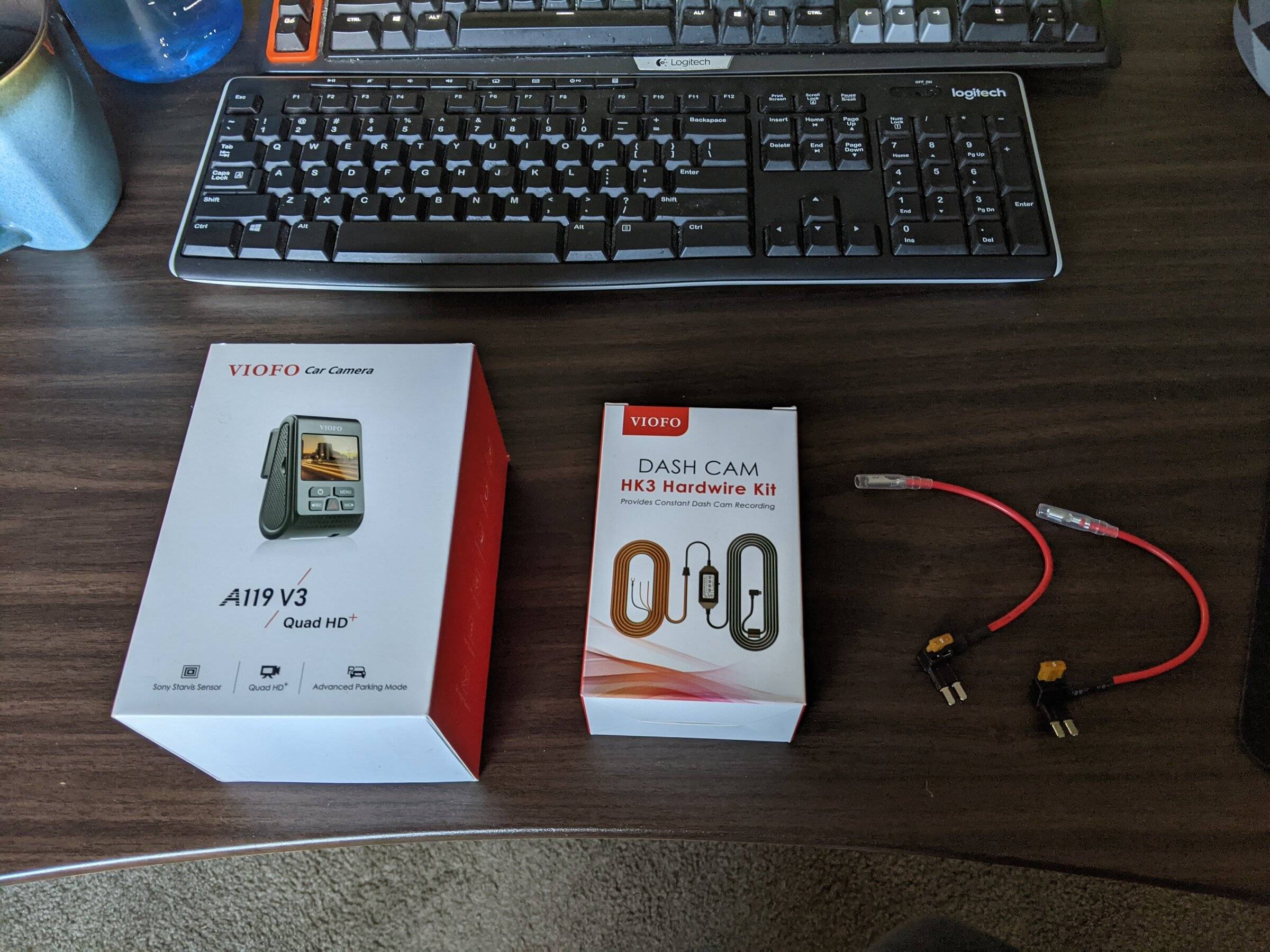

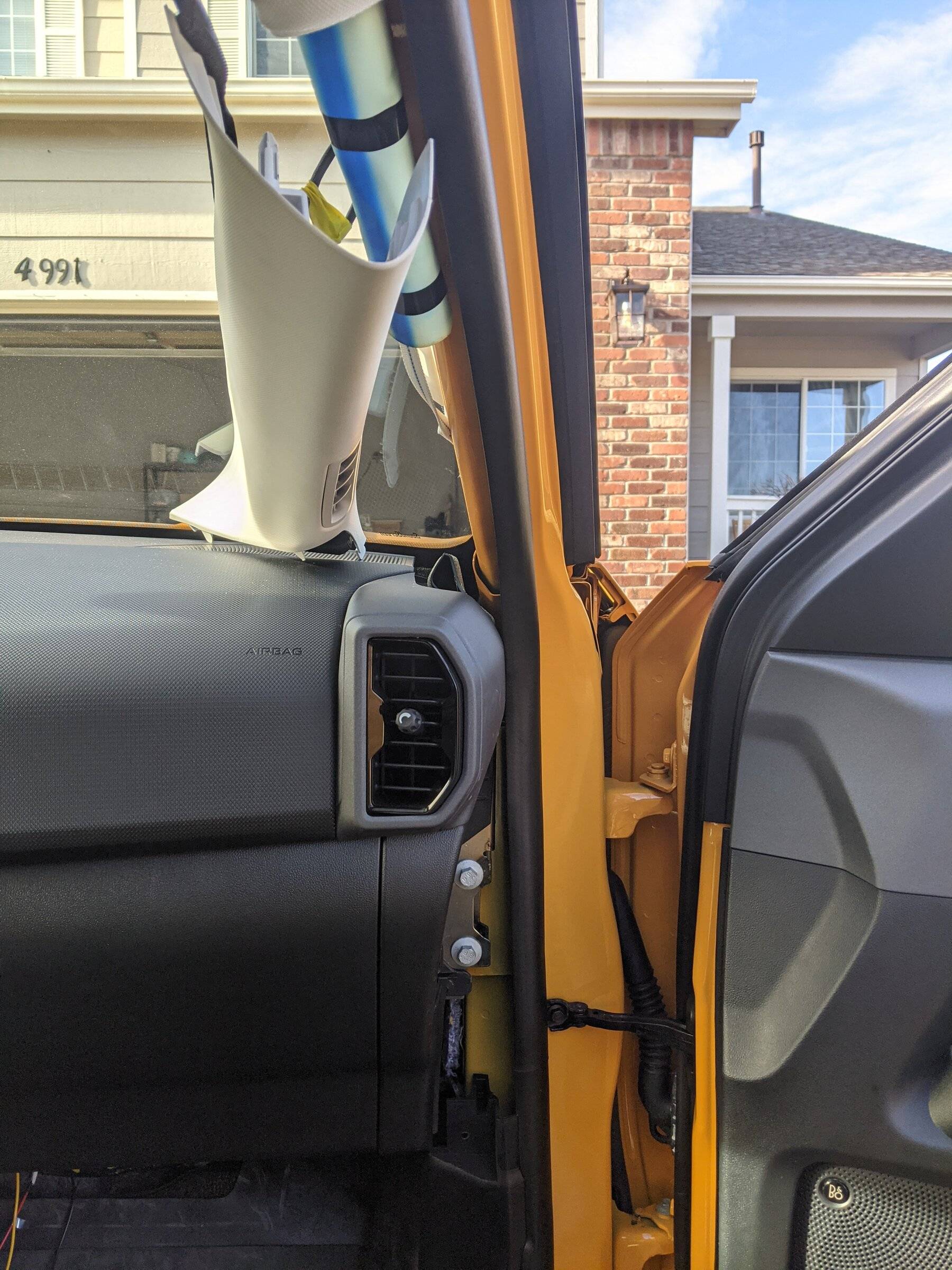

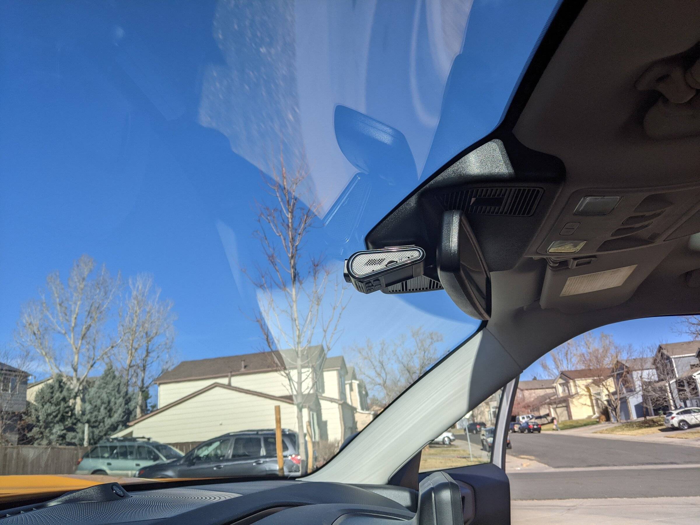

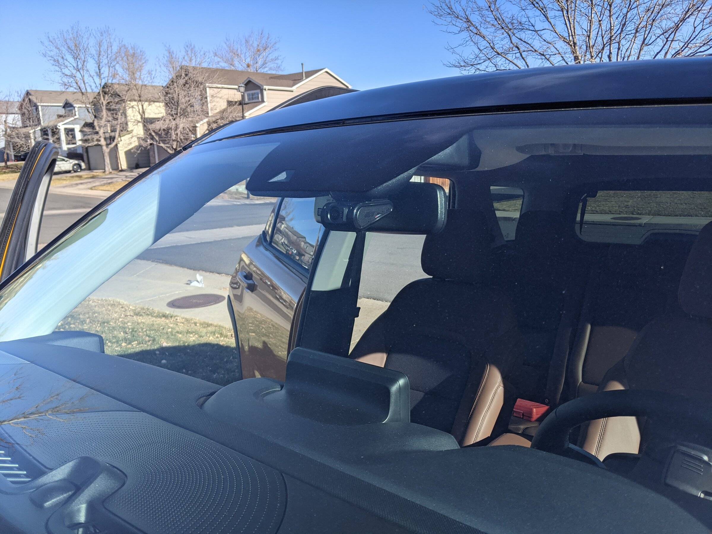

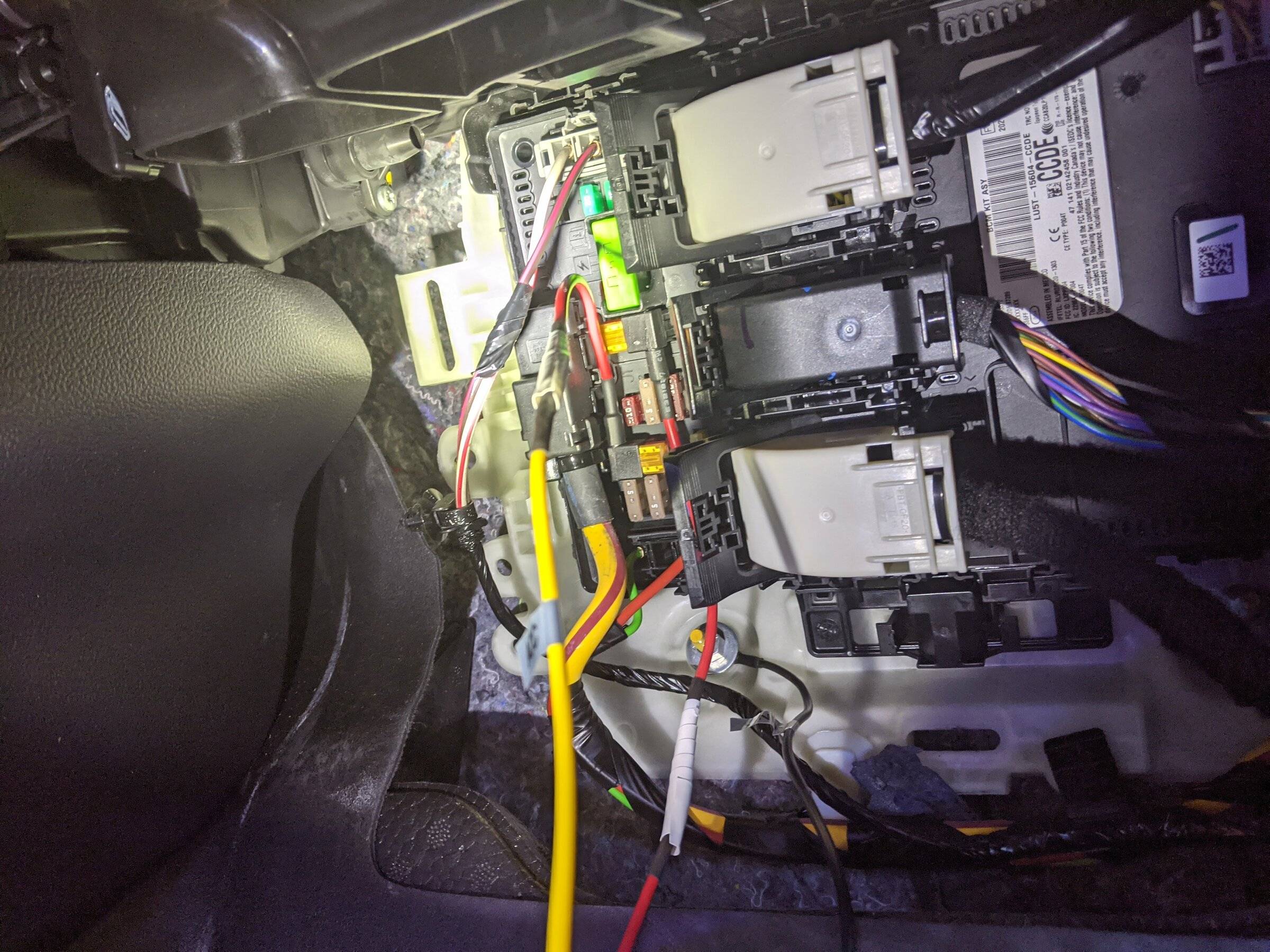

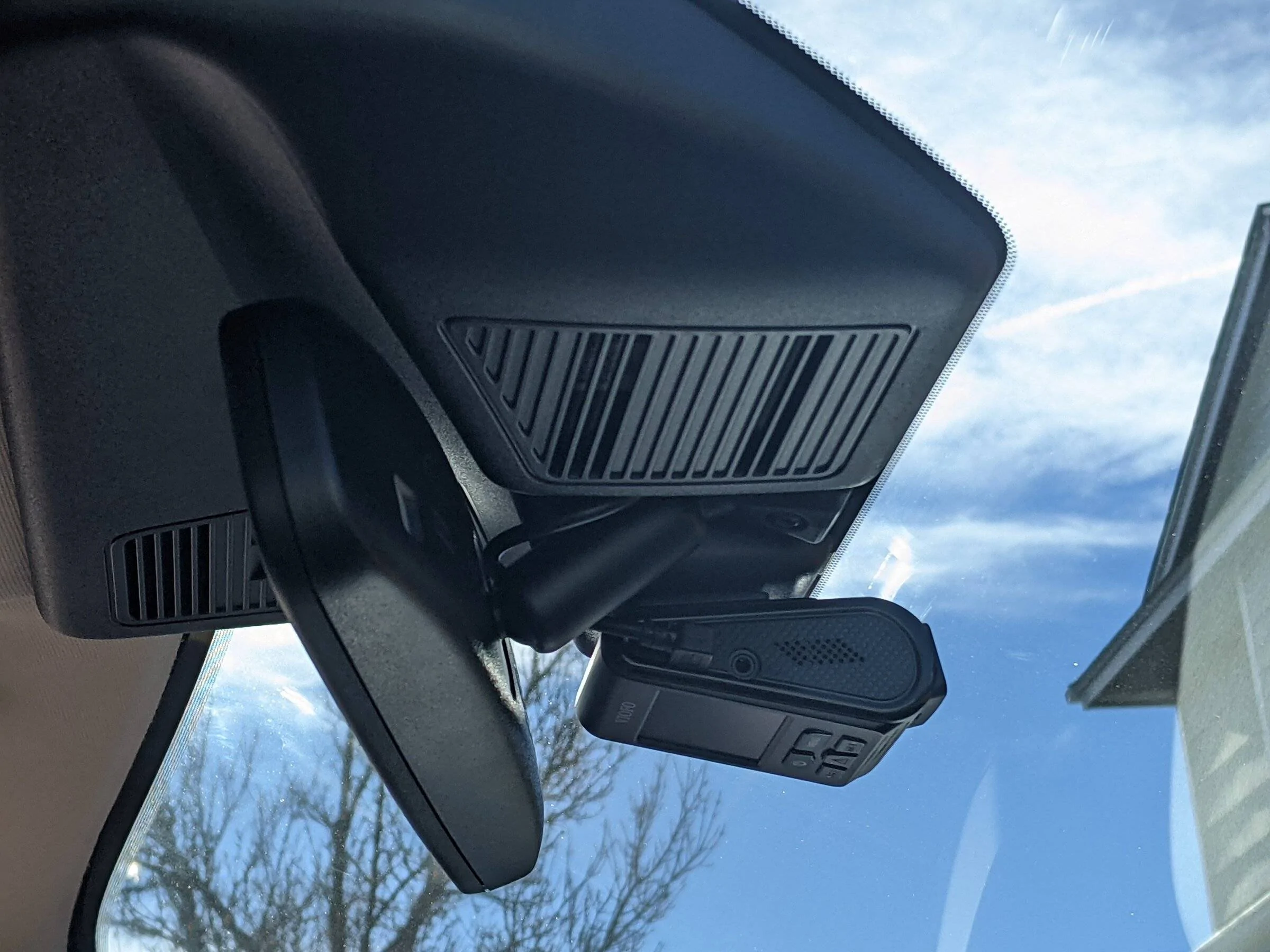

The Viofo A119 fit perfectly behind the rearview mirror and was an easy install straight to the fuse box. I popped the adaptive cruise camera cover and routed the cable inside of it and the headliner, down the A pillar, and right into the fuse box. Adhered the camera right to the camera cover. I didn't bother with the rear camera, but may add it on in the future mounted in the front facing back into the cab. I also didn't bother with the GPS mount because it adds thickness. Plus, no one needs to know how fast I was going.
