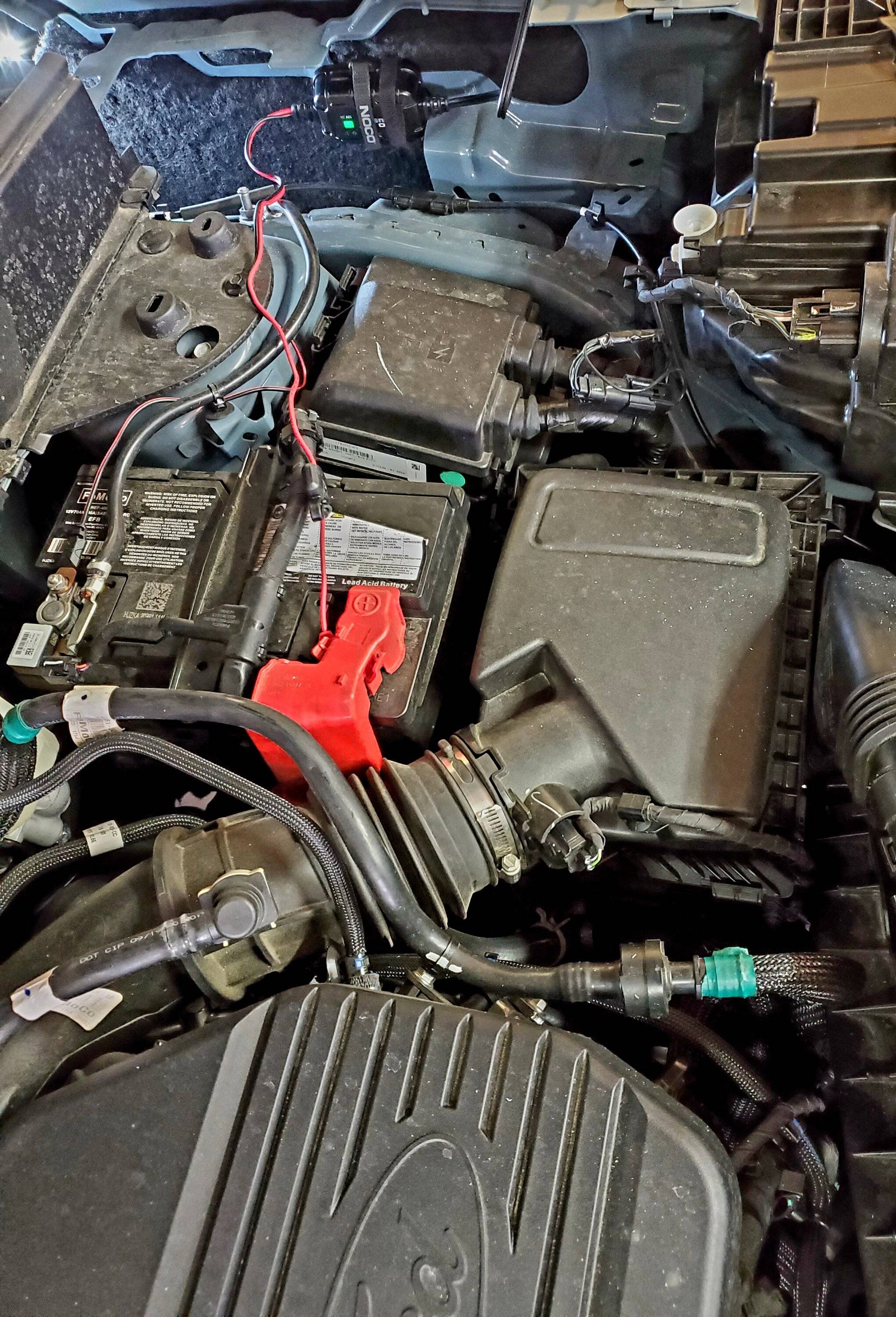

Update: Per peer advice on this forum, I followed the links in this thread and purchased:
Ford Bronco Sport Bed rest BS best practices Screenshot_20230225_095441
I managed to drag the 5-minute install out to 20-minutes (LoL).
Pic below
Ford Bronco Sport Bed rest BS best practices 20230220_132421
I secured the mounting bracket via thick Zip Ties (supplemented by velcro wraps) instead of the supplied metal screws b/c I didn't want to drill holes in my BSFE w/ 2.0L engine, and concerns about dissimilar metals tendency to corrode.
After 3-weeks of inactivity, the battery charge was <75% but the Noco got it back to +/- 100% overnight, as indicated by the green light.
I won't be able to drive it for several weeks, but plan to check the zip-tie install regularly as it allows slight side-to-side movement.

Did you connect directly to the 12V Battery red terminal or to the other side of the mounted current detector?
The side one. I couldn't get it to the main one. But it's still under the red plastic cover.
Sounds good.. connecting to the incoming side of the current shunt will allow the BMS to keep track of the trickle charge current added to your battery
