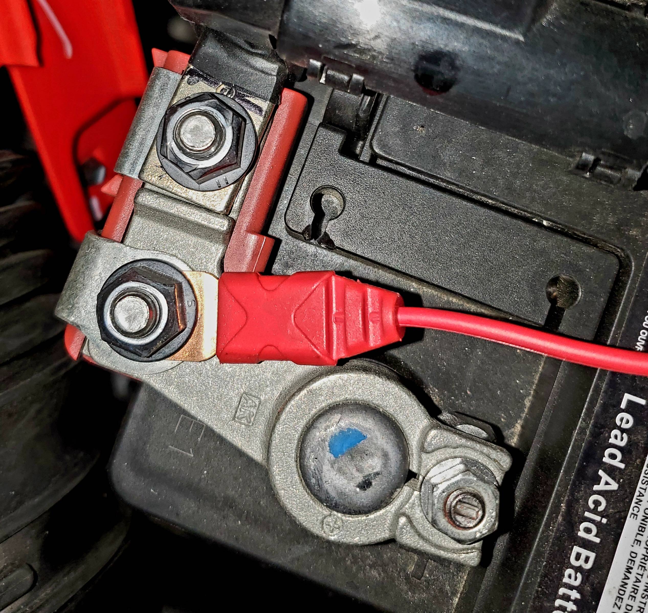

Is this the correct mount?
Ford Bronco Sport Bed rest BS best practices 20230225_113443
It’s not a full pic the top side is cut off but I think you want to connect to the top side bolt but I can’t tell from the pic

Sounds good.. connecting to the incoming side of the current shunt will allow the BMS to keep track of the trickle charge current added to your battery

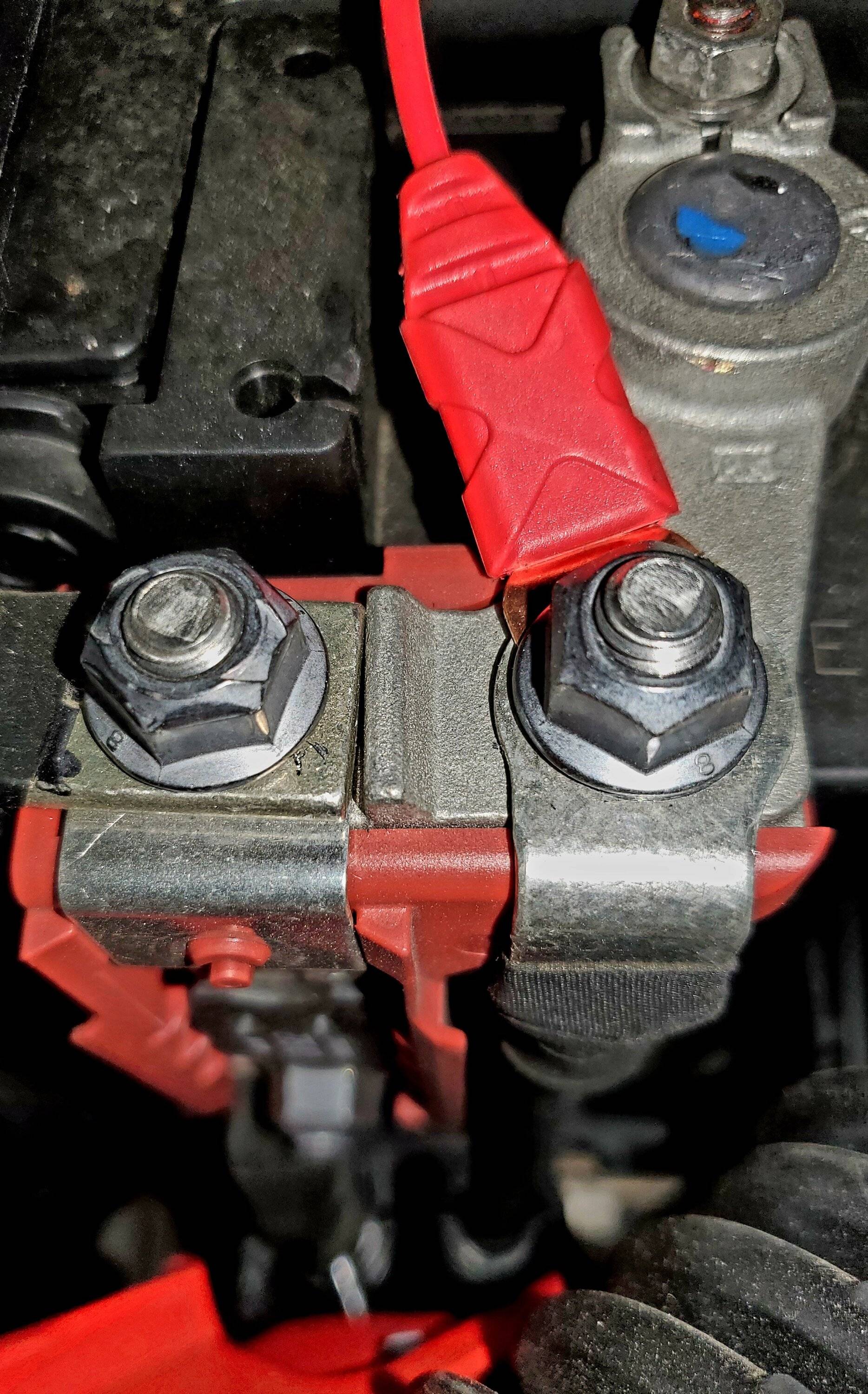

Another angle
