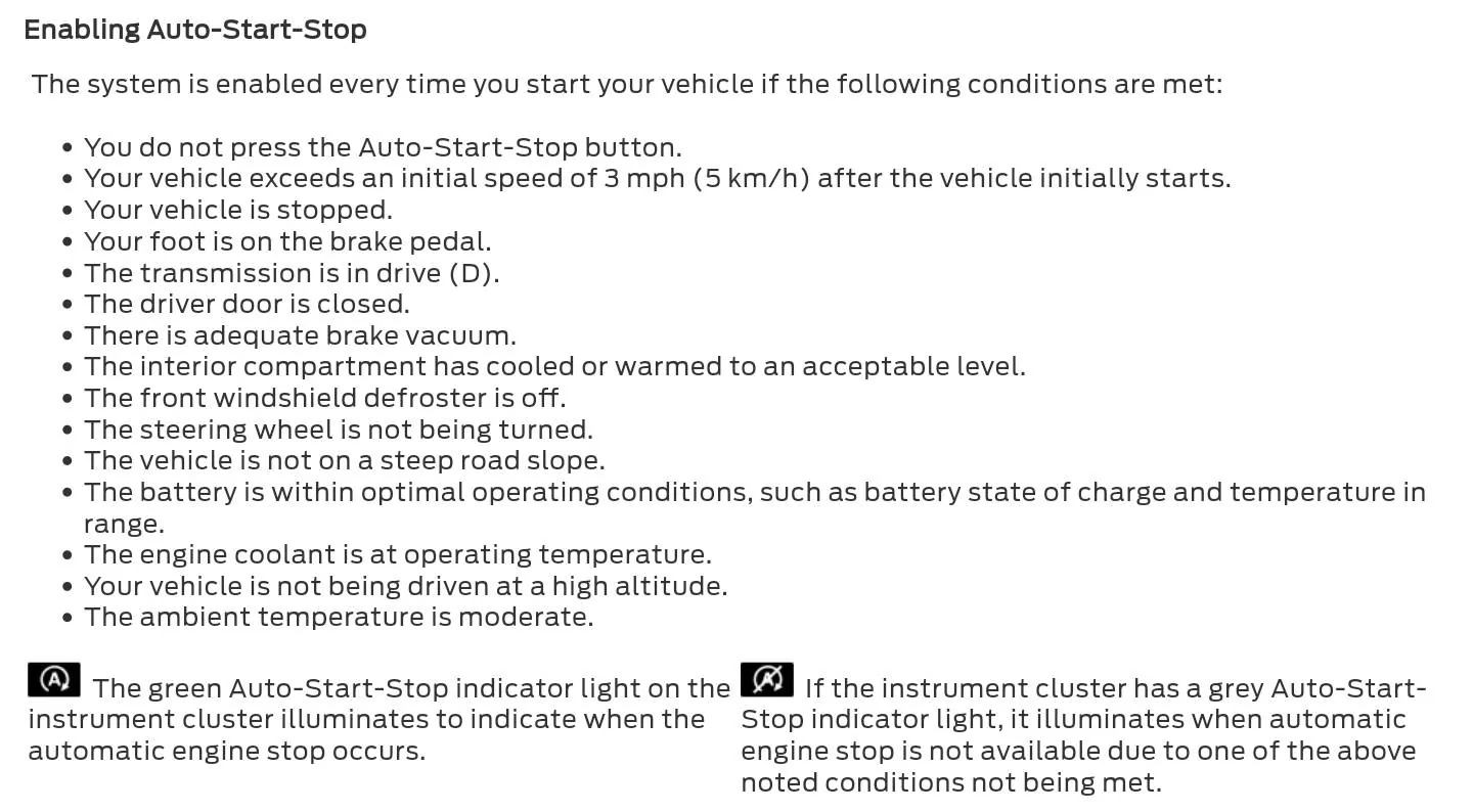

My assumption is that one or more of the conditions is not met and is not activating like normal.
Ford Bronco Sport Auto Stop / Start  not working Screenshot_20221024_181547
I would assume as the season turns colder and colder into winter for me, my Auto Start Stop will not turn on as much depending on temps.
