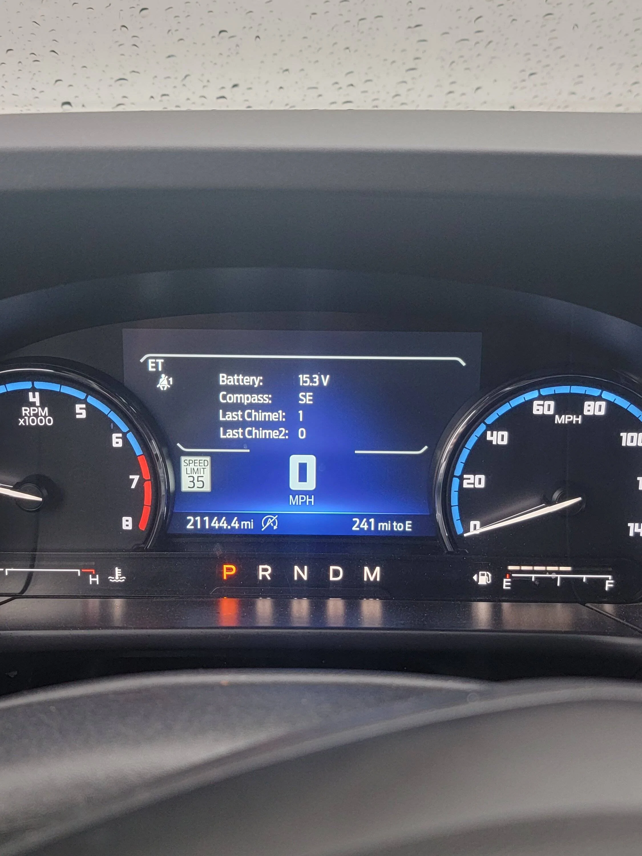

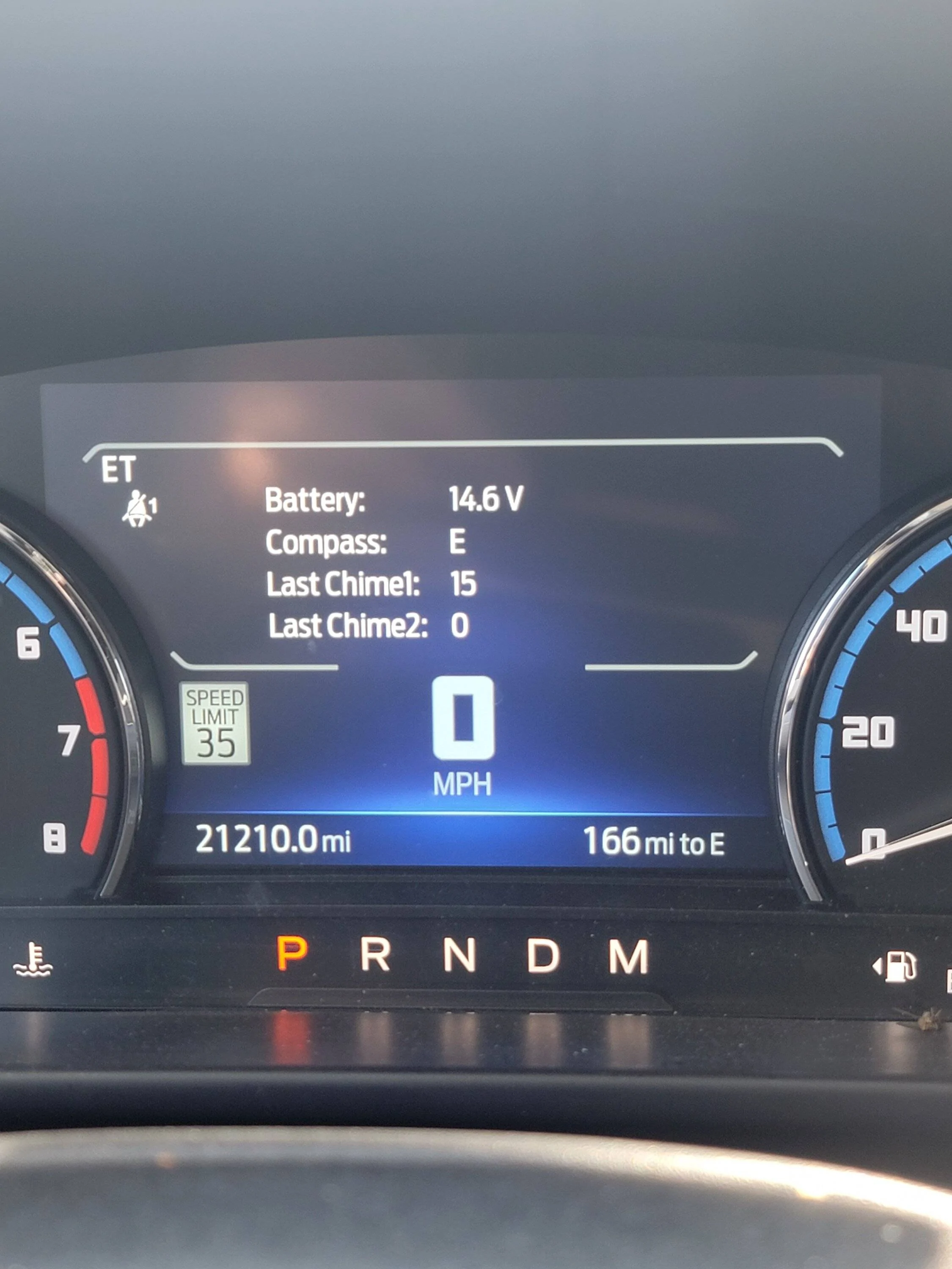

Been having the same issues described above for countless months, every time I come to a stop the status on the info display says "Engine on due to vehicle charging." I was thinking I'm alone in this.
If I charge it with a 2 amp trickle charger, it finally decides to work....however only for about a day. It will shut the engine off maybe 7 times max, then it's back to square one. My dealer is smaller and not as knowledgeable, but this is annoying and something I'd like to resolve. Do I just have to go through the back and forth to get a new battery under warranty?
Got a resolution today: I noticed when going through the Engineering Testing screens that it was charging at 15.4 volts. I thought that was a bit high. They ran their test on the battery, said it came back good. They also reset the battery charging system. I checked it once I got out, now it's down at 14.6 where it should be. Auto stop start is working for the time being. Will keep you guys posted in the coming weeks.
