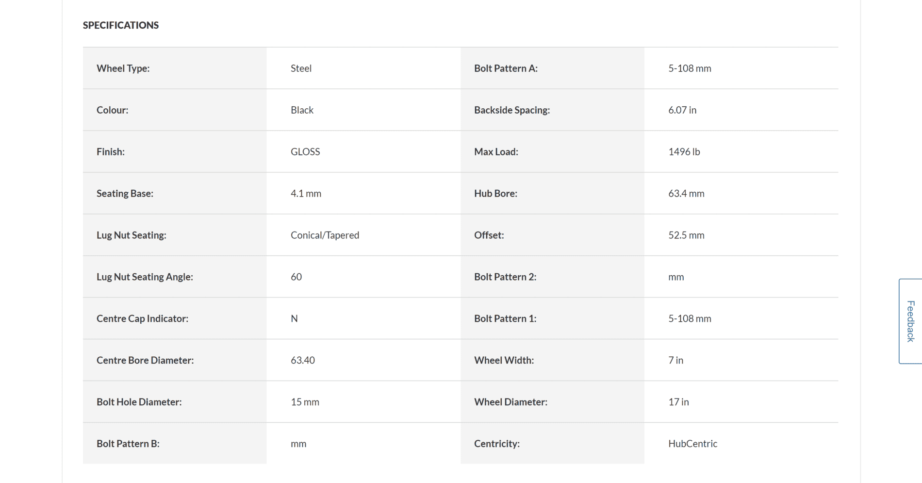

MFM
Oct 10, 2020
26
Belleville Ontario Canada
1969 Mercury Cougar Convertible
5 x 108 (4.25"). Wheel offset is +37.5mm on the stock Big Bend wheels. I assume the Badlands offset is the same.
Here are the Spec's from the Canadian Tire Website for the Steel Rims.
Cheers
