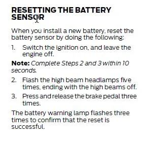

Battery Sensor Reset (Battery Management System (BMS) Reset):
When you install a new battery, reset the battery sensor by doing the following:
1. Switch ignition on, and leave the engine off.
Note: Complete Steps 2 & 3 within 10 seconds.
2. Flash the high beam headlamps five times, ending with the high beams off.
3. Press and release the brake pedal 3 times.
The battery warning lamp flashes 3 times to confirm that the reset is successful.

I read in the owners manual there are all kinds of resets you need to do when replacing the battery
108
4,339
5,007
Not really in practice .. the BMS Reset is the primary item. You may need to reprogram some settings like radio stations but I haven’t had anything like that yet. Maybe because my old battery was disconnected for a short period of time.
What resets are toy referring to?
