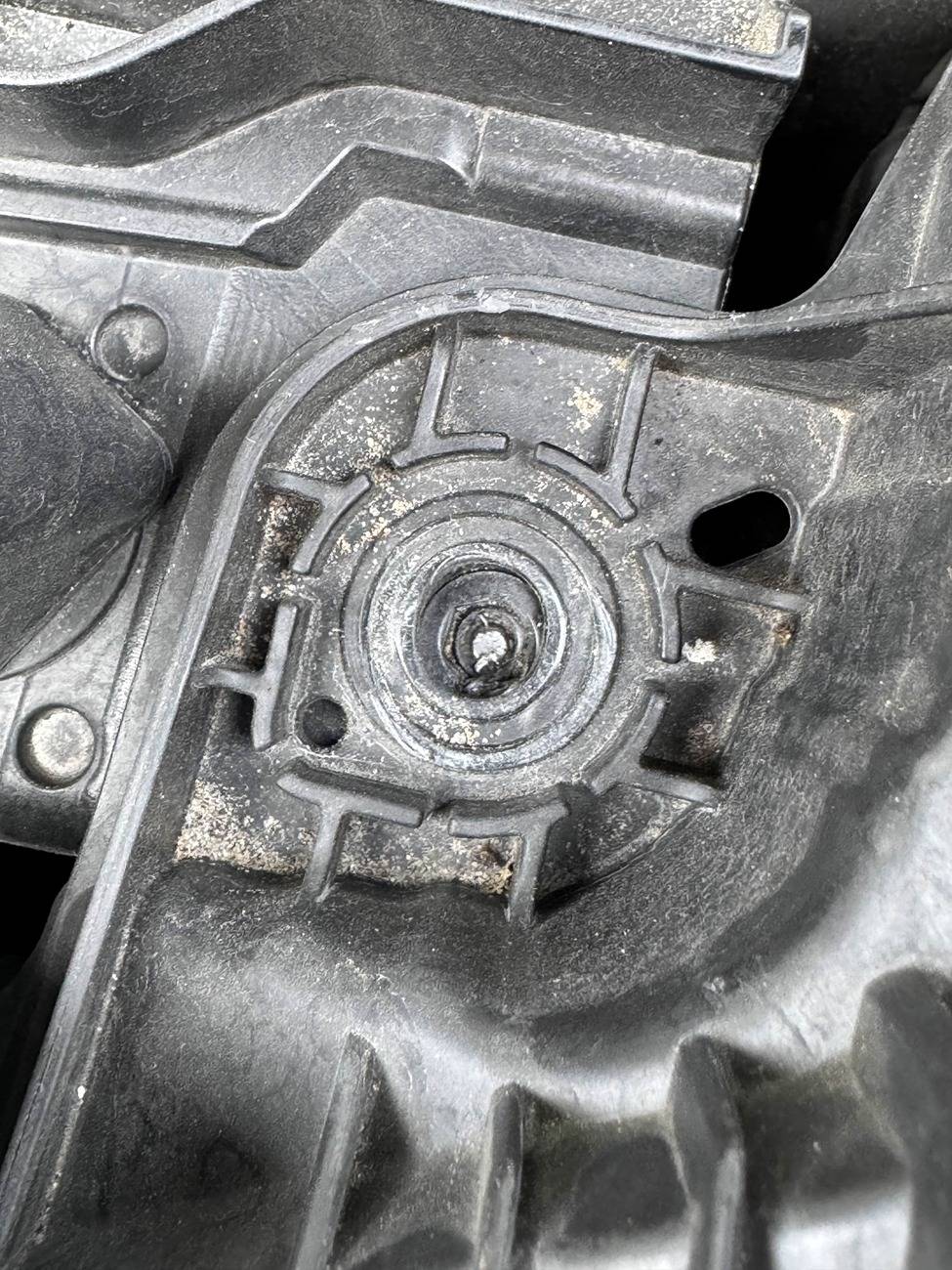

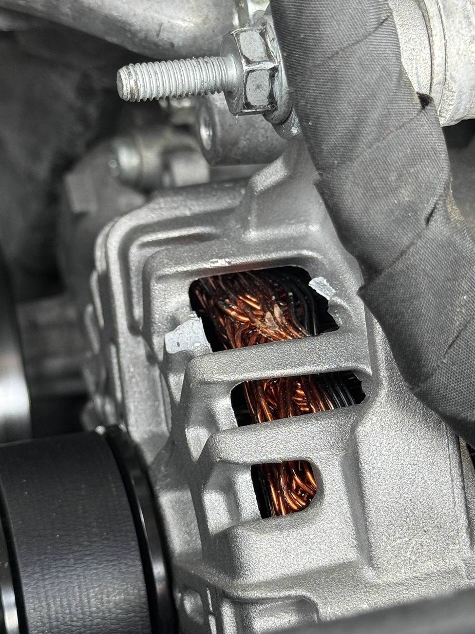

After getting it back from the dealership, I found a snapped off bolt that holds on the front of the car, as well as a damaged brand new alternator. Took it back, spoke with their district manager and now they have the car again and they're going to be replacing both the bolt and the alternator again.

Actually ridiculous. I’m a very understanding and patient person when it comes to any type of service being performed by a human. We all make mistakes etc but that is pure laziness and flat out disrespectful. Sorry for your troubles man that is gnarly
Unacceptable. The technician made a major mistake and rather than own up to it they are covering their ass and hoping the customer doesn't notice.
