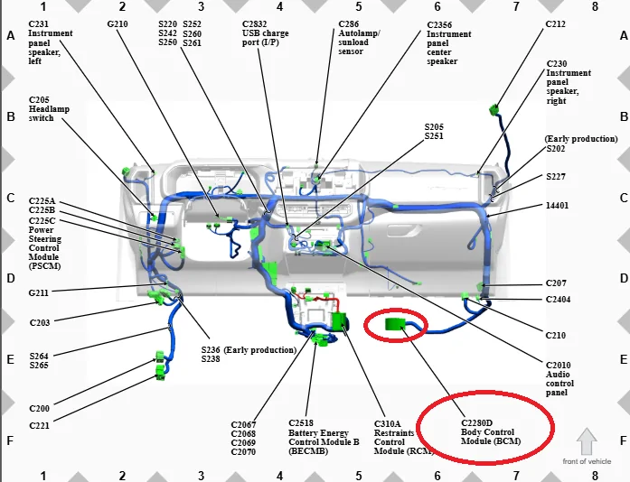

I was not able to find splice S207 in PTS, but the connector that @DonImbimbo mentioned C2280B does mention ambient lighting in some of the pins. It mentions postive and negative for the ambient light sensor, but no mention of the LIN: See attached; it is located here:

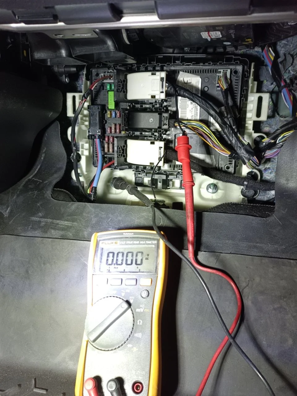

What you said has confused me about the correct circuit... I connected pin 31 of the C2280D and pin 4 of the C2280F. But pin 4 has no voltage.
So we're off to a bad start! I'm wondering if it has a fuse or if the correct circuit is the one you described.

Thank you so much, rugedraw.
Ford Bronco Sport Ambient Lighting install / enabling - DIY project photo_2026-04-18_18-48-01
I got that from Ford's workshop manual for a 2025 BS. Unless the info is wrong which would not surprise me.

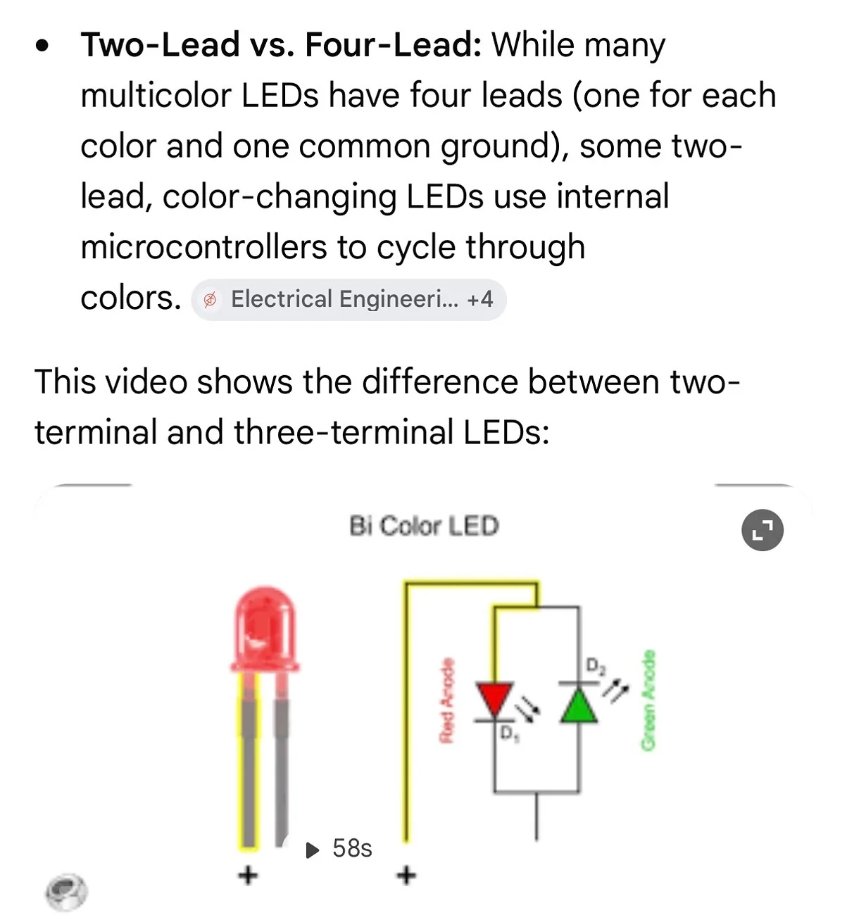

A multicolor LED would need some form of a control interface … the LIN bus was mentioned in an earlier post and didn’t look like Bronco Sports have a pin for the LIN control on the connector… but I don’t have the wiring diagrams so can’t say what’s needed to make multicolor work
there are multiple types of multicolor LEDS…
Ford Bronco Sport Ambient Lighting install / enabling - DIY project IMG_7214
yup, or three wire if it is an adressable. what has me confused is that they have the option to enable to color selection setting when you go to forscan. so I was going to take a look and see if I could find a different led modual that fits the location that is maybe in a escape titanium or somthing. its like in mine the conector for the lighted cupholder is under the center cupholder so I just need to buy one from the escort and it will light up also.

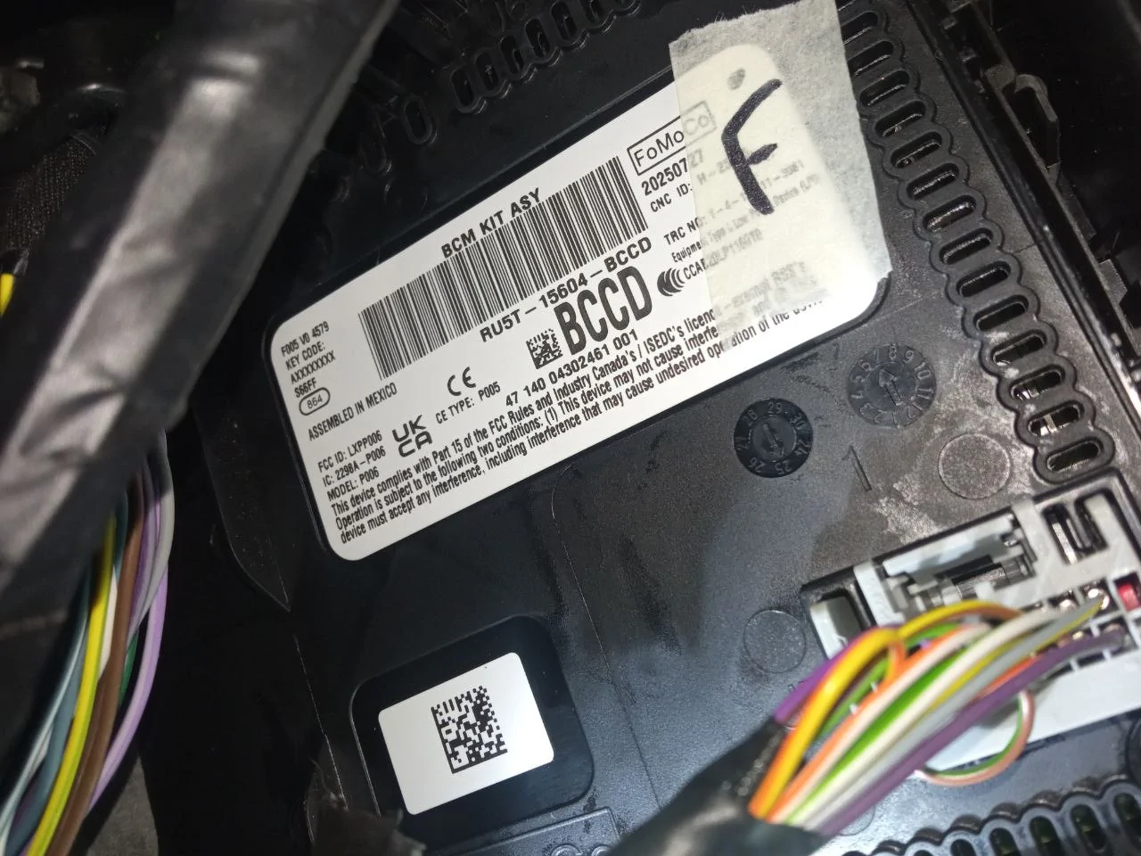

The 2025 BS BCM is exactly the same as the 2025 Maverick. So we wouldn't have a problem at least adding a blue light.
We'd just need to find the correct PIN!
The option for blue or colored ambient light appears in the BCM settings.
