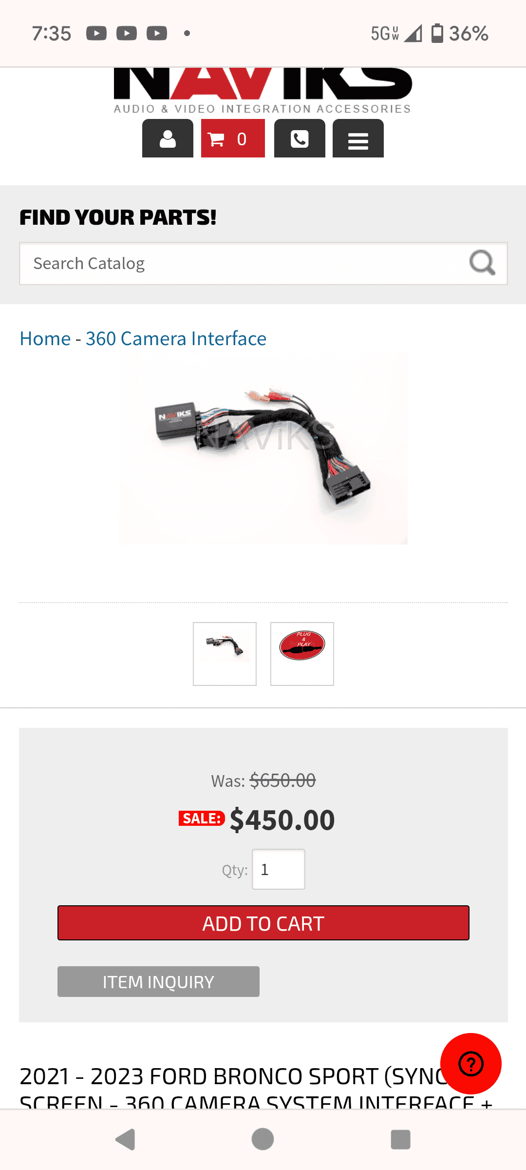

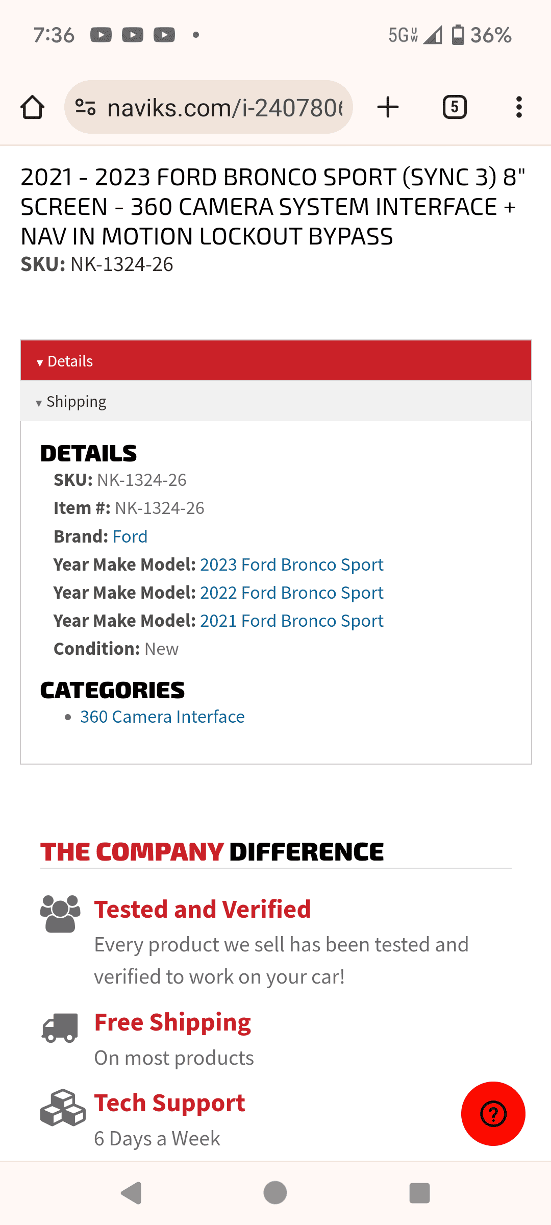

So I heard back from Naviks and I'm going to do the 360 camera version because they said it'll let me add three more cameras. Still not sure if that's going to come with the bird's eye view. It also says that I can access the cameras at any speed and it'll turn the side cameras on with my turn signals as well which is cool.
I'm probably not going to do it on this paycheck cuz I got a raise starting next check and it's been an expensive Christmas. But in the coming weeks I should be able to post how it goes. And here's a screenshot of what I'm going to be buying:
