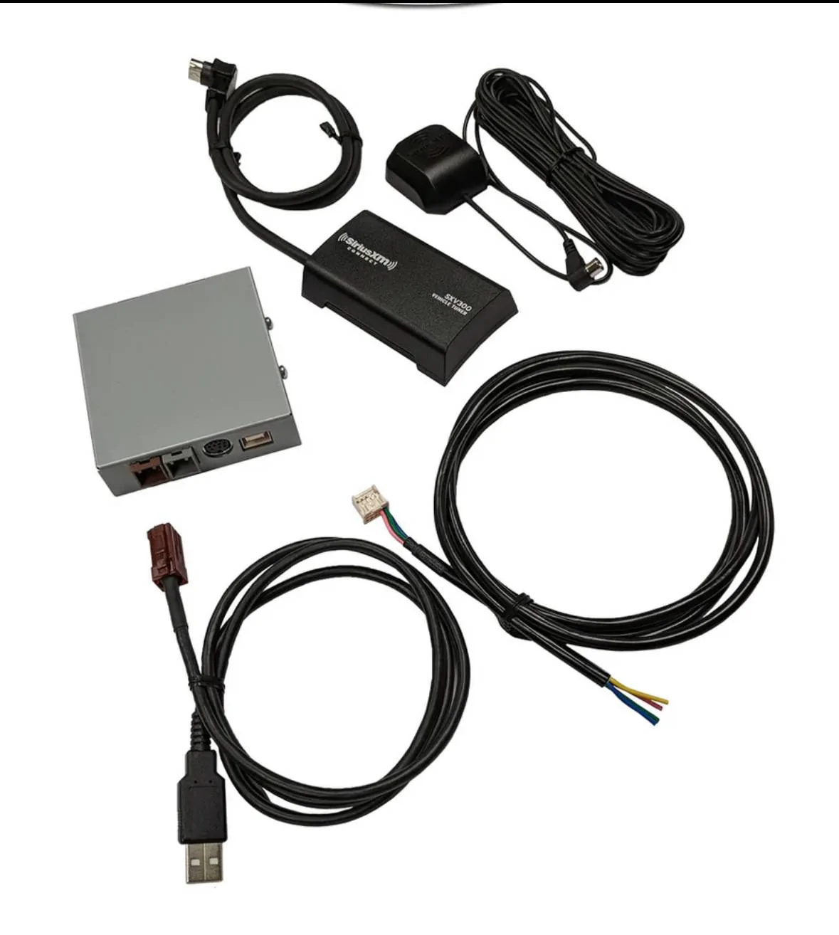

You can buy just the SiriusXM antenna (see pic top right), mount that in an open area possibly on the roof above windshield and run the antenna cable down the drivers side pillar and into interior of vehicle under/behind the dash over to behind the 8” Display. I’m 90% sure the SiriusXM vehicle tuner (receiver) is located close to the APIM which is behind the 8” Display but others might know for sure.
If you wanted to avoid issues with a SiriusXM signal combiner, you can unplug the SiriusXM rooftop antenna and plug in your new SiriusXM antenna (this plug in occurs behind the 8” Display).
See the link for the SiriusXM parts and possible that company will sell you just the SiriusXM antenna. If not you can Google search to locate one at a reasonable price or snag one from a wrecked vehicle.
You can find Ford’s PDF showing how to run a cable down the drivers side pillar.
You can find a YouTube video showing how to add Ford Navigation which shows you how to disassemble the center area to gain access behind the 8” Display.
I do not know how much signal interference or satellite signal degradation you will experience by mounting a new SiriusXM antenna in a different location - Ford has done the RF engineering when the location for the shark fin antenna was chosen but I assume also knew that location would interfere with satellite reception when cargo is placed above the shark fin antenna (the shark fin antenna provides AM/FM/HD and contains the SiriusXM antenna).

https://www.xm-radio-satellite.com/products/ford-siriusxm-radio-oem-factory-radio-kit
