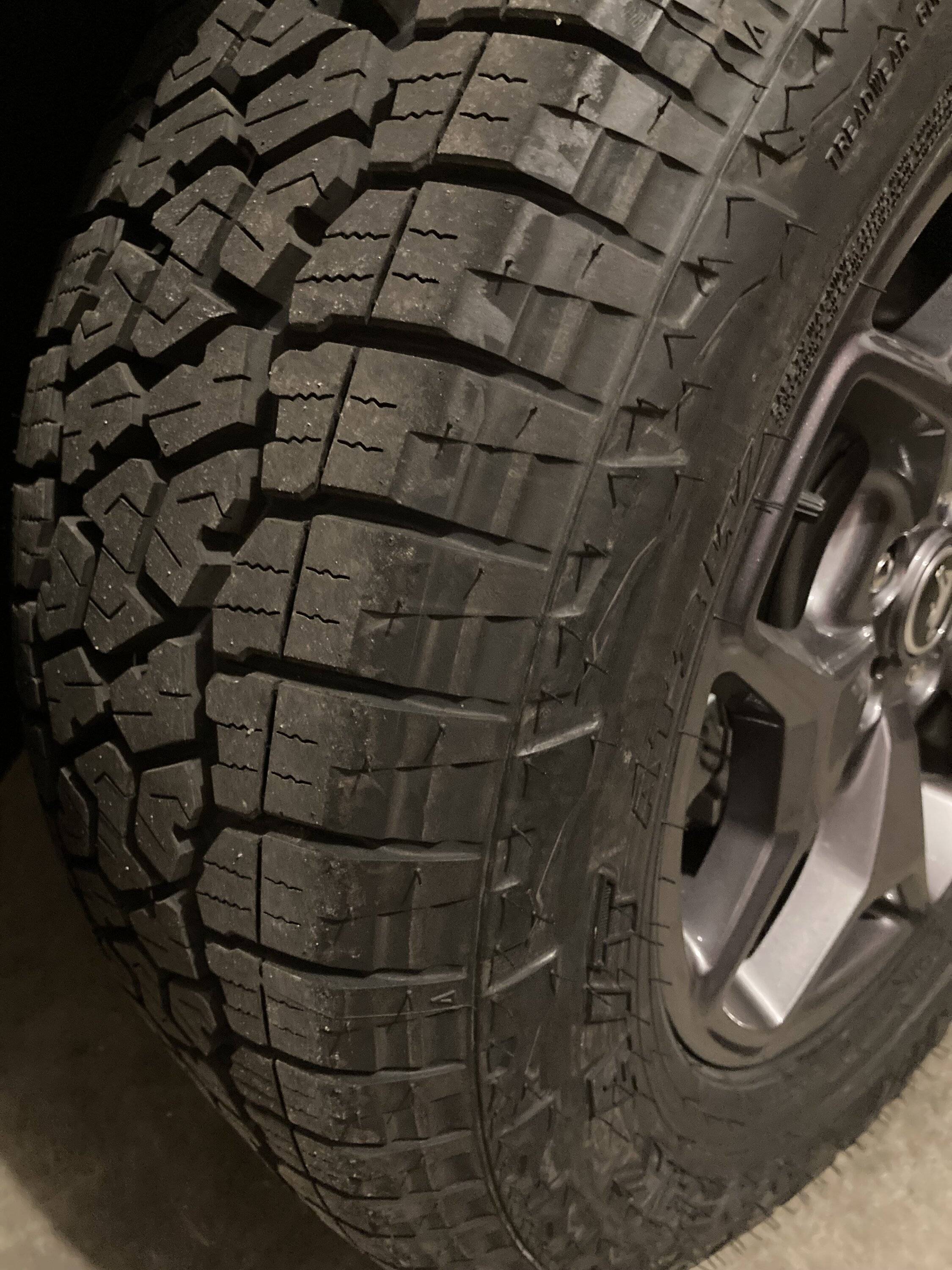

I like the falken at trails it's a nice road tire but still great in snow and if you happen to go off-road still good. It's what I ran on my 14 escape when the stockers wore out and they last forever too.
2,679
3,382
My vote would be for the Falken 235/65-17 AT WildPeaks. They were made specifically for the sport and while they don’t have the most aggressive treads, they have been great on and off road with still being quiet and giving a great ride.

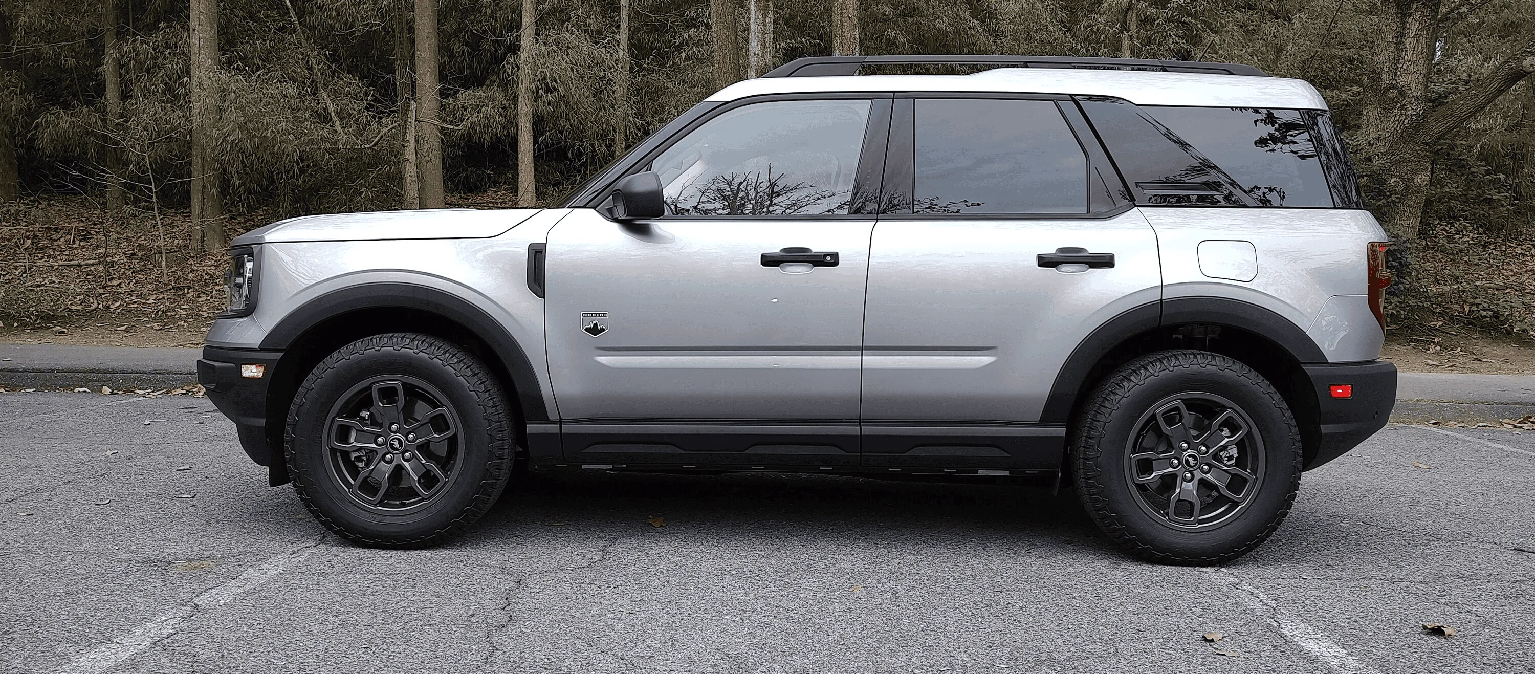

If you do not off road. Biggest tire size is 245/70/17 on stock wheels otherwise stick to 245/65/17.

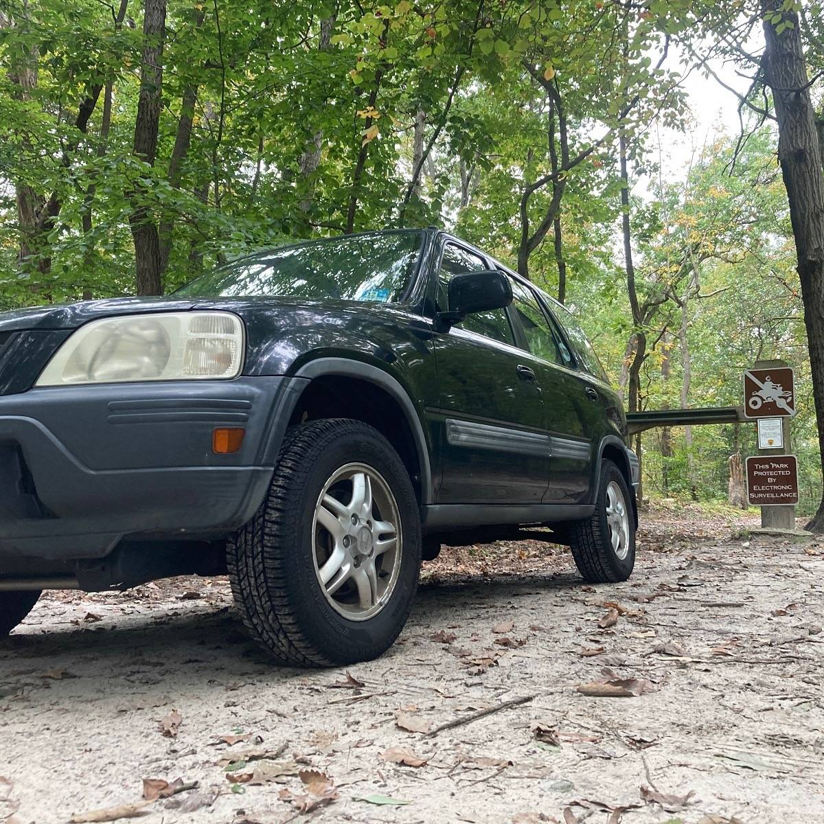

GEOLANDAR A/T G015? Fairly quiet on pavement with good traction on soft roads. Recommended by my mechanic when I told him about driving down the sand roads in Wharton State Forest in New Jersey.
GEOLANDAR A/T G015
