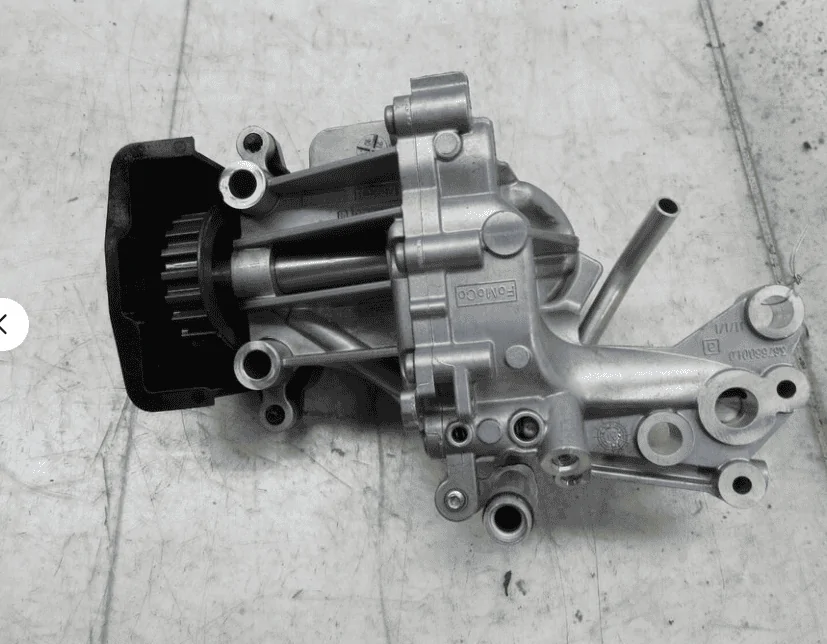

I thought this short video was interesting, it’s the 1.0L engine but do the 1.5l have the same belt drive design for the oil pump?

So perhaps the oil pump is belt driven, and the cams are chain driven?
from what i heard- If i remember correctly it was said that
The dragon engine's oil pump is actually driven by the balance-shaft, and the balance shaft is a gear-to-gear piece connected to the crank, so. That's new,
