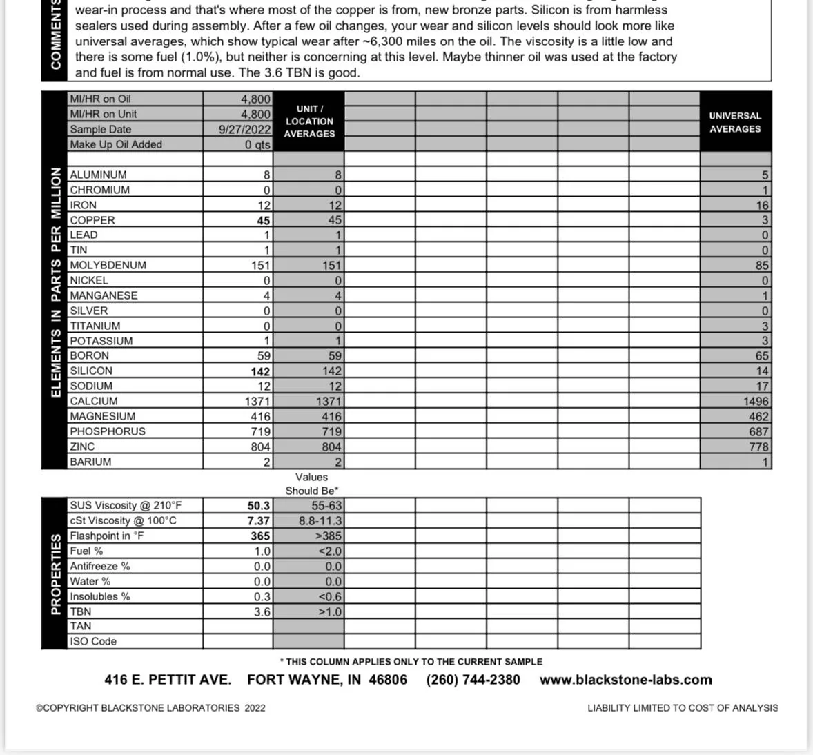

Did my oil at 4800 miles. I had fuel dilution already and less than ideal viscosity. These newer direct injections (Ford, Honda, etc) that are straight direct injected and not a mix of port/di get blow by and oil dilution. DI sprays super rich on start up. To try to help get up to temp. You can smell it when you start it. This fuel doesn’t fully burn and most folks don’t do enough driving to burn this off. Stop and go and short drives. Basically anything under 1/2hr is not the best for DI motors. Honda, Ford and few others have had issues with this. The head gasket issue was fixed/updated on the 20 up 2.0.
After getting the oil report I’m gonna change all the fluids in this thing earlier than what Ford recommends. I mean the rear diff has about 1/2 qt with 30k service intervals. Seems like bad juju also

Was this based on a lab test or eyeballing it?
Ford Bronco Sport 1st Oil Change on Bronco Sport Badlands -- Thoughts and Things Learned! ABF5E21E-31D9-4B5C-93BB-5B16421E45AD
Roger that--thanks! Please let us know what you see on the next change. I'm curious if they use something different for oil from the factory.
