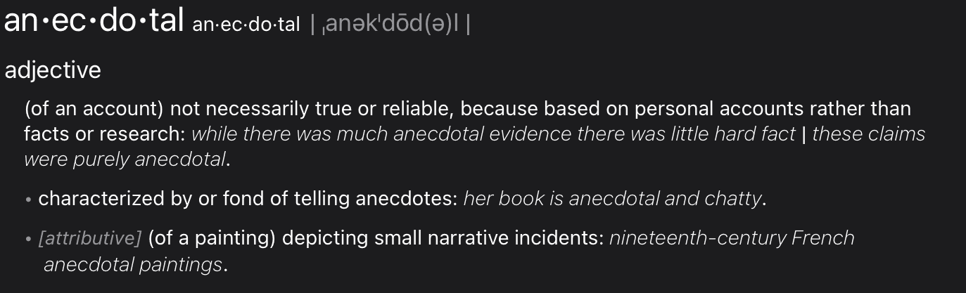

I think you'll find if you re-read what I wrote that I'm well aware of what "anecdotal" means. My non-anecdotal data would be that of the blackstone labs oil analysis report (FACTS) as opposed to that dude's conjecture regarding Ford's data as it pertains to their service interval recommendations.
In this case ā€œanecdotalā€ is the presentation of one oil analysis. Yes, it is factual but an extremely limited sample size, thus making it anecdotal. That is not to say that there aren’t more examples of this out there, but you have only presented the one.
