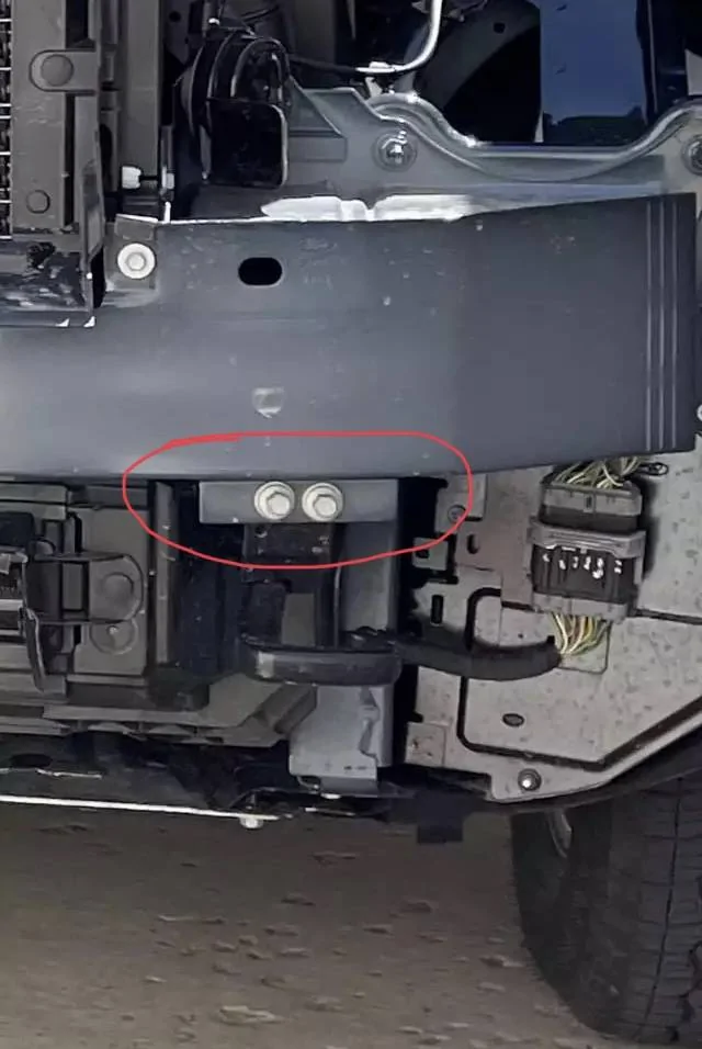

I do not believe the bracketry depicted in this installation document will support recovery/towing operations. The photo at this link shows how the factory tow hooks on the Badlands attach to the unibody. Note the reinforcement brackets and how they are welded to the unibody. If your bull bar doesn't include this level of structural attachment to the vehicle's unibody then I would not use it for recovery/towing ops.
Yeah, all the nudge bars just use the bolt locations that stabilize the tow hooks from turning. Besides being at least 4x as strong as any one of those bolts, the tow hook is attached deeper in the frame in a presumably stronger location. The eight bolts would probably be strong enough, but unlikely to be equalized, and attached to frame parts of dubious strength.

What's the difference from being towed in the rear from your tow hook attached to the hitch (that isn't welded) and the bull bar on the front?
The tow hitch is pulling on much larger bolts in shear, well equalized, bolted to a place on the frame meant to take towing loads. The bull bar is levering on much smaller bolts, in tension/bending on frame parts of unknown strength. Not an engineer, but have some idea of the forces and structures needed. I think you’d stand a good chance of ripping the bull bar and the pieces of the frame it bolts to off in a recovery.

I can assure you two of those little tabs have a minimum breaking strength far lower than your tow rope or winch line. These are the main connection point for the nudge bars I’ve seen, with one more small bolt below.
