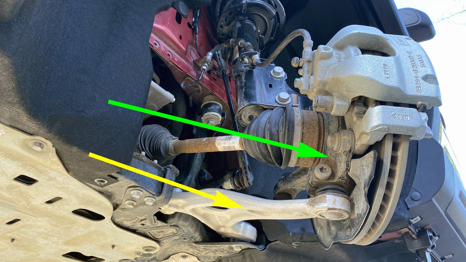

I've been watching a YouTube channel called Matt's Offroad Recovery. He specializes in getting people unstuck, and many of the vehicles he works with are not equipped with recovery hooks. He often crawls underneath and uses soft shackles around the lower control arms (yellow arrow in the photo below). He usually attaches them nearer the frame rather than the wheel hub.
Ford Bronco Sport Where should I hook a tow strap? 3_fr_oa_low-copy
Matt sometimes answers questions from viewers in his videos, and one of them was a question about the durability of lower control arms as a recovery point. He claims you can hang a vehicle from the control arms without fear of damaging anything.

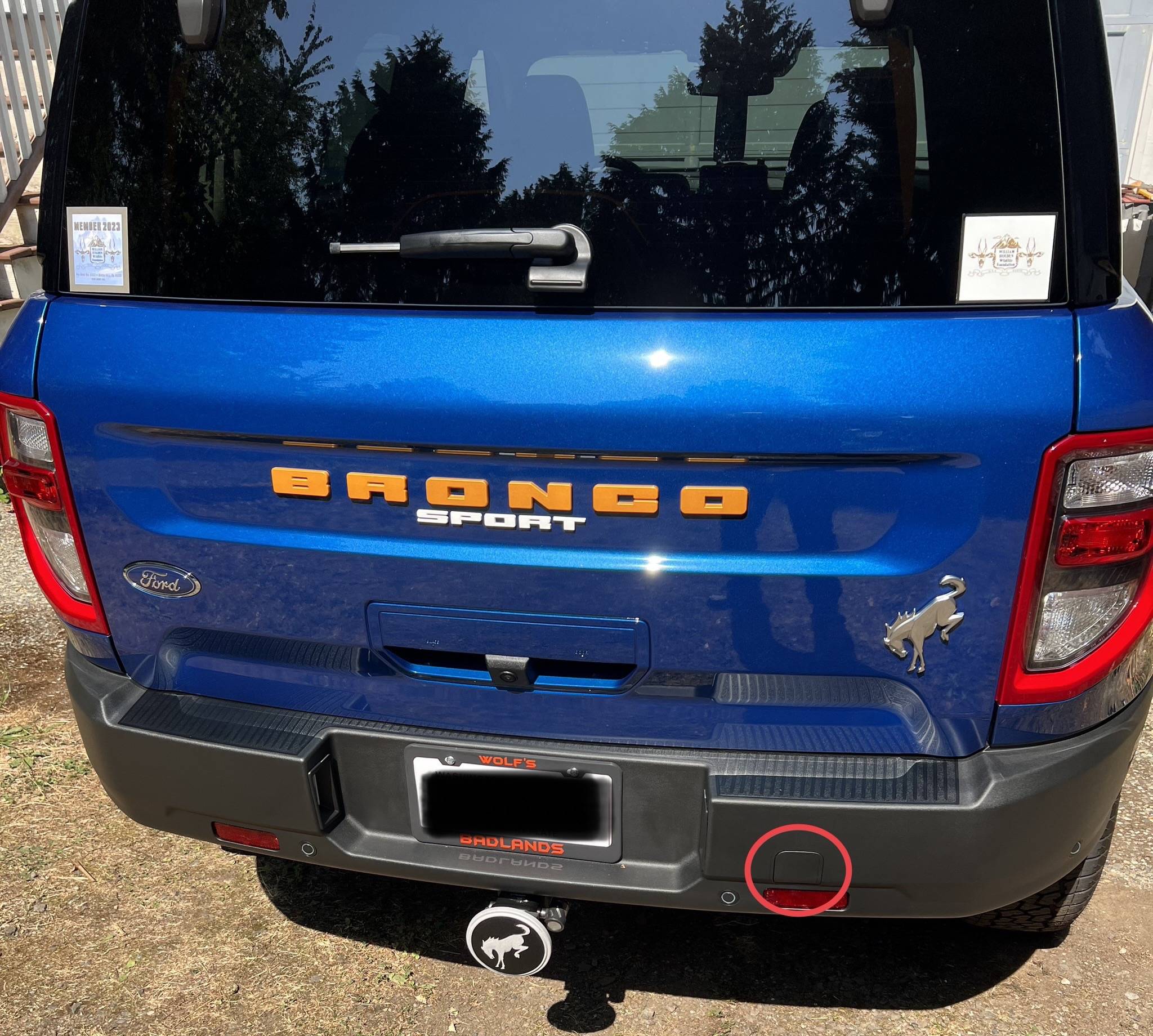

Putting this here for those that don’t have a tow package. The picture is where the recovery tow point is (Red Circle) on the rear of the sport. The first link takes you to an Amazon page with a great price for a Recovery Tow Eye. The second link is for what is stated as OEM Recovery Tow Eye. They have the same part number, but they do look a bit different and it’s hard to tell metal quality when it’s in your hand. So, you’ll have to make your choice based on pictures. Amazon may tell you it won’t fit the BS, but it does. It is the Ford part number that is recommended. Other info you might want: the Recovery Eye is reverse threaded, so left/loose right/tight does not apply.
https://a.co/d/evOk6M3
https://a.co/d/bvwOYuH
Ford Bronco Sport Where should I hook a tow strap? IMG_0135
I got my tow hook from my Ford dealership using Ford points. Just be aware that, for whatever reason, it screws in counterclockwise.
