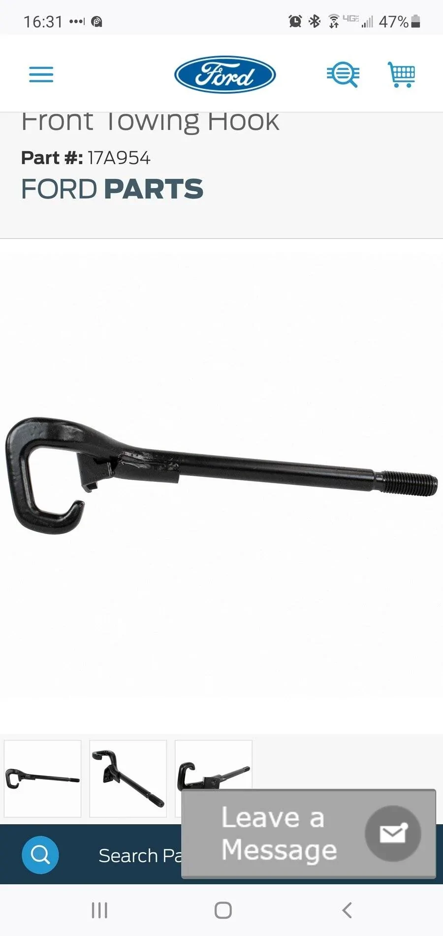

thesavo
savo
Jul 17, 2020
226
129
Albany NY
174954a for the front and 17a954b for the rear. The description for the rear is "with rear tow shooks. They look different that that one. Try seeing if Levittown gives you a full part number with these base part numbers.
Ford Bronco Sport Where should I hook a tow strap? Screenshot_20210606-163137_Firefox
